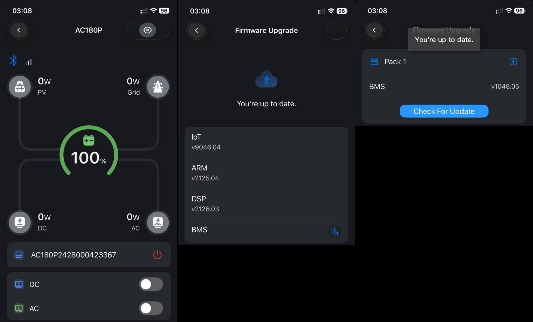

Hello @BLUETTI and @BLUETTI_CARE,
About three weeks ago, I requested the firmware and you confirmed the request, but I still haven’t received the firmware, even after filling out the form at the link. My Bluetti cannot charge below 190V. Could you please check that the data has been received? I have filled out the form again for this purpose.
Sorry for bothering you again, but I need to charge it for 2-3 hours of electricity, but the voltage won’t let me do that. Thanks for understanding.

Hello, We have pushed the new firmware to you. Did you not receive it? Thank you for your feedback, and I look forward to your response!
Hello, Thank you for the reply. At the moment, the new firmware has not yet been available. All firmware versions remain the same as I indicated in the post. I have attached screenshots.
Is it possible that this could be affected by the Bluetti account or mobile app (perhaps I need to log back in, although I think the firmware is linked to the serial number)?
I am looking forward to your reply.
