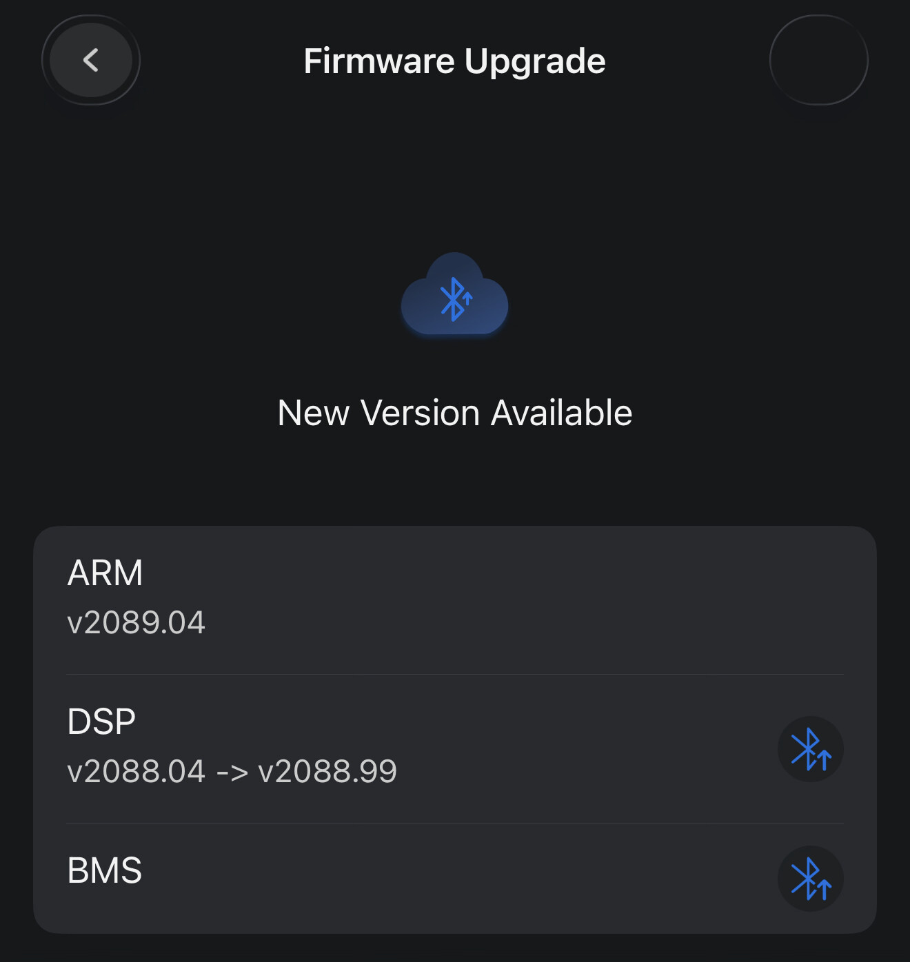

Hi @roman2017, it appears that you have already filled out the form via the link earlier. We have successfully pushed the new DSP to your device.
Please proceed with the upgrade first, and note that it only needs to be upgraded once. After the upgrade, you may still receive upgrade prompts—please ignore them. Kindly inform us once the upgrade is completed so that we can remove the upgrade notification.
After upgrading, please enable Grid Self-adaption and adjust the parameters according to your local grid voltage.
Please let us know your feedback.

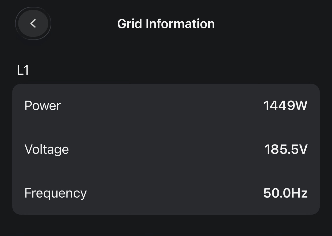

Hello, today I tried charging the battery, the voltage was 187 W, but nothing happened. I still get the E114 error. Please help me solve this problem. The charger works fine at 191 W.
AC180P2332001453199
ARM v2089.02- v2089.04
DSP v2088.04

Hi @Ihor_V, we have confirmed that the new firmware has been pushed to your device. Please note that only one upgrade is required.
It appears your upgrade has been completed successfully – you may ignore the upgrade prompt, as we will remove it shortly.
Please enable Grid Self-adaption first before testing, and we look forward to your feedback.

Hi @Innisfree, we have re-pushed the firmware for you now, please check and update it.
Please note that only one upgrade is needed. Once the upgrade is completed, please let us know and we will remove the upgrade notification to avoid any further disturbance.
After upgrading, please enable Grid Self-adaption and test if the function works properly.

Flashed the new firmware — now the station charges even when voltage is under 195 V. Thanks!
