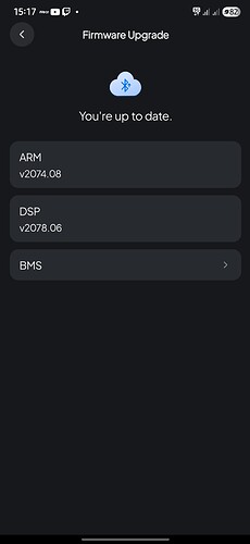

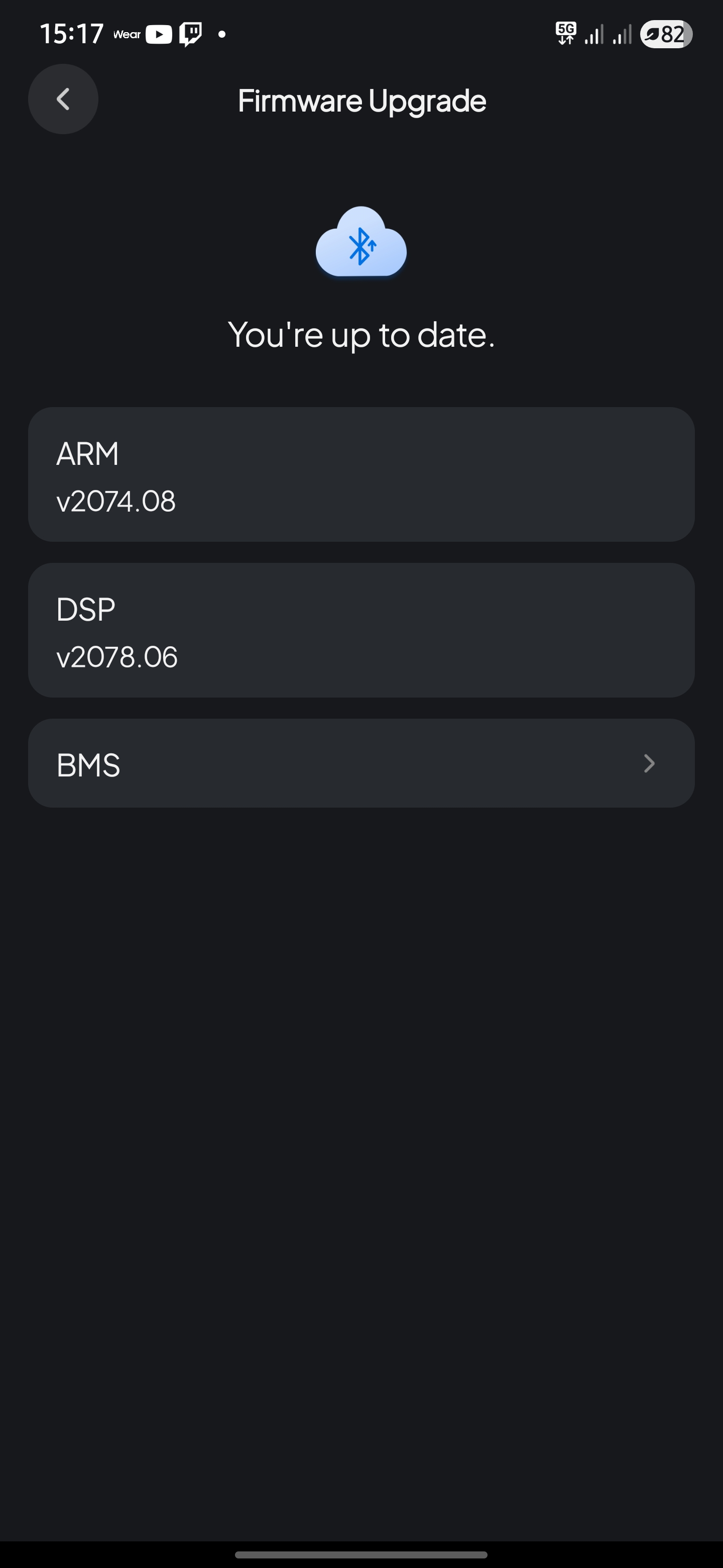

@BLUETTI_CARE @BLUETTI The update for dsp is not showing up in the app. You can add my stations so that they get a new dsp so that they can charge at 180v. Thanks in advance.
Please, I am also experiencing low voltage errors on my ac180 device.
I desperately need the new firmware fix as well.
hank you for letting us know.
Hello, we have pushed the new firmware update to you. Please enable the Grid Adaptive Mode to complete the upgrade.
