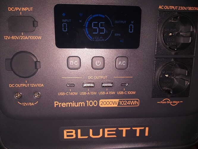

TLDR: when idle, the first ~45% drains too fast, the last ~55% drains too slow after 2 full cycles on the latest firmware; capacity is fine (945 watt-hours from 750W resistive load, no dead cells for sure).
Full story: received my unit, SOC was at 36%. Updated the firmware, then charged it to 100%.
Discharged it to zero with the heater set to 750W, 945 watt-hours on the watt-meter. Recharged it again (that’s the first full cycle).
Then I decided to test idle consumption with AC, WIFI, and the display always on, BT off. It took 85 hours to kill the unit (that’s 12 watts per hour). HOWEVER! After the first 24 hours, SOC dropped to 55% (an average of 1.87% per hour). It took 61 hours to drain the remaining 55% (0,9% per hour).
I recharged it again (that’s the second full cycle) and repeated the same process - turned on AC and left it for 24 hrs. It drained 44% just like the first time.
“Maybe those inaccurate readings occur only with no load,” I thought, and I was right. Discharged it again with a 750W heater; here are the numbers:
100 watt-hours used - SOC at 89%
200 wh - 78%
300 wh - 67%
400 wh - 56%
500 wh - 45% (I stopped here).
Still, SOC shouldn’t drop like that when idle; my AC180P and 200PL had adequate readings when I tested them the same way.

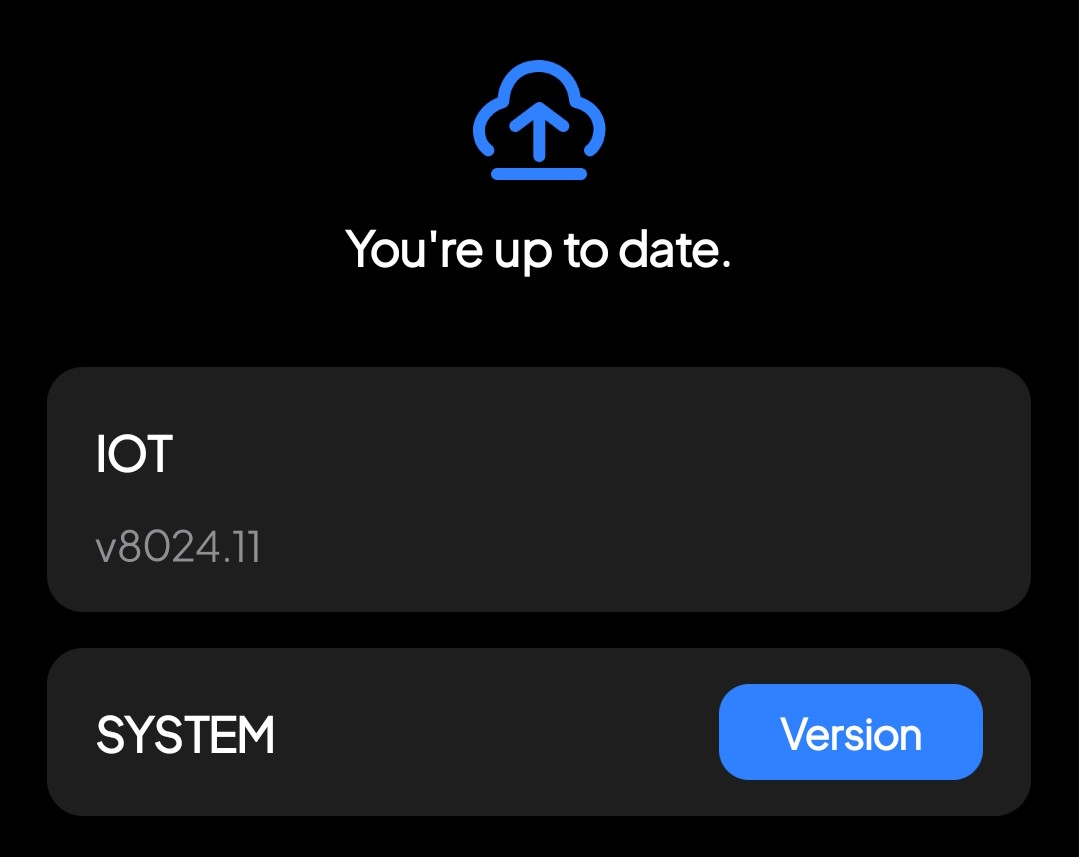

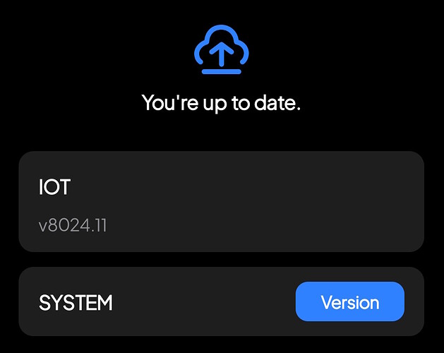

SN - PR100V22528000099445
Communication Board SN - IOT2527022603398

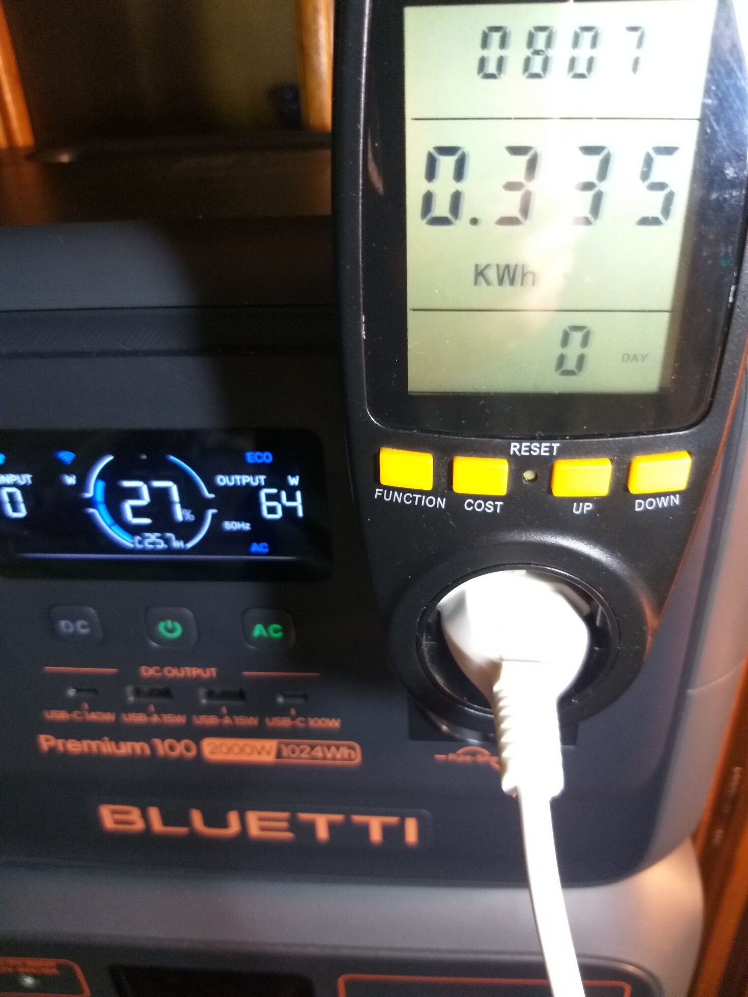

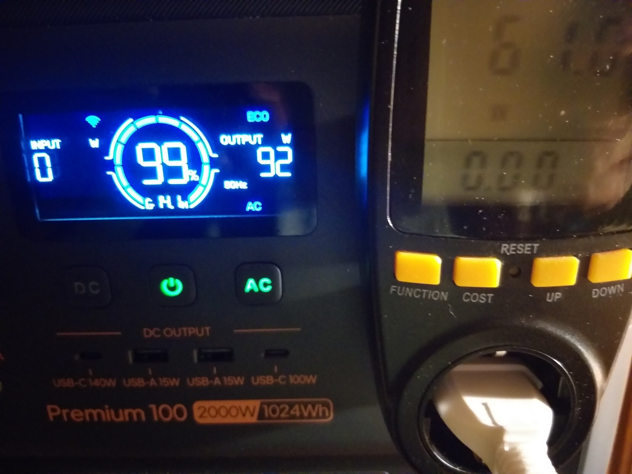

The plot thickens! Apparently, this unit has huge problems with small loads (40-60 watts).
Did more testing with an electric blanket, which has 3 modes (20-40-60 watts).
On the first pic (sry for bad quality), I plugged it in, set it to 60 watts, and was really surprised with 90 watts displayed on 100 V2 while my wattmeter had 61 watts on it. However, the time remaining (14.1 hrs) was spot on (1024/(60w +12w inverter drain)). I set the blanket to 40 watts, plugged it in through my watt meter, and left it overnight. It consumed 335 watt-hours in 8 hours (pic 2), but the SOC was at 27% which should be at 50+% (335Wh + (8*12W inverter drain) = 431Wh). Also, 100 V2 displays 40W output as 64W. It has no problem with displaying 20W output, tho.
As a cherry on top, I recorded a video with me plugging in the same electric blanket through a watt meter to my 100V2 and my AC180P, where I switched between all 3 modes (20-40-60W). AC180P has no problems displaying the true output

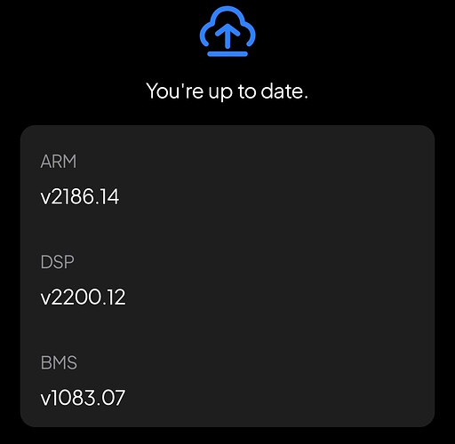

Upgrading the BMS can indeed optimize battery performance. However, we have found that your firmware is already the latest version, so we cannot push a new firmware update to you.

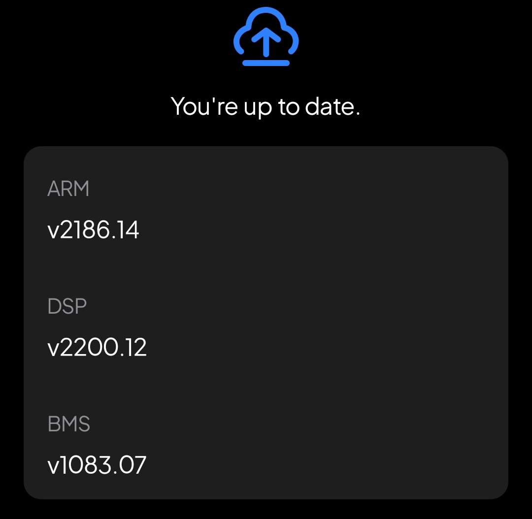

  1. Powerful summary. It’s almost like I mentioned 3 times that I had the latest firmware + provided screenshots.
  2. I didn’t ask to help me with updating to the latest version; I can do it myself if there is one. The problem is, there is none.

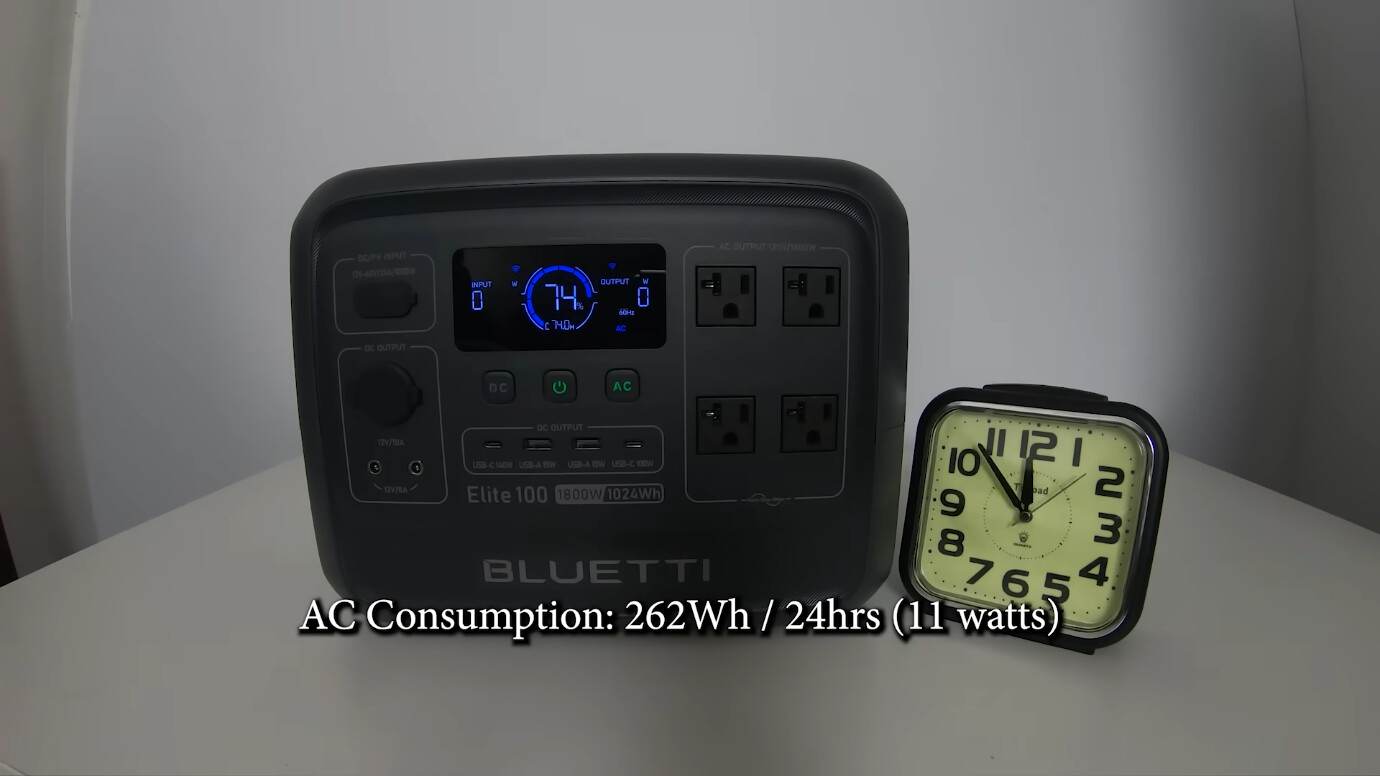

Btw, here’s the screenshot of HOBOTECH’s review of the Elite 100 unit (link with a timestamp https://youtu.be/K1cL36-x41U?si=tXUBF9evm-_hkiaW&t=362) where he left the inverter running for 12 hrs and it consumed 131Wh (he just multiplied it by 2 to give a 24hr estimate).
So it consumed 131Wh out of 1024Wh, but the SOC dropped to 74% :joy:

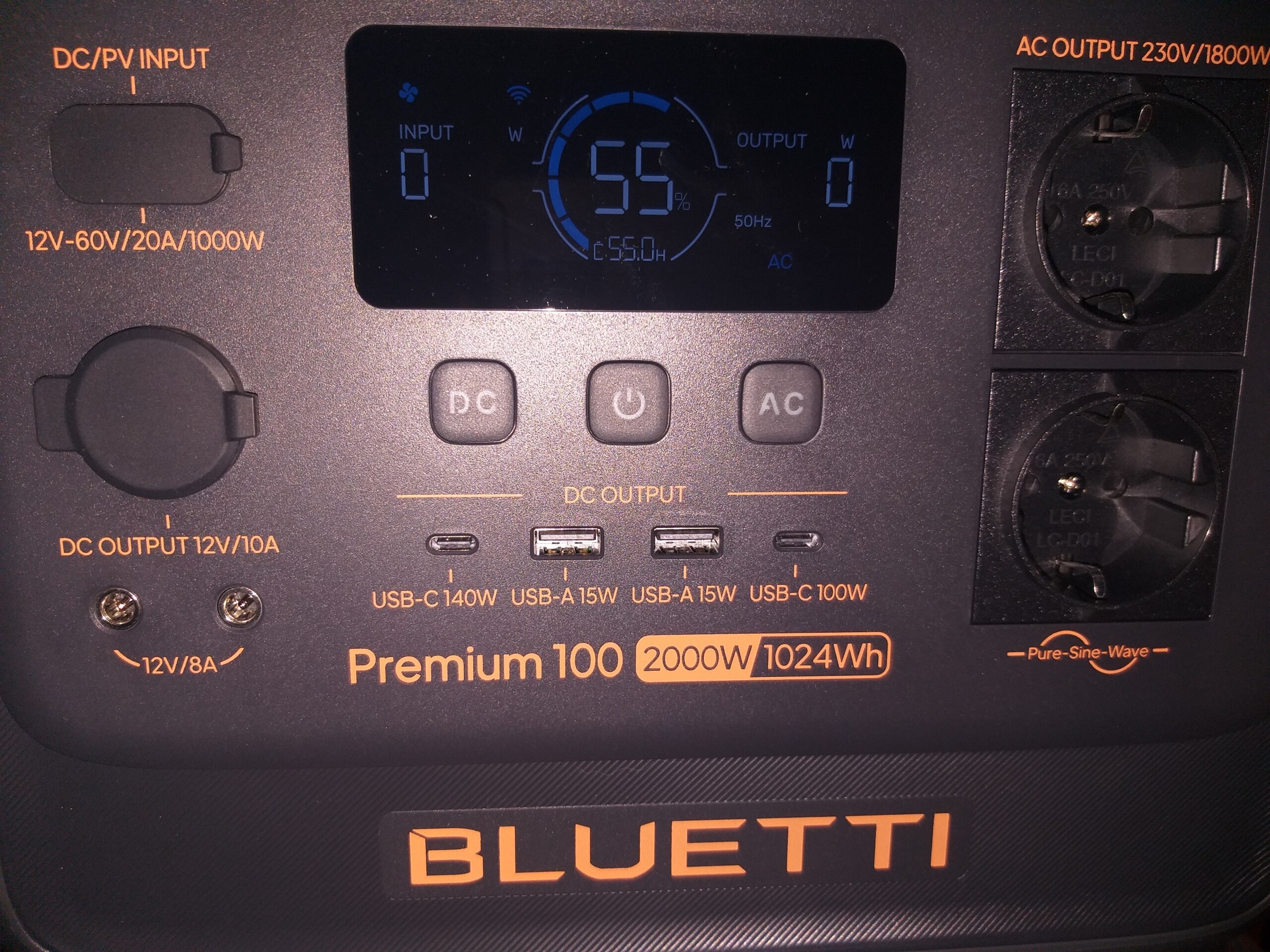

So I tested the “new” firmware, which was an ARM and DSP update (there was no new BMS version included).
Results are: Nothing. It changed nothing.
The SOC was at 56% after 24 hours of AC discharge, just as I mentioned in the original post. After 9 hours of discharge, SOC was at 80%.
The unit still has huge issues with small loads (40-120 Watts) and displays them incorrectly.
In the video above, I connected my double bed electric blanket (2x60watts), which is basically a resistive load, and switched between modes.
The unit still has no issues with heavier resistive loads, tho, like a 750W-1250W heater, as seen in the photos.
