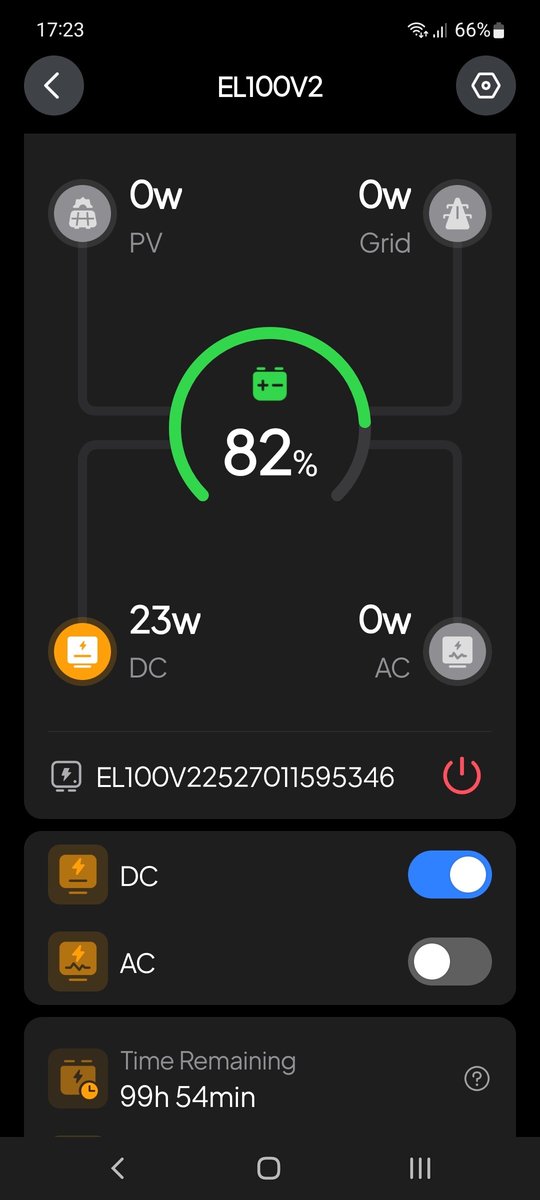

Hi @BLUETTI_CARE. Why is the remaining time displayed incorrectly even with a low DC output load? It’s impossible for the remaining time to be 99 hours 54 minutes with a 23W load.
EL100V22527011595346
ARM v2186.15
DSP v2200.14
BMS v1083.07
