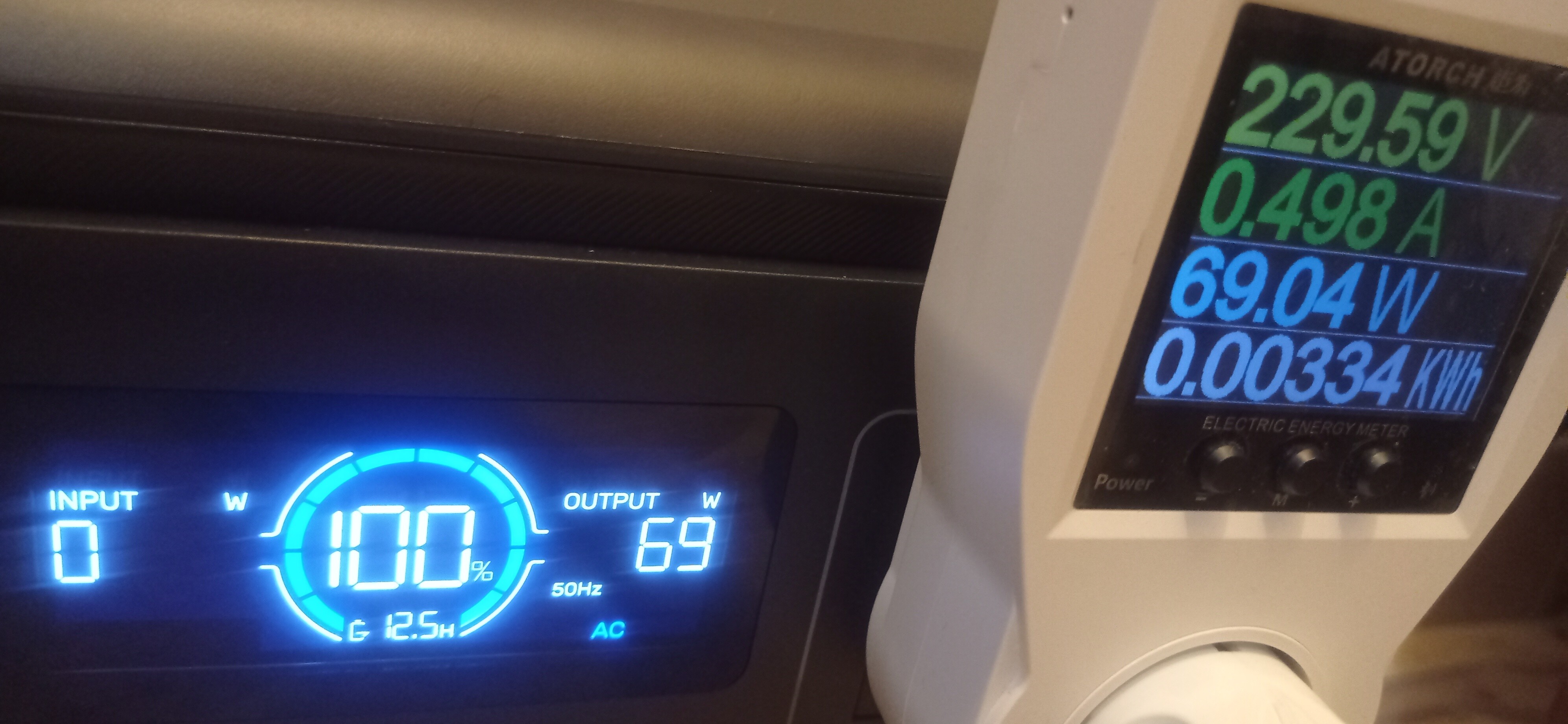

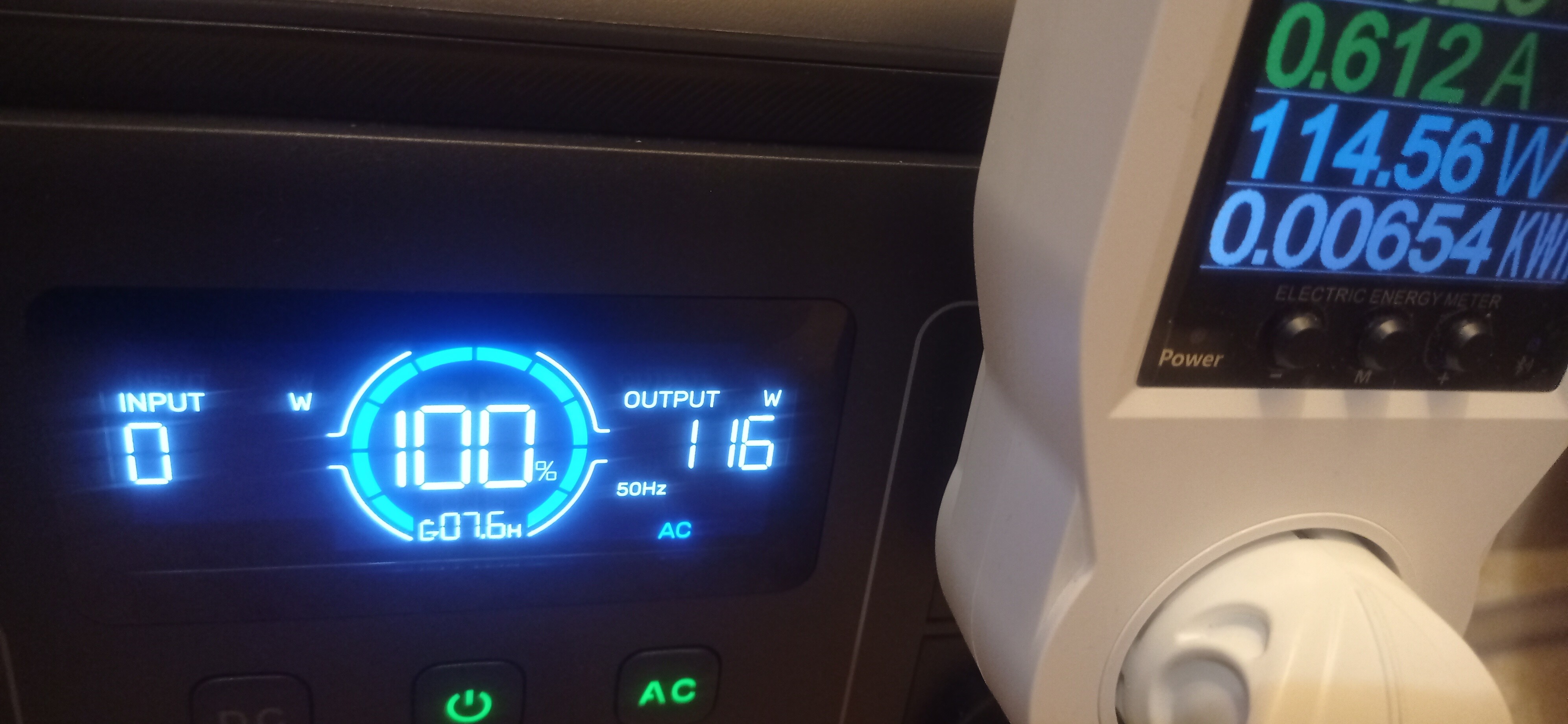

  1. The charging station display itself says “WATT,” which means it should only display ACTIVE power, which is measured in WATTS. - Is that clear?
  2. Look at two photos with the same load on two stations: an AC180 and an Elite 100V2. The load is LED lighting (LED bulbs only). The difference is obvious. - Make it like the AC180!!!

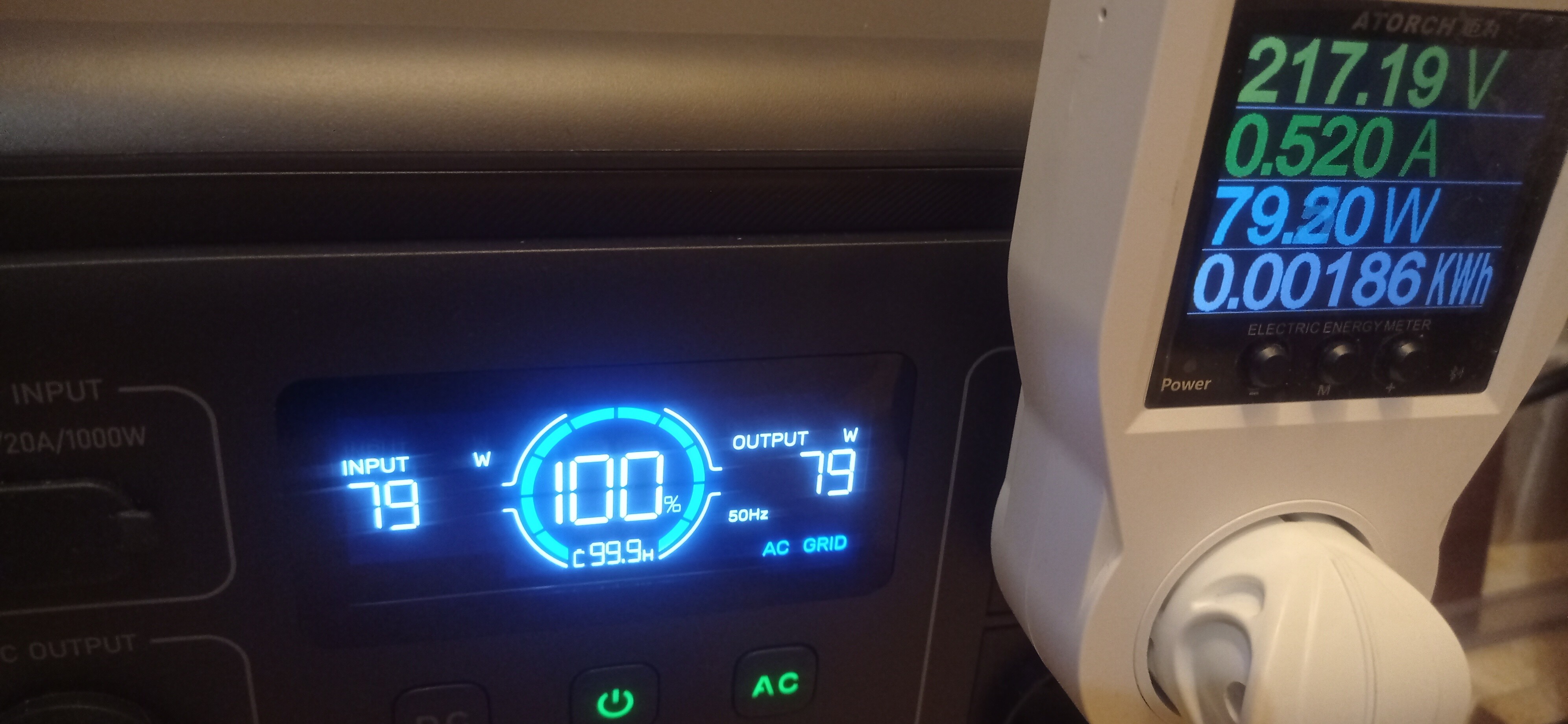

Hi. @BLUETTI_CARE The new firmware arrived. I installed it. Everything has improved. The power consumption figures correspond to the actual values, and the photos show this. If I notice any comments, I’ll let you know. Thank you for your cooperation.
