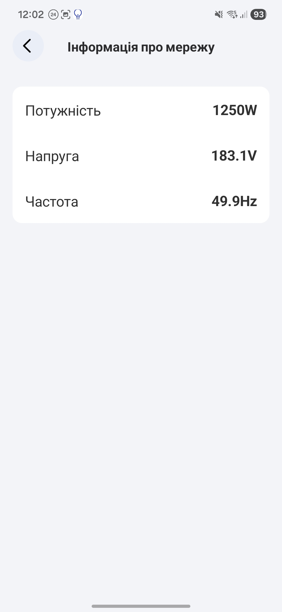

Hi @BLUETTI_CARE
Kindly be advised that I got the update for AC2P yesterday. And it helped. The device started charging at low voltage `184-185V. Thank you!

Hi @denzn, We have consulted the Technical Department regarding this matter, and they informed us that your firmware is already up to date—hence, no further updates can be pushed.
Additionally, please note that the low-voltage protection mechanism is triggered when the voltage drops to 70% of the rated voltage. During AC charging, please click on the Grid Input icon to check the actual input voltage. If it is lower than 70% of the rated voltage, charging will not be possible.
