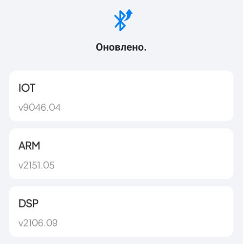

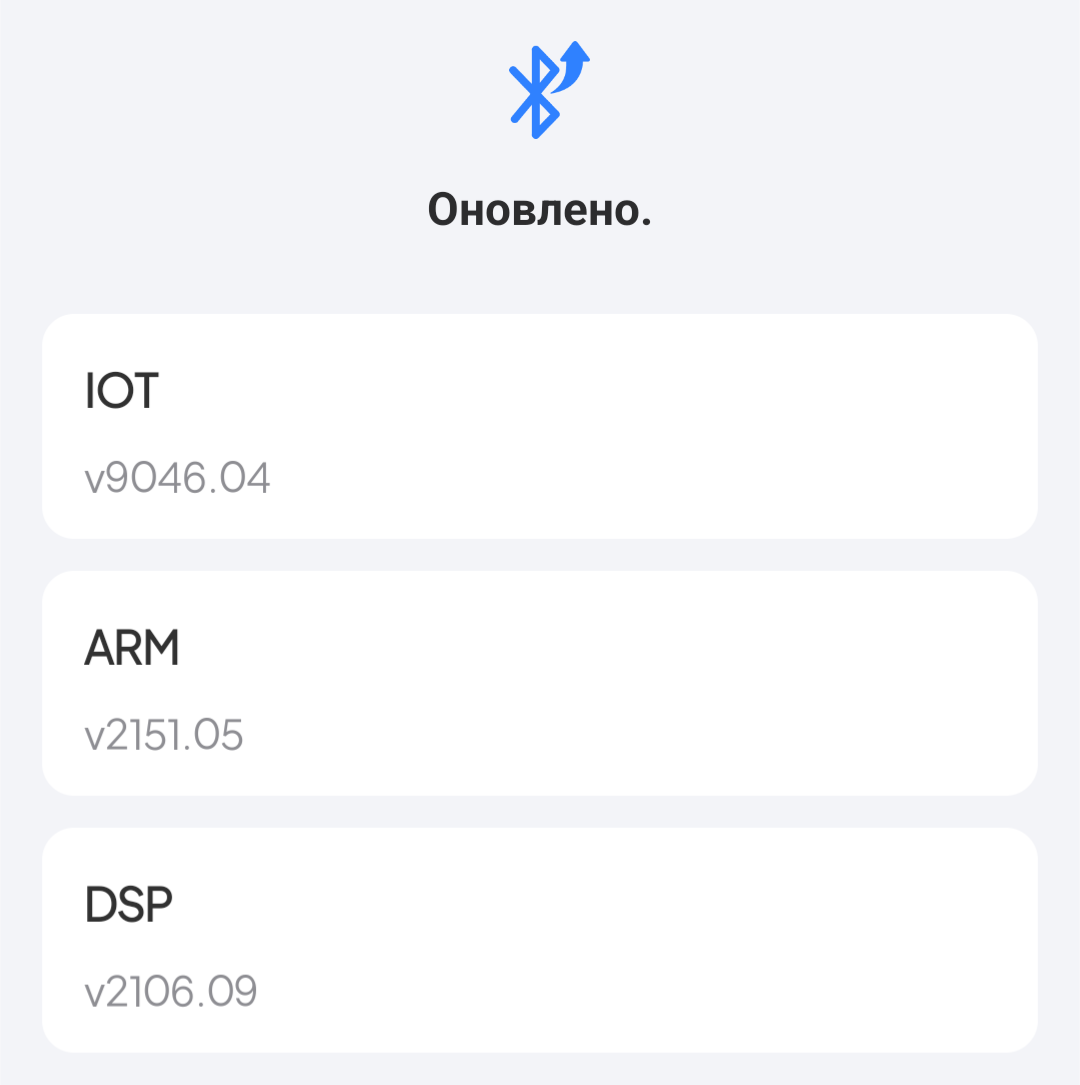

Hi @BLUETTI_CARE :grinning:
I have the same problem on my AC70 with low grid voltage (190V or less).
Both silent charging mode and grid self-adaptation does not help.
SN is AC702438000571913
IOT v9046.04
ARM v2151.05
DSP v2106.09
Can you send better firmware for this problem?

Hi @Tartak, We consulted our technical team about this matter, and they informed us that your firmware is already up to date—hence no update was pushed.
We’ve recommended that the R&D department develop a new firmware to enable weak grid charging for the AC70. We hope to get a positive outcome soon.
