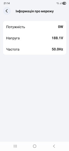

Could you please click on the AC Input icon to check the actual input voltage?
Please enable Grid Self-adaption mode—does this help resolve the issue?

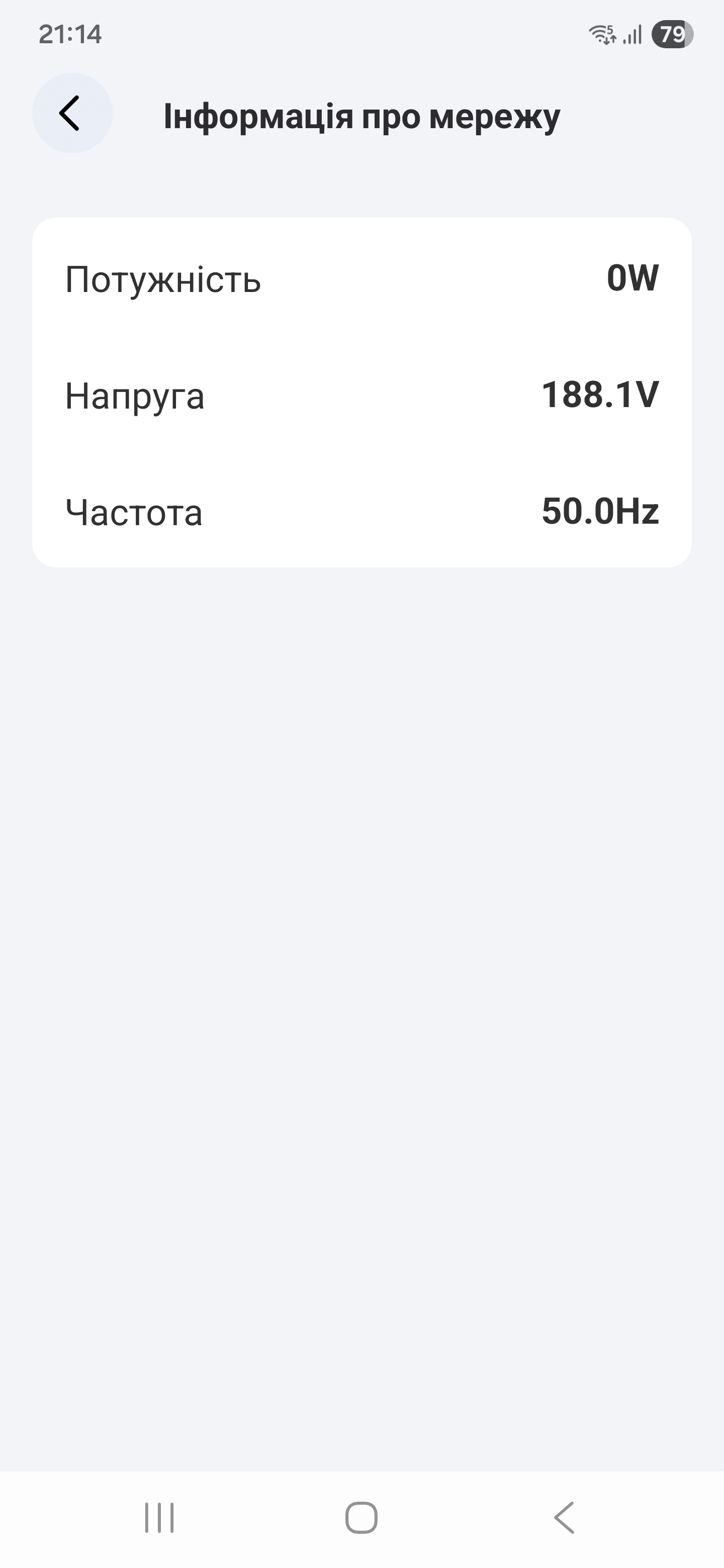

At voltages between 180 and 188, AC180P does not charge.
Grid Self-adaptation mode did not solve the problem.

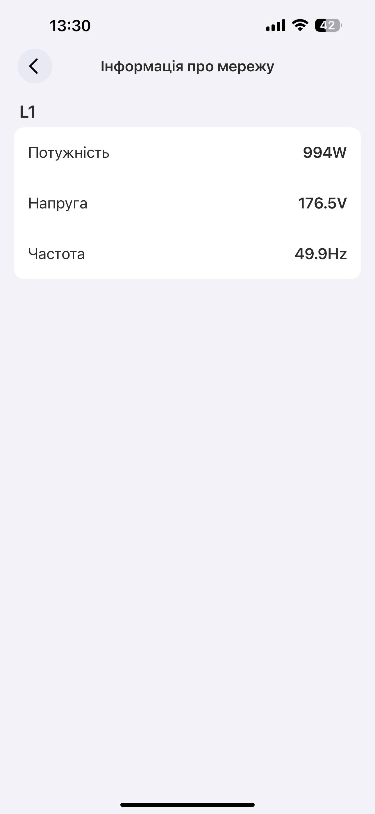

Hello, could u help me with low grid voltage? Send me a firmware update, please. Sometimes, for me, it’s from 170-180v, and my device does not charge.

Hi @BLUETTI_CARE. Silent charging mode is enabled, ambient temperature is normal, the app showed error E114 “low voltage”, but when the voltage in the socket increases to 190, everything works normally.
