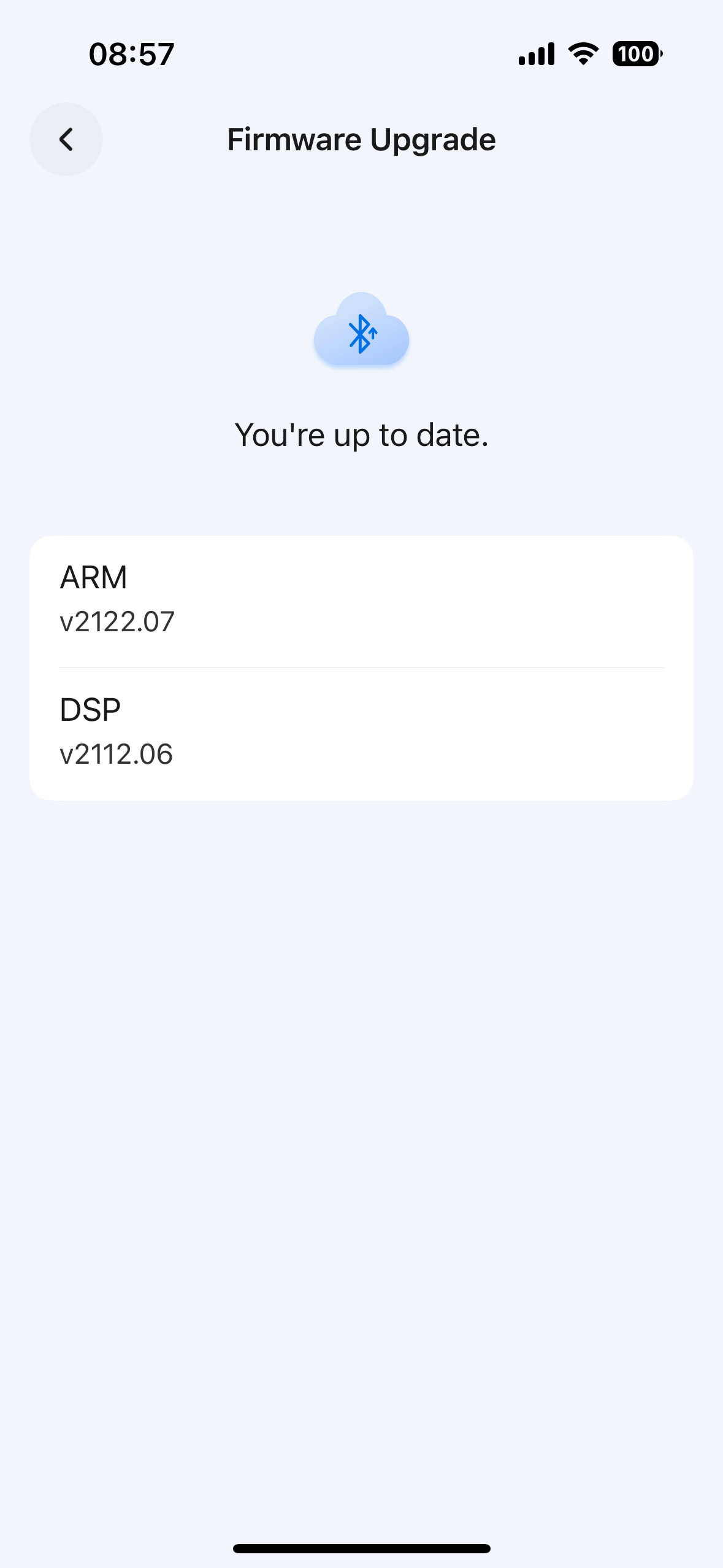

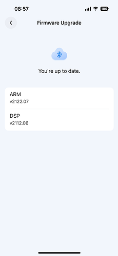

Low grid voltage error on AC180P
Thanks a lot, I got update and it really help in our situation.

Hi @Jeans8787, we would like to confirm whether you have enabled Grid Self-adaption and Silent Charging Mode. Have these functions worked effectively for you?
Hi @Slytusk, that is great, we are glad to hear that!
Thank you for letting us know!
Thank you very much my friend! Everything works after updating.
