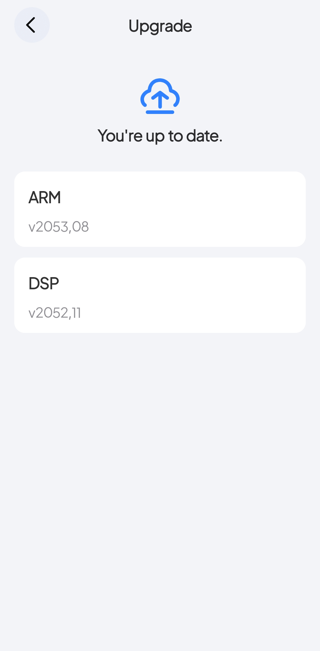

Hi,
I’m on ARM v2053,08 and DSP v2052,11.

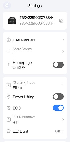

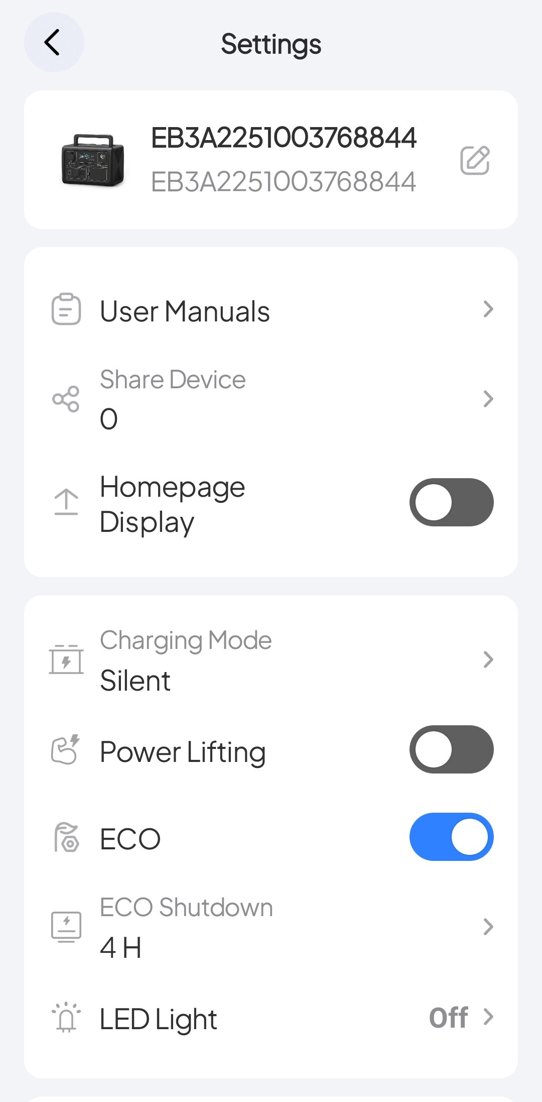

Hi, please check if the latest version of firmware is updated on my device
EB3A2251003768844
ARM v2053.08
DSP v2052.11
Thank you
Hi @pilovali, We have located your email records and reviewed the app screenshot you provided. It appears that you have enabled ECO Mode, which is likely the reason why your EB3A is shutting down automatically.
Please try disabling ECO Mode and test again—this should resolve the issue.
The ECO mode is an energy-saving feature that automatically turns off AC or DC output when there is no load or a small load to conserve power. Customers can enable or disable ECO mode through the app.
Hi @and93, We found that your firmware is the latest one.
