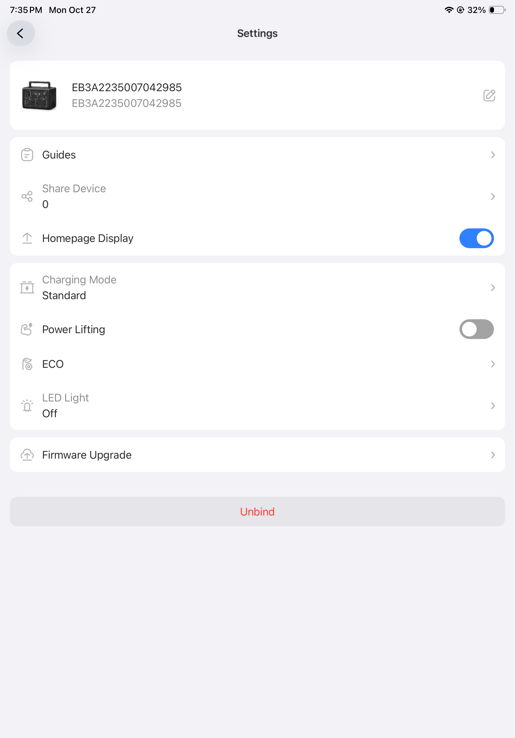

Serial number
EB3А2235007042985
Please send me the updated firmware to fix it

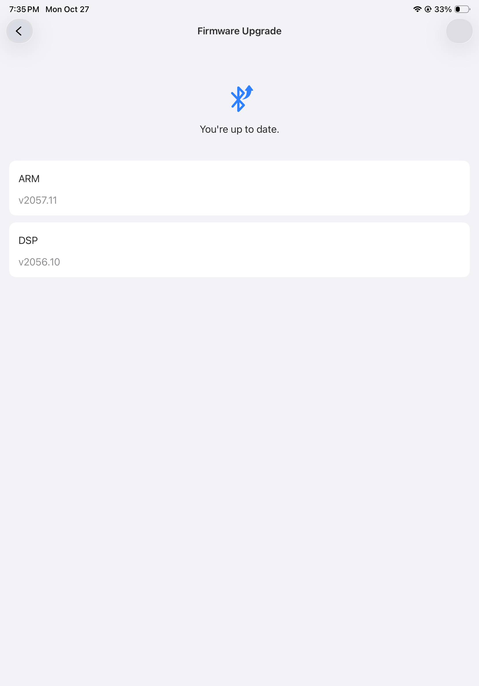

It’s been 2 days, and I still don’t see any update, please check.

The update didn’t get through to me.
Please be quick,

As you can see, it said up to date,
I didn’t get to update it at all.
Hi @Bigbellypigy, I am sorry for the inconvenience.
We have pushed it again. Please try to upgrade it now.
We expect your feedback.
