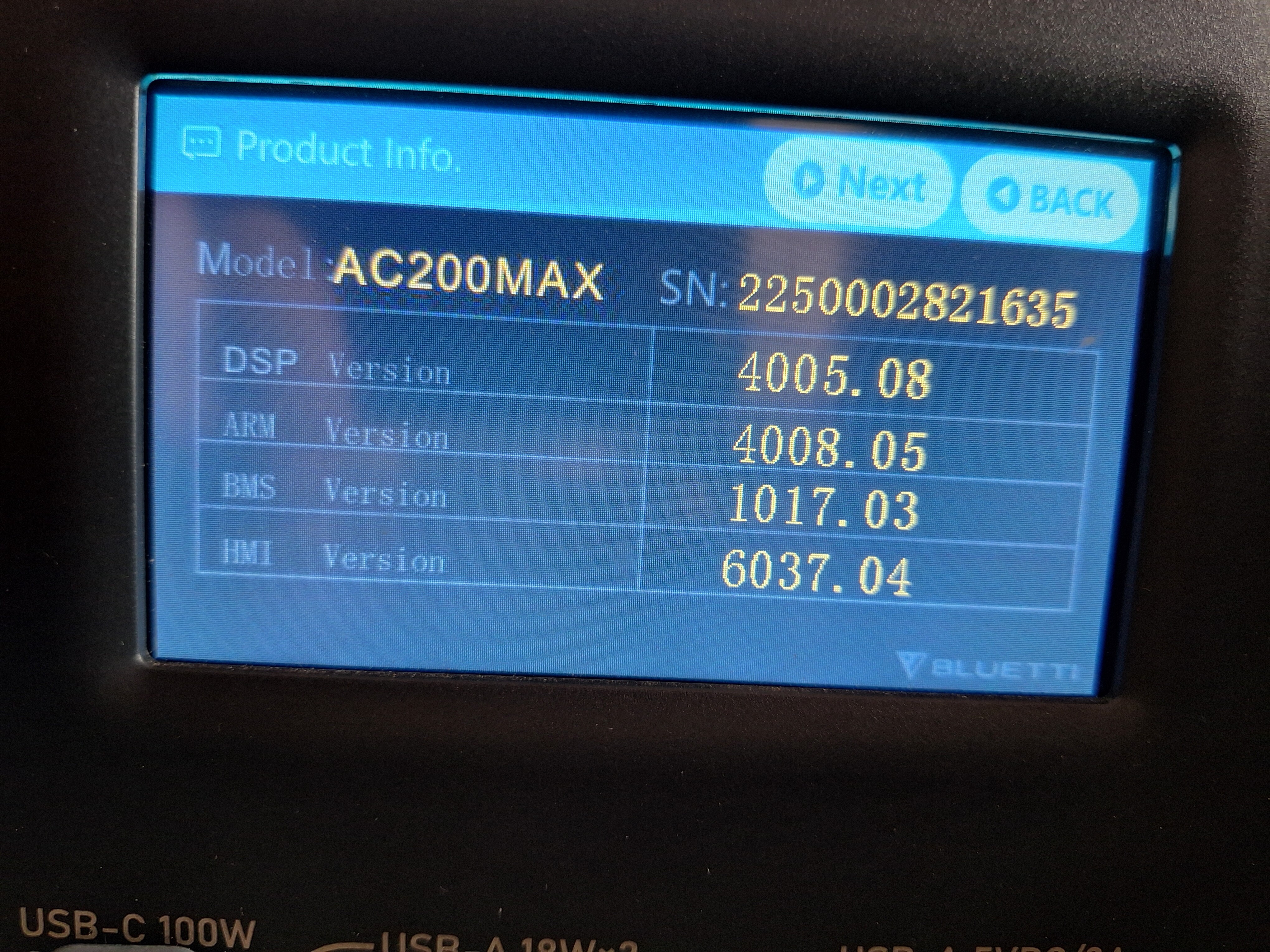

@BLUETTI_CARE Hi. I hope you can also help me fix the same problem. I can’t controle de dc and ac on my Bluetti 200Max.
Hi @JohnD69, We have requested to push the latest ARM firmware for you.
Our IT department will push the firmware to your unit in 1 working day.
Please let us know if it does help.
@BLUETTI_CARE : Yes yes yes! I love it when things just works as it should. The upgrade was installed succesfully. My Bluetti AC200 Max works great.
