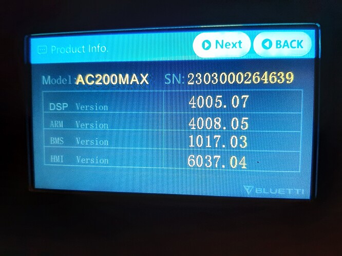

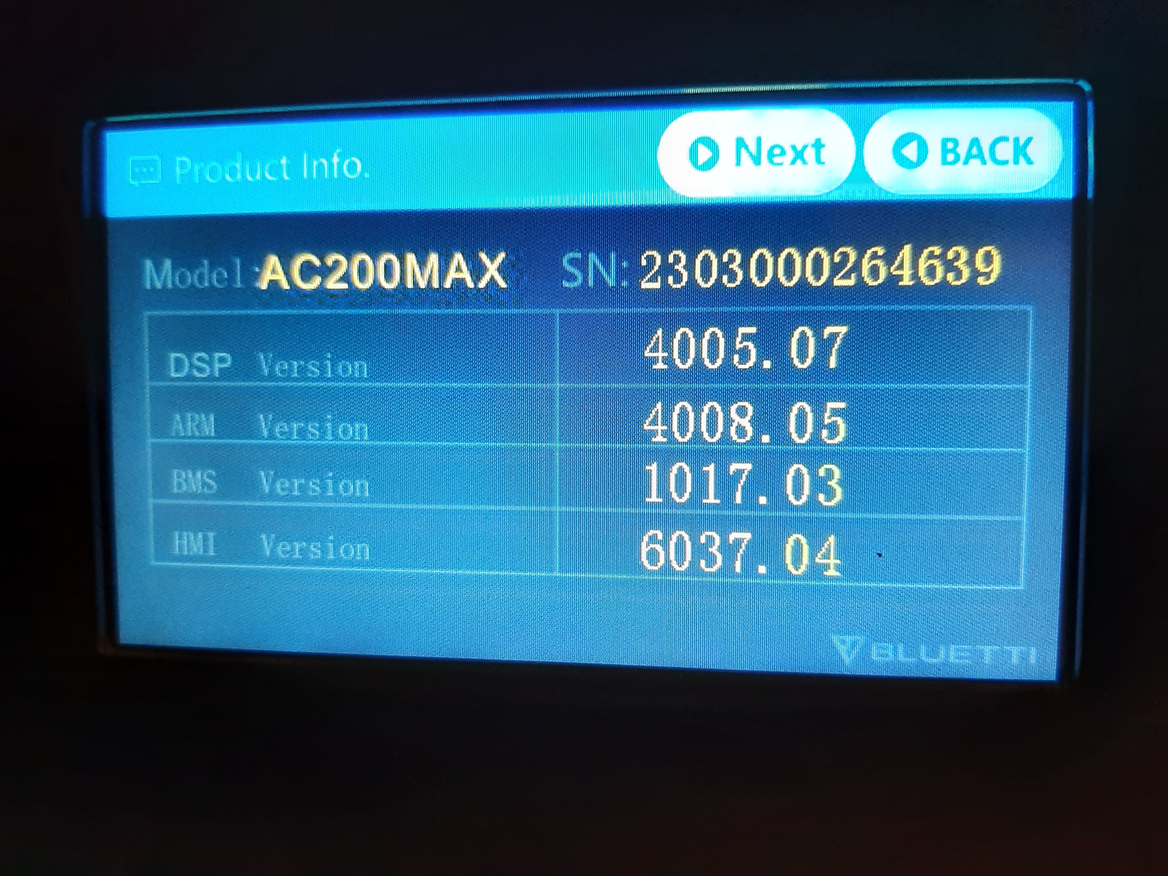

Hello, my AC 200 Max is having a similar problem. It was working fine yesterday, but today it is not. It turns on, device accepts charge from the mains. I push the ac on button and the lcd beeps, so it registers my touch, but the acon circle remains gray. Same thing with dc. i turned the unit off, waited a few minutes, turned it back on. Same thing occurs. I generally never use the Bluetooth feature, but I wanted to test it with the application. I went under the settings and when I push the button for Bluetooth it does the same thing as for the AC and DC. The lcd beeps so it seems to register my touch, but the bluetooth does not turn on. Should I attempt the factory reset? @BLUETTI_CARE
Hi @Metallicat.420, It seems that your AC200MAX can’t turn on AC/DC output via the AC/DC power buttons, is that correct? We have a new firmware to fix this issue.
Please provide the SN number of your AC200MAX and its current firmware version, and we will push the new firmware for you.
Hello thank you, yes that is exactly the problem. I am attempting to upload an image with this information now.
Hi @Metallicat.420, Thank you for getting back to us so quickly.
Now I have applied to upgrade your system to our IT department. They will push the latest version of firmware to your unit in 24 hours.
