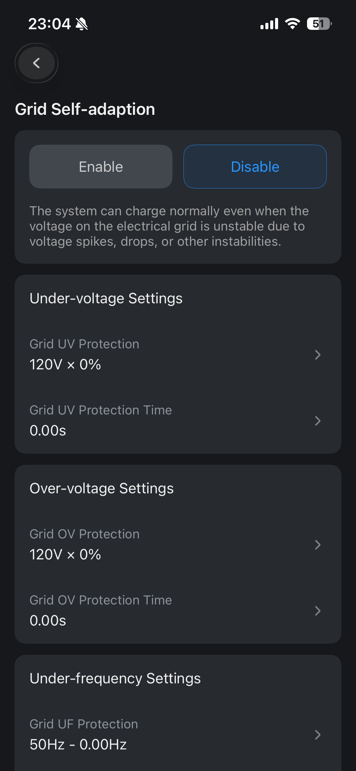

I also have the same issue as @DmytroDubinin whereby grid self adaptation has been changed to 120 volts which is not correct for the UK.

I updated the device, thank you. But I don’t see where to turn on this mode. There are also changes in grid self-adaption. Previously, it was 230 volts, but now it is 120 volts, you need to check for 230 volts, since in Ukraine it is 230 volts. What should I do and how do I find the section where to turn on saving the state before turning it off?
The percentage settings are not saved at all. As soon as I change the values, they immediately revert back and do not remain applied.
Thank you

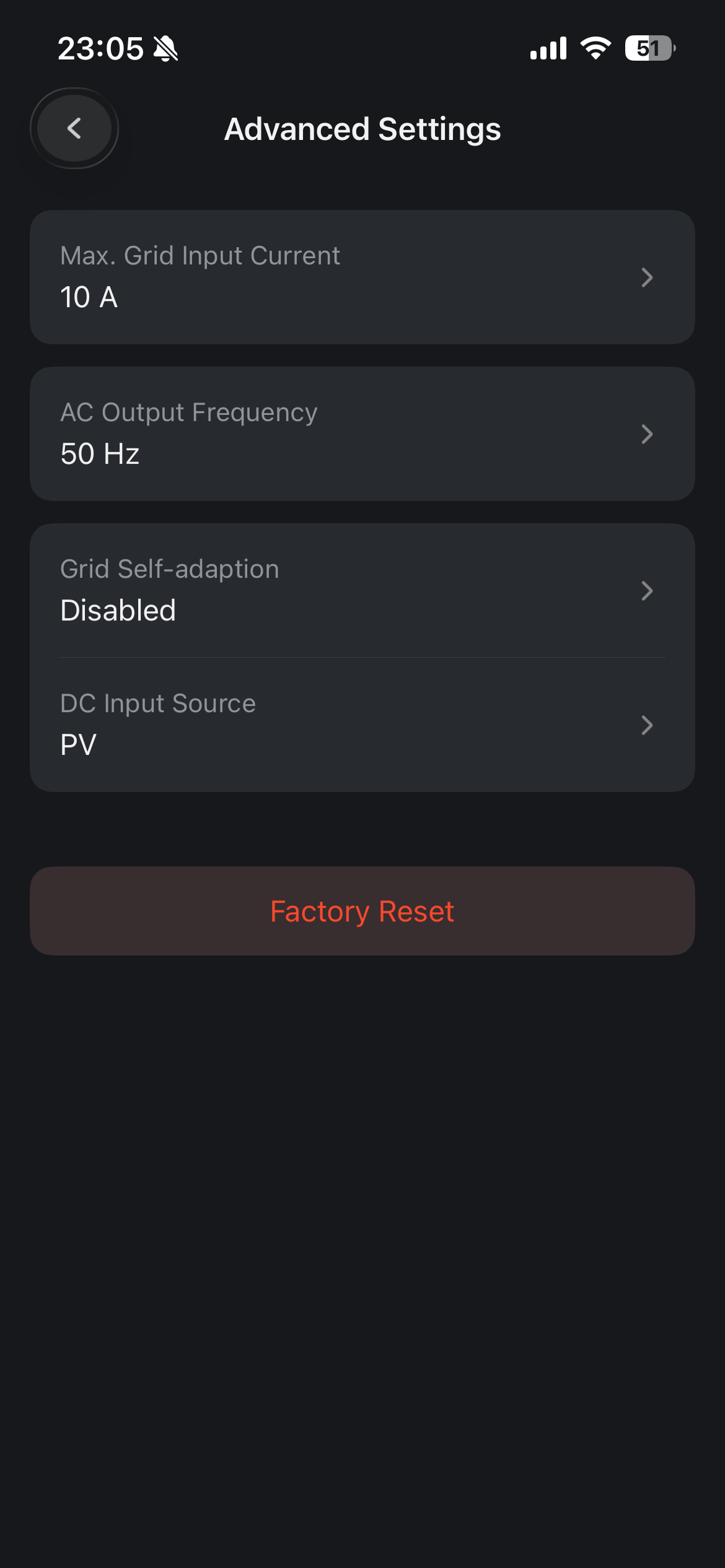

However, in grid self-adaption mode, the unit now shows 120V instead of 230V.
Before the firmware update, self-adaption mode also worked correctly at 230V.
Additionally, I still cannot find any visible System Switch Recovery (SSR) toggle in the settings. Could you please confirm whether this feature is automatically enabled or where it should appear?
Could you please clarify:
• Why self-adaption mode now displays 120V?
• Whether this is a firmware regional configuration issue?
• How to ensure correct 230V operation in all modes?

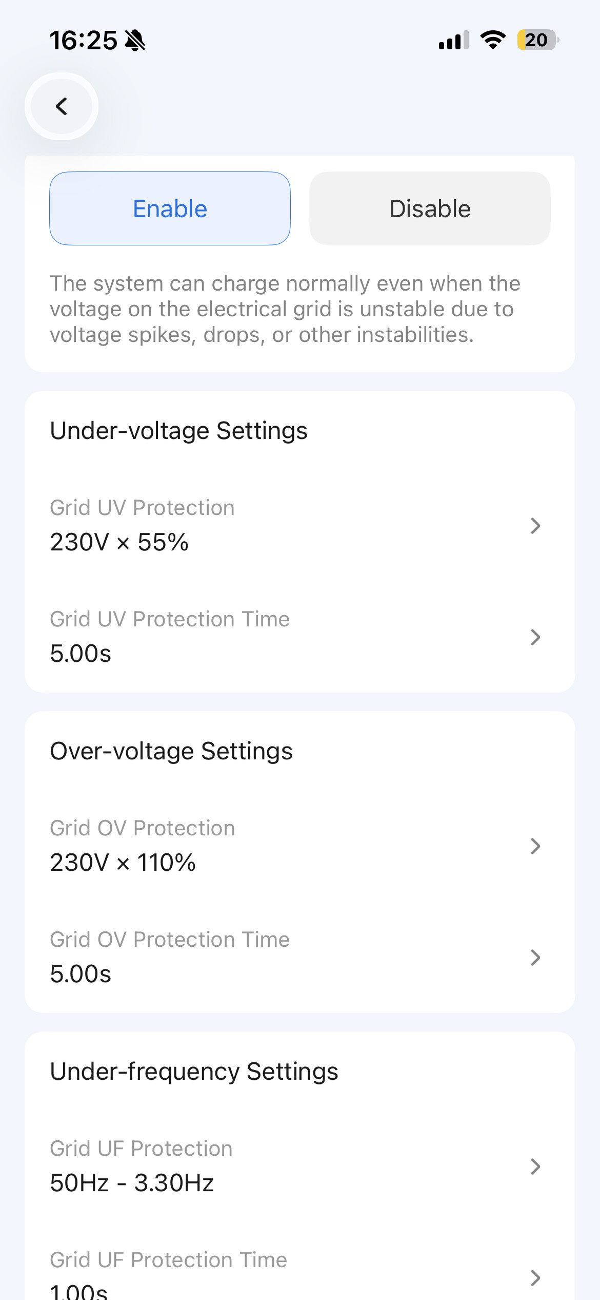

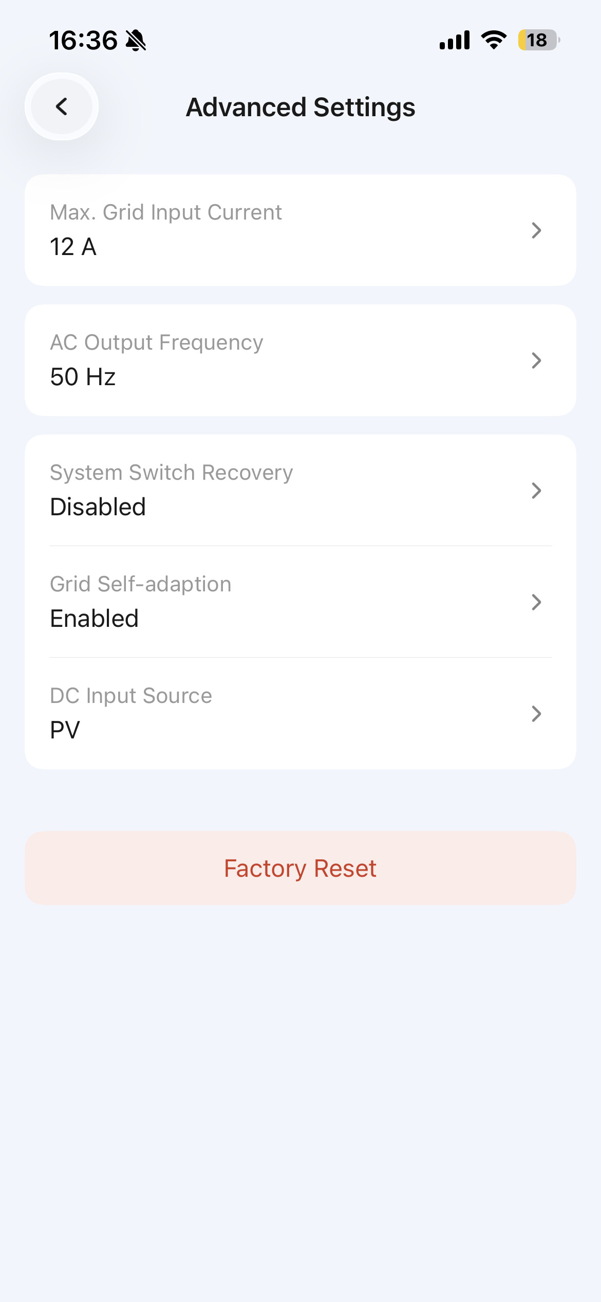

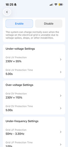

Thank you for the latest firmware update.
The grid self-adaption mode is now working correctly at 230V — thank you for resolving this issue. I have attached photos for confirmation.

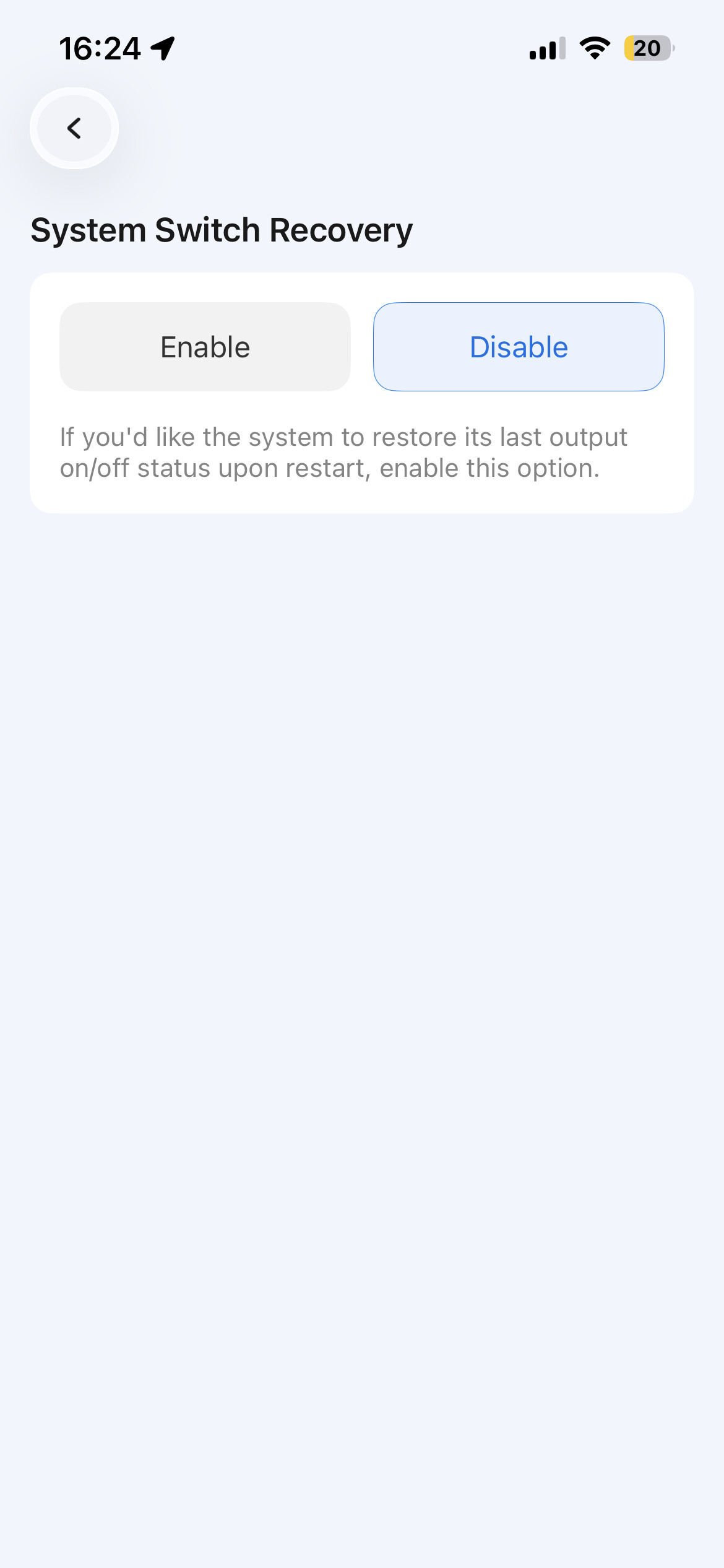

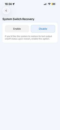

The “System Switch Recovery” option is now visible in the settings. However, I am unable to enable it.
As shown in the attached screenshot:
  • The “Enable” button is inactive (greyed out).
  • The “Disable” button is highlighted.
  • After entering the password (888888), the status does not change and remains disabled.
It appears that the function is present in the interface but cannot be activated.

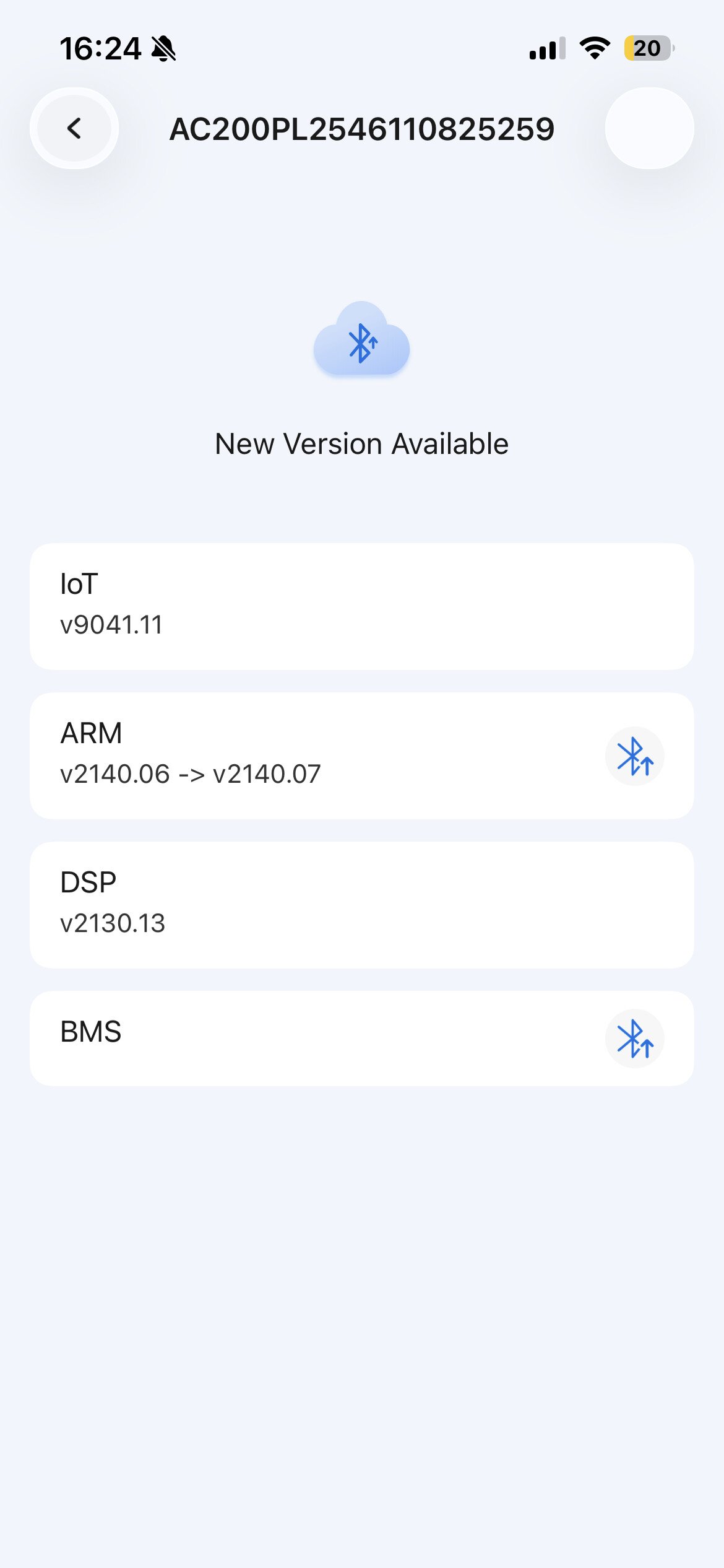

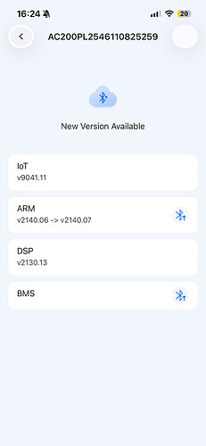

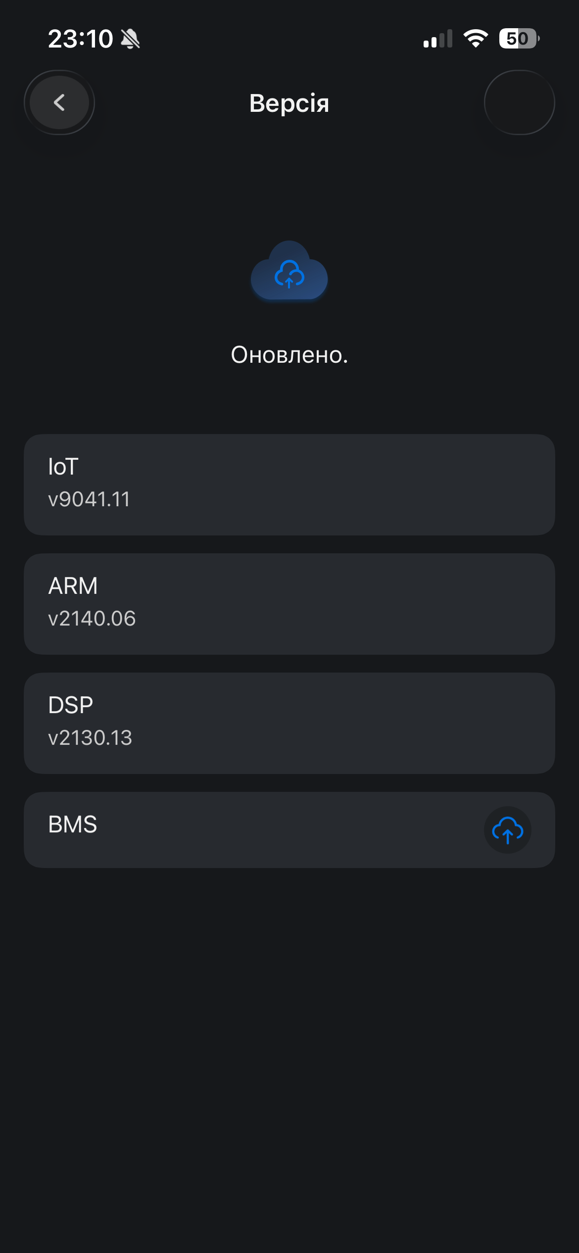

Additionally, the BLUETTI App still shows a firmware update available even though the update process was completed successfully. This may indicate that the firmware was not fully synchronized.
Please advise:
  1. Why the SSR function cannot be enabled.
  2. Whether an additional firmware push is required.
  3. Why the app still indicates a pending update.
I look forward to your technical guidance.

Hi @DmytroDubinin, thank you for your feedback. It seems the issue still persists.
We have already reported it to the R&D department for discussion and analysis, and we will contact you once we have an update.
