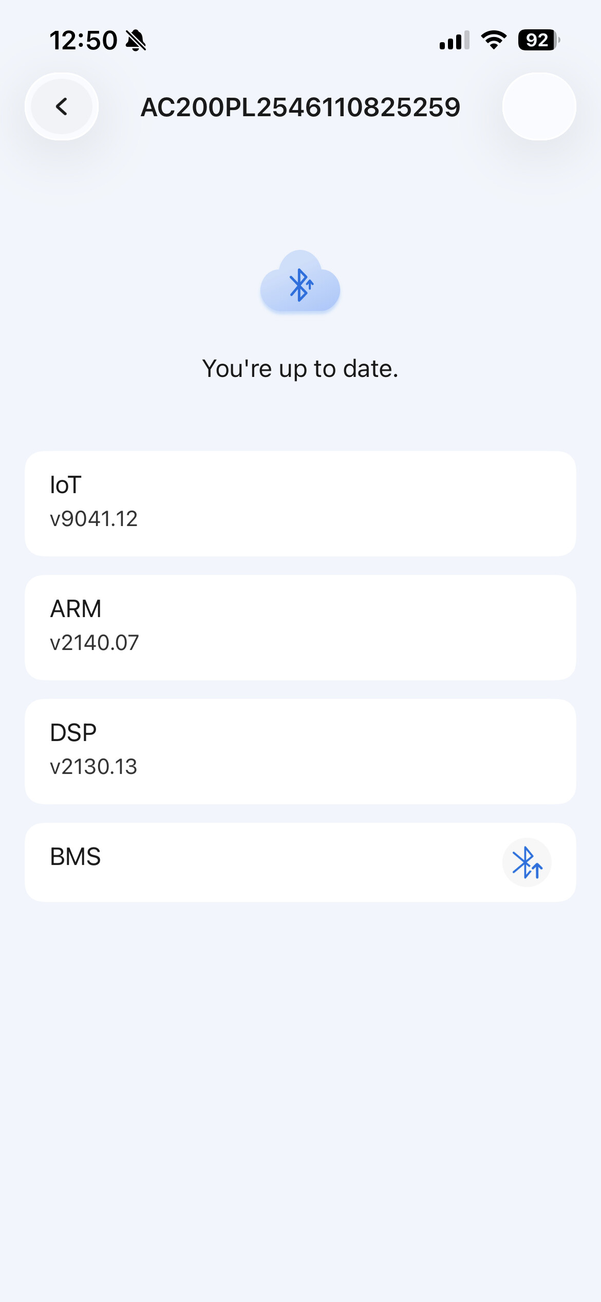

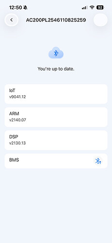

Dear @BLUETTI_CARE
Thank you for pushing the latest ARM and IOT firmware updates.
I have successfully updated both firmware versions. The previous issue with the update notification has now been resolved.
However, the “System Switch Recovery” (last state memory) function still cannot be enabled. After entering the password, the toggle does not switch to “Enable.”
I have tried all recommended steps:
  • Rebooting the device
  • Reinstalling and restarting the app
  • Unbinding and rebinding the device
  • Resetting the unit to factory settings
Unfortunately, nothing has resolved this issue.
I am attaching screenshots confirming the firmware versions, as well as a video demonstrating that the function cannot be activated.
Thank you again for your support. I sincerely look forward to resolving the remaining issue with the System Switch Recovery function.
Best regards,
Dmytro
