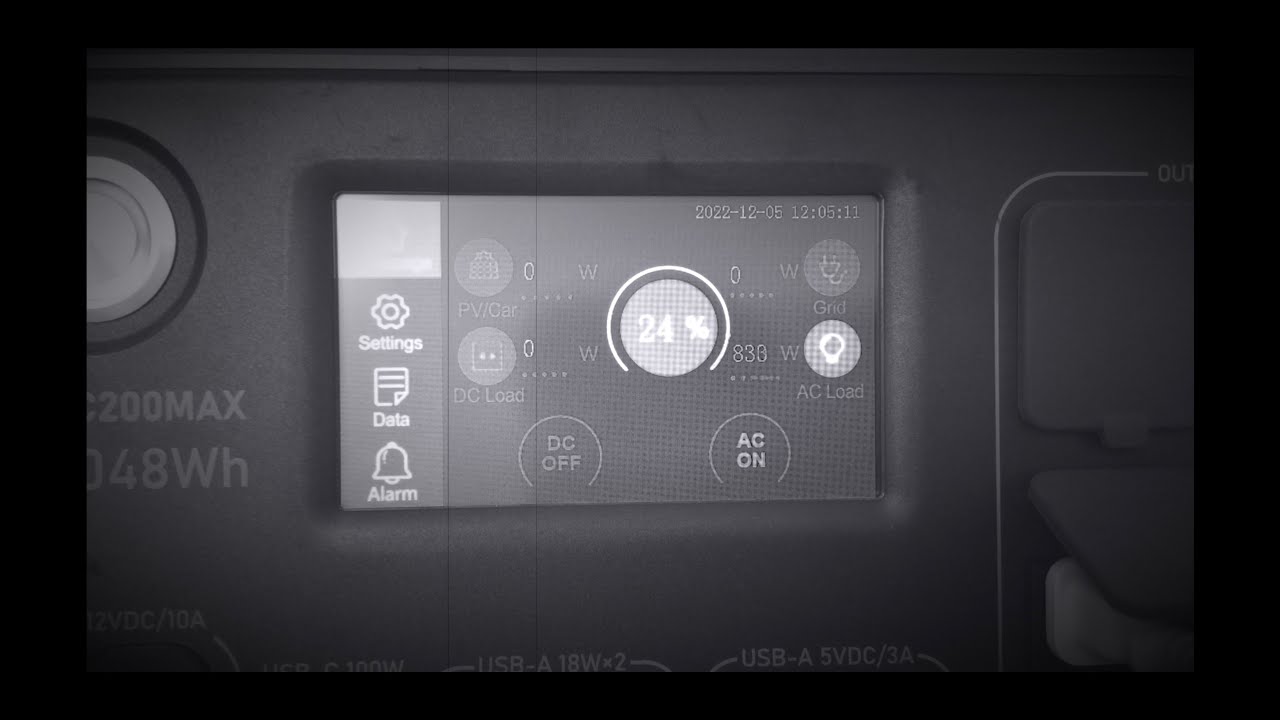

I came home one day to see that my b230 was fully charged but my ac200max was off. I pressed the power button and the green light turns on, but other than that no activity. LCD refuses to work even when I unplug and try to isolate an issue.

did you by chance leave your AC200 Max on until the battery ran out and left it in that state? Not saying it should not work after that, just curious because that seems to be a common occurrance in these circumstances.
