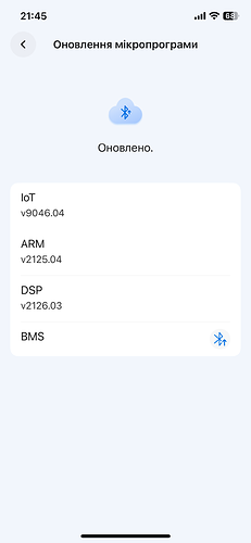

My Bluetti AC180P shuts down randomly when used as a UPS. May I ask for a firmware update to be pushed to my device? Its details are as follows:
Location: Ukraine
Device: Bluetti AC180P
SN:2335000920872
Current Firmware: ARM v2089.04, DSP v2088.03, BMS v1039.01
Thank you in advance,
Liuda

I have applied to upgrade your system to our IT department, and they will complete the push within 24 hours.

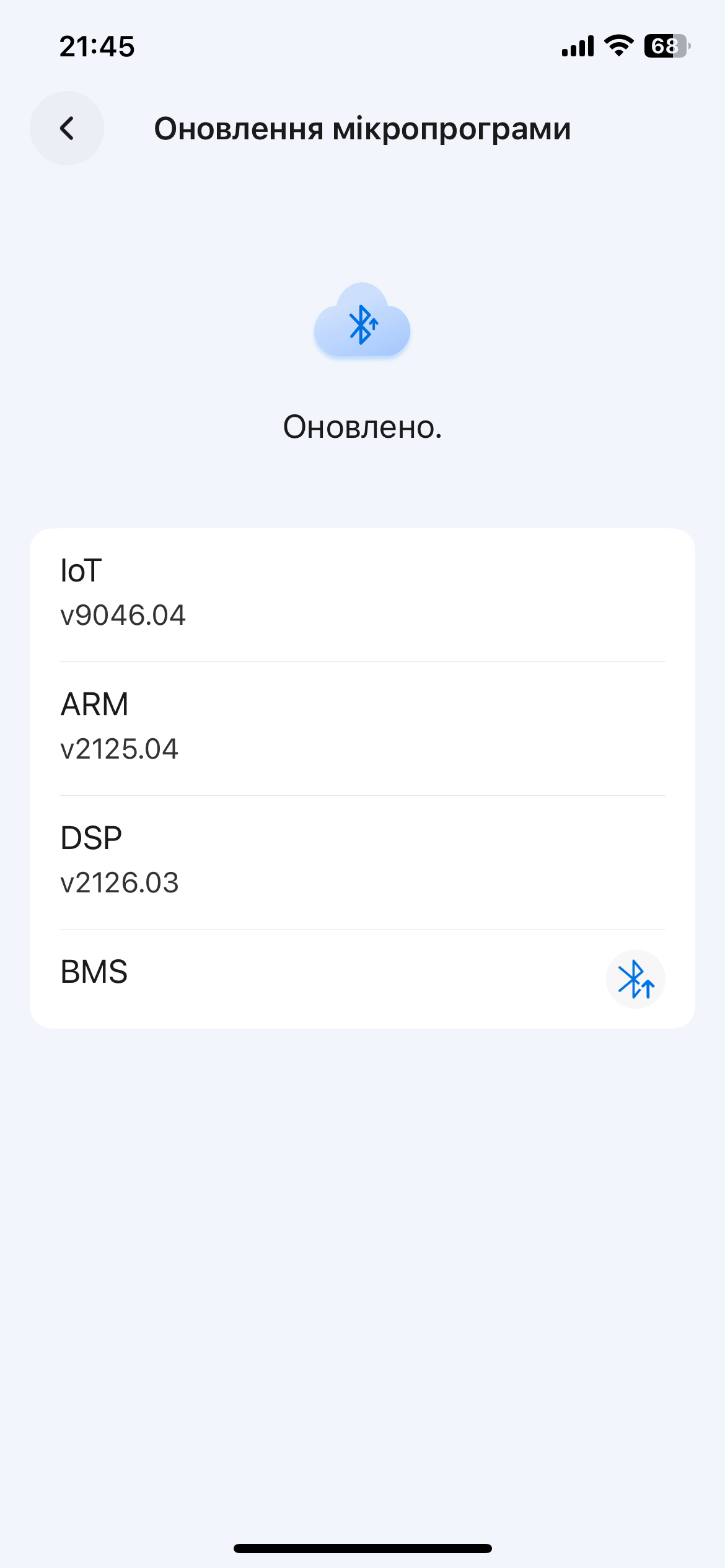

Thank you so much for arranging the push. Your IT Dept exceeded expectations - the firmware was available almost immediately after your reply :) It has already been installed and is being tested now. So far, everything appears to be working well (touch wood!). Many thanks again, and have a great day :)
