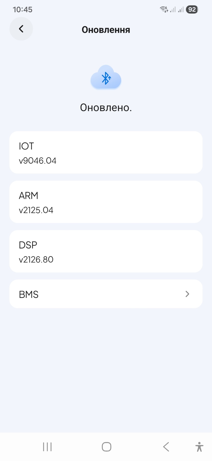

Thank you very much for your assistance and for pushing the new DSP firmware!
I have successfully updated to DSP v2126.80. After thorough testing during several natural power outages (and careful manual checks), the UPS mode is working well so far: the station switches seamlessly to battery power without full shutdown or need for manual restart. No issues observed even at 100% charge.
I’ll continue monitoring it closely, but for now, everything looks stable and much improved.
Great work from the technical team — much appreciated, especially during these challenging times in Ukraine!

Hi @BLUETTI_CARE,
The new version has arrived and updated successfully. The device is working well and stable. Thank you very much. Happy New Year!
