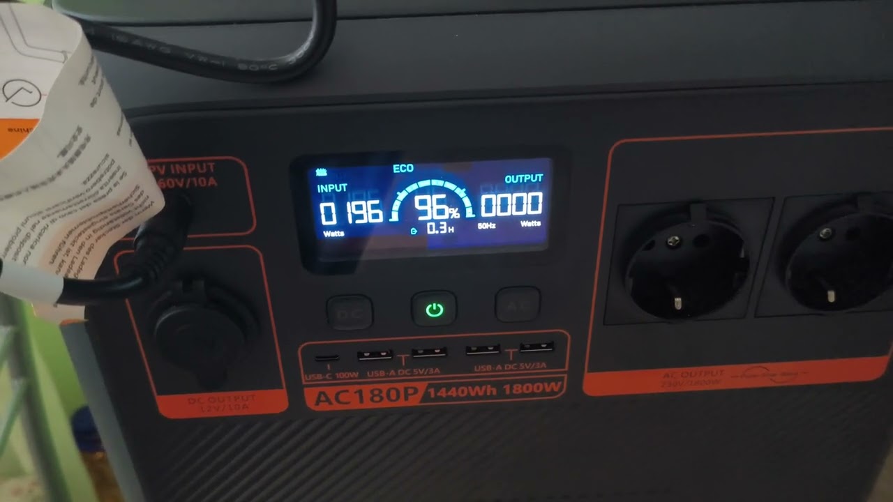

The device was not over-discharged when I turned it on, it was 57 percent charged. I was using AC charging, there were no loads. The station was without any devices connected. I left the station for 3 hours, connected the charger from the network and was able to charge the station to 100%. But the station still behaves very strangely. It turns off by itself when it wants to, does not immediately respond to the power button. After connecting a load of up to 150 W, it can turn off by itself, reboot randomly, and then not turn on for 3-5 minutes. When connecting a constant current source for charging, the screen flashes and the station reboots randomly, the station behaves the same way when connecting a load. The video is here.

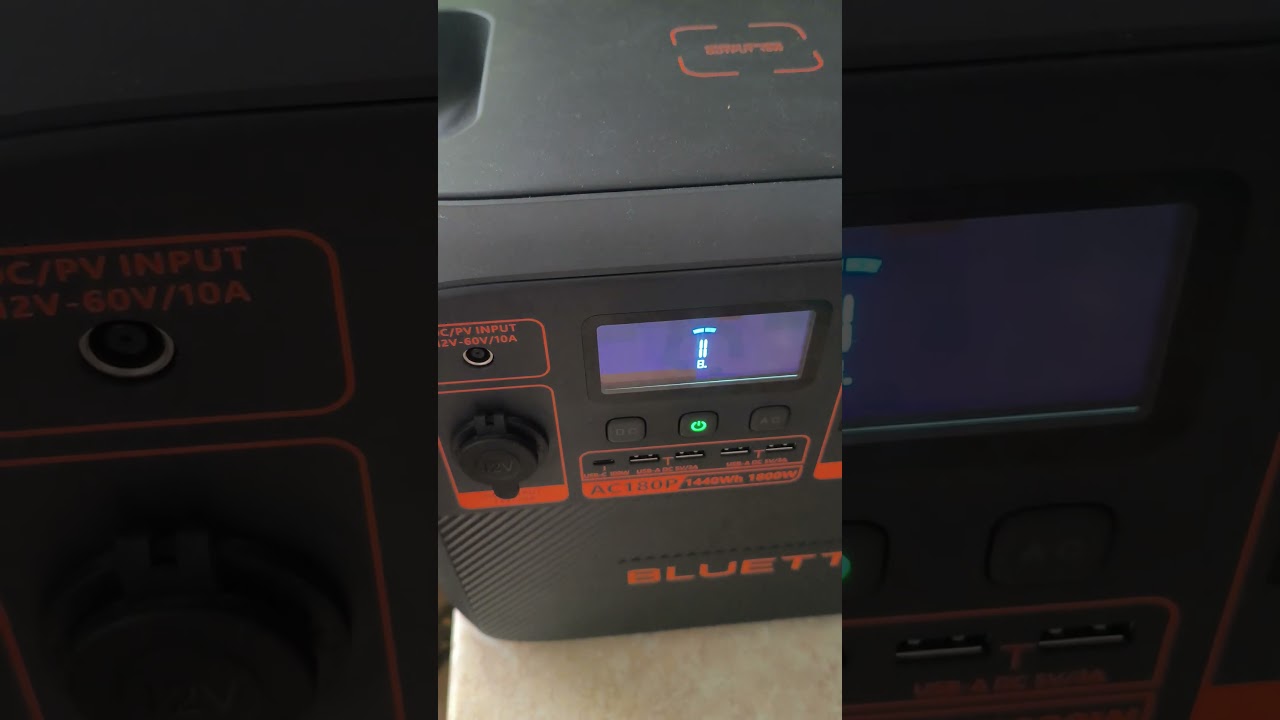

hi @BLUETTI_CARE Today, when I woke up, I saw that the station was working like this. After several attempts to turn on the inverter, it turned on and the station worked under a load of 100 watts. After 10-15 minutes, the inverter clicked and the station turned off and does not turn on.
