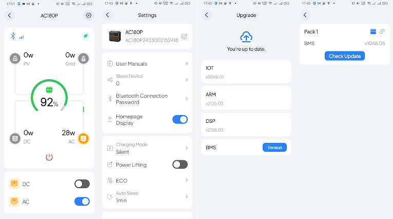

Hi @BLUETTI_CARE. I have had AC180P station for a few days and noticed a non-critical but annoying issue. I usually load the station with less than 100 watts; in this case, it is dead silent. But sometimes power consumption can surge to ~120 watts for a few seconds, and the station turns on the fans. The problem is that though the surge time is just a few seconds and then consumption drops to 25 watts afterward, the fan keeps going and going (definitely for more than 15 minutes), blowing cold air. I’m sure the station internals are cold because this happens when I turn it on from a cold start, and the ambient temperature is around 20 Celcius. Other times, it behaves correctly and shuts down the fans after a few minutes (I assume it waits these few minutes in case there will be another surge not to keep cycling the fans). But when it does not, it is really irritating because I specifically have chosen this station over another known competitor because, according to feedbacks, it ought to be silent for low loads. The current fix I use is disconnecting and reconnecting the load - the fans stop in this case, but it is not always convenient.
Other than that, I’m happy with the station.
Is this a known issue for which a solution will be available soon?
IOT v9046.01
ARM v2125.03
DSP v2126.03
BMS v1048.05
I really appreciate any help you can provide.
Hi @Roman_t, We found that your firmware is the latest one.
We believe this issue might be related to your load. When your appliance starts, it may cause a sudden power surge, which in turn triggers the fan to spin at high speed.
Please note that for some machines with built-in compressors or condensers (such as fridges, air conditioning, pumps, and freezers), the surge power will be 3-7 times higher than the rated power, and it will keep several seconds after it is just turned on.
