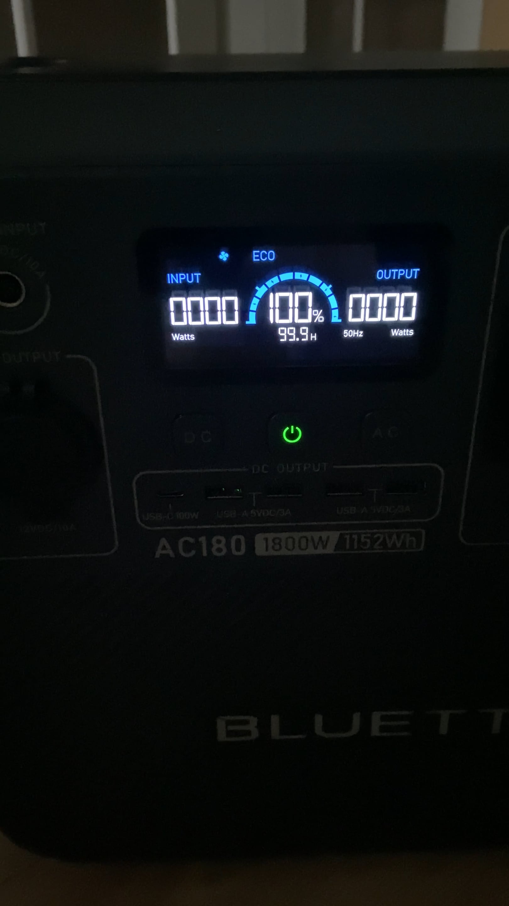

The fan runs continuously at high speed, even with no load. As soon as I turn on the power, it starts immediately and does not turn off at all — neither during charging nor when powering a load via AC up to 200V.
Is there any update available that could fix this, as mentioned above?

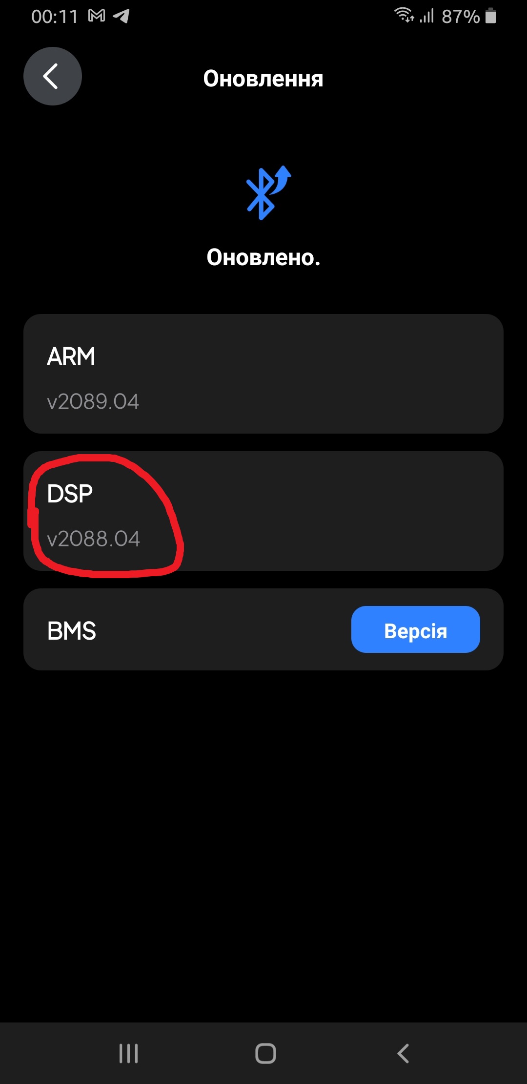

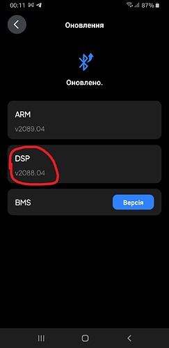

@Kostyantin @MykhailoS Nvm, it still happens even with DSP 2088.04 :upside_down_face:
My relative, who has it now, just called and said that they’re blasting at full speed for over an hour with the AC load under 100w. When he exceeded 100w load threshold by turning on his TV, they instantly went quiet.
But I think it was worse in 2024 with previous versions, though I’m not sure.
