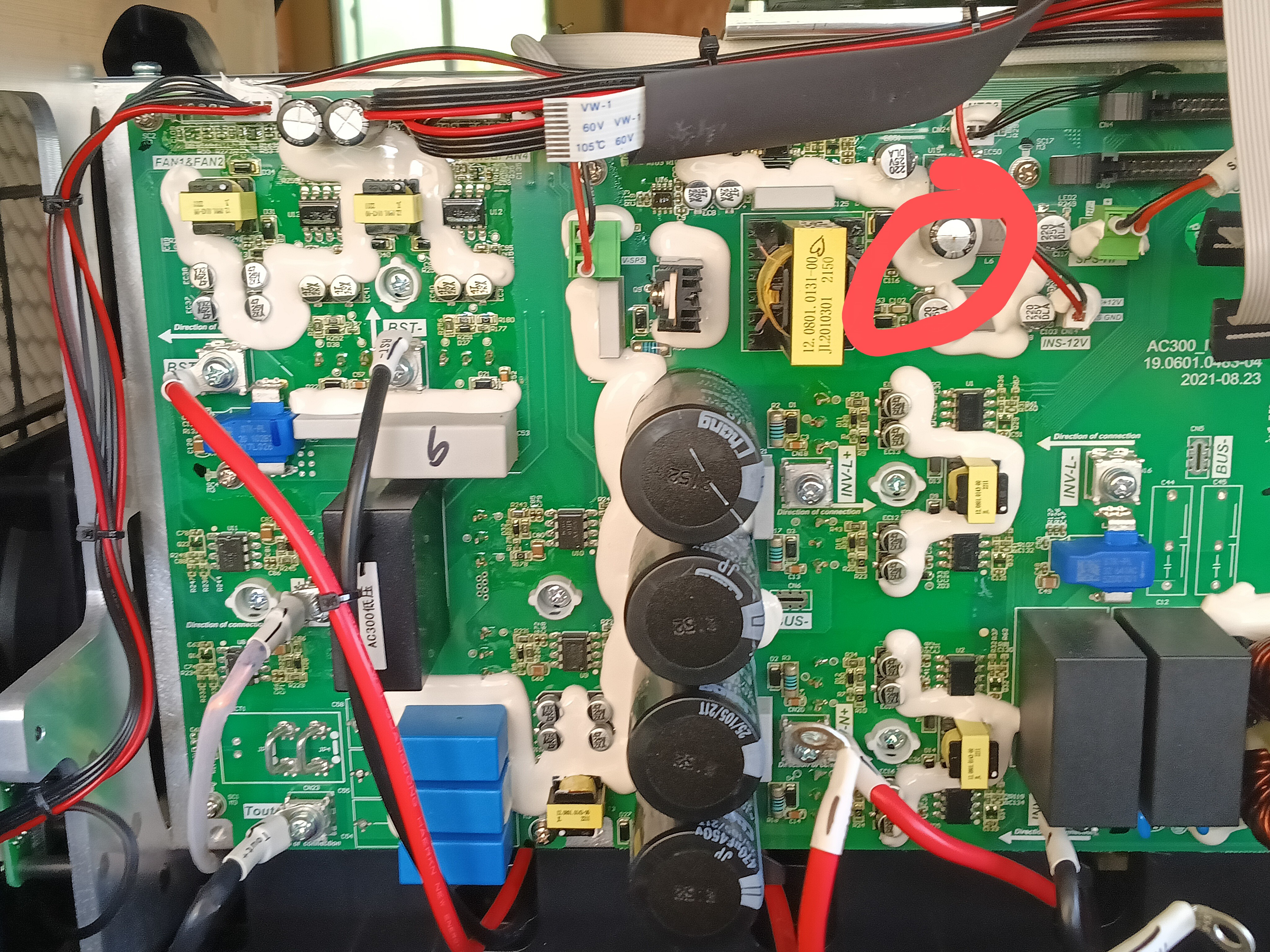

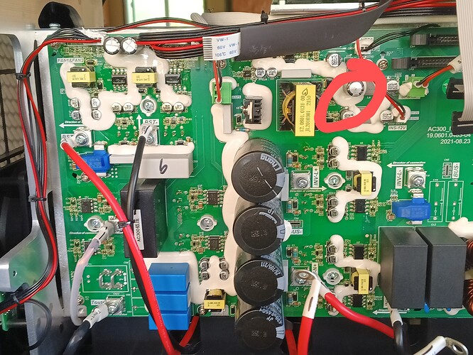

I just saved a unit with this very issue, I had to replace a small 1000uf 25 volt capacitor near the SPs connectors on the main board behind the outlets. Removing the main board is too much of a pain in the ass so rip the capacitor out from the top and add some solder to the remaining nibs to install your new capacitor without removing the board.

So is there a fix for the 006 code issue? I just started getting it recently. Unit reboots at least once or twice per day. I got mine used and highly doubt it’s under warranty. I live on Hawaii and would be too costly to ship off for service. A diy solution would be much better. I saw something about a bad capacitor on the motherboard in the head unit. Has anyone tried replacing? Works?? Any help would be much appreciated. Aloha

I believe I have fixed my unit throwing 006 error. It started occasionally then more often as time went on. As previously mentioned it’s a bad capacitor on the M2 board inside the front panel - 25v 1000uF. I swapped it out and unit seems to be working fine now. Capacitor was definitely bulged but luckily i didn’t notice any sign of leakage. Hope this helps someone as Bluetti customer service refuses to acknowledge the problem exists with these units even though there are plenty reports of same issue.
