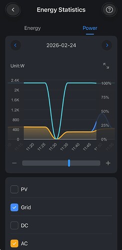

Dear community, my SOC is dropping zero for a couple of minutes (see the screenshot). But grid is stable and connected! I teared down my AC300 and capacitor was bad (same as on the picture in previous post)
The interesting thing- I have another AC300 new (capacitor is good!) but problem the same!!! What a h…! Batteries are good :thinking:
FW is not a case (2 AC300 has different fw)
@BLUETTI_CARE hope you have some idea
