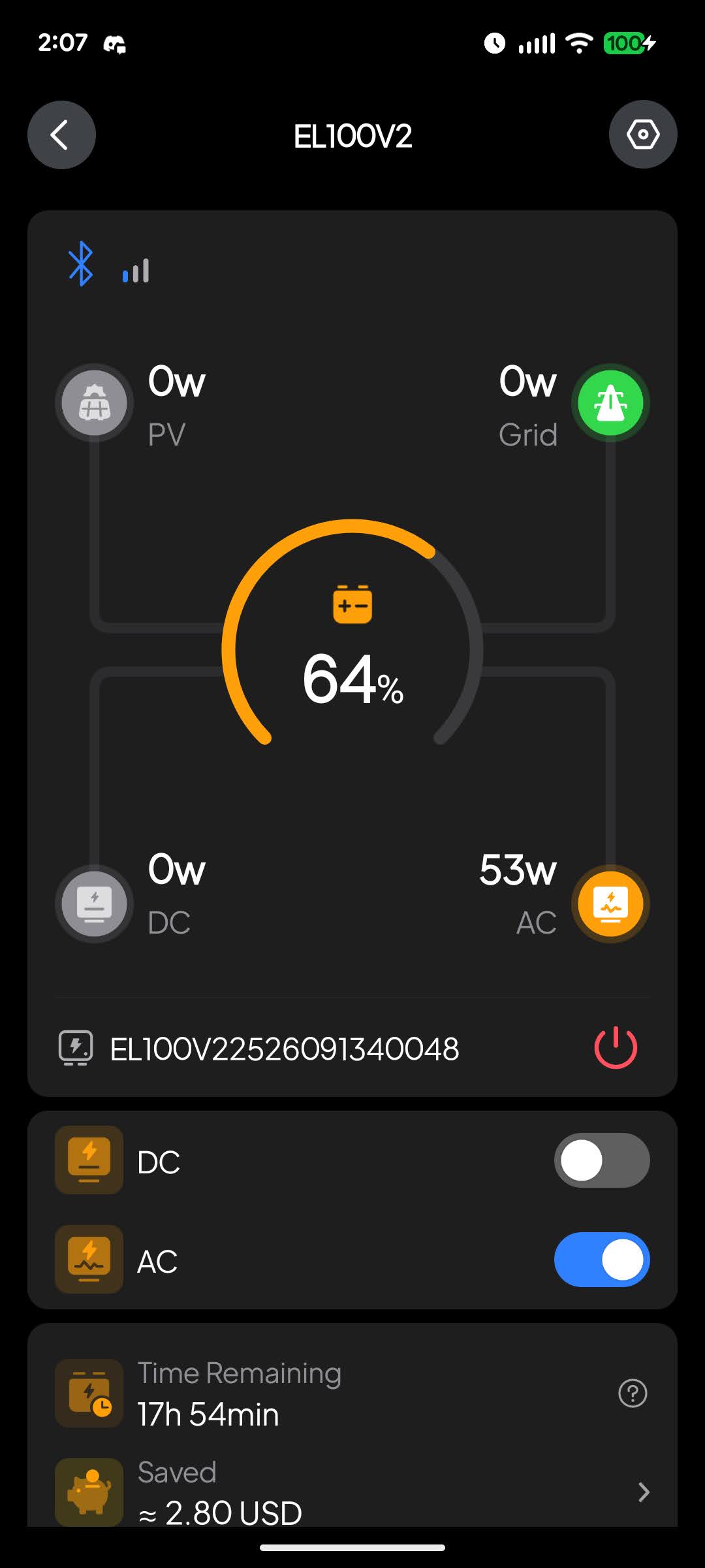

Thanks, I did the upgrade, followed the recalibration process, and checked the estimated time remaining over 2 days of charge and discharge cycles, and it looks like the latest upgrade is a lot more accurate.
Here’s a screenshot on the first day.
And here’s from the next day. So the estimated time remaining is now consistent and its value is much more accurate. So thanks for improvement!

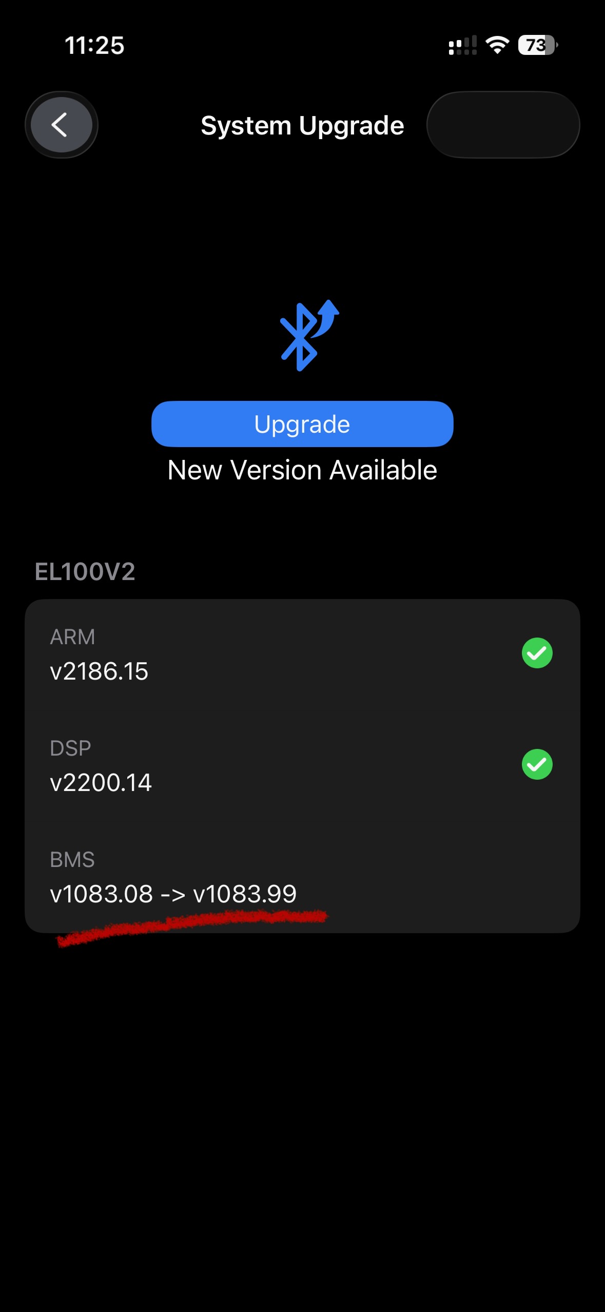

Hi @BLUETTI_CARE ! Thank you for your help! But unfortunately, for some reason the update is not installing. I tried several times, but the result is the same.
The update was successful, there were no errors. But after the installation, when I try to check the firmware version, I see that the update is not installed:
Could you please advise me on how to install the update correctly?

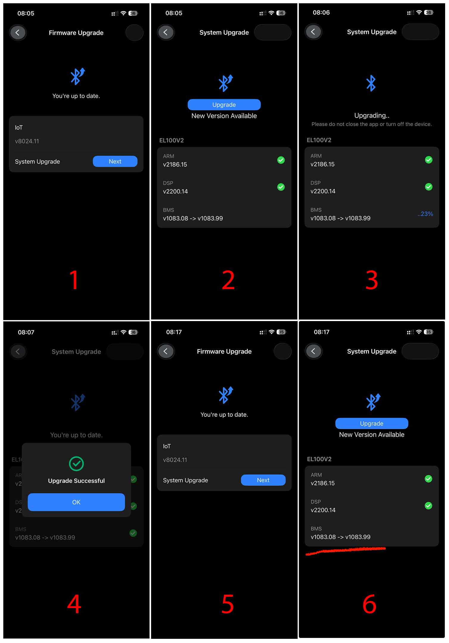

Hi @dparson55 @BLUETTI_CARE ! Thanks for advice. But I connected to the device via Bluetooth (following the instructions from the posts above). The system reports that the update is successful (to 1083.99). And when I try to check the current firmware version after the update, I see the old version number. And the original problem with the remaining time and power consumption still exists. In the attached image, I tried to show all my steps to update the firmware. After the 4th image, I try to check the installed version. I see that 1083.99 was not installed and the system suggests me to update the firmware to 1083.99 again (image 6).
Hi @Sergiy4079, We confirm that your firmware upgrade has been successfully completed.
Regarding the recurring upgrade notification, please ignore it for now—we have requested its removal.
Could you please perform a recalibration? We believe this will help the new firmware function optimally.

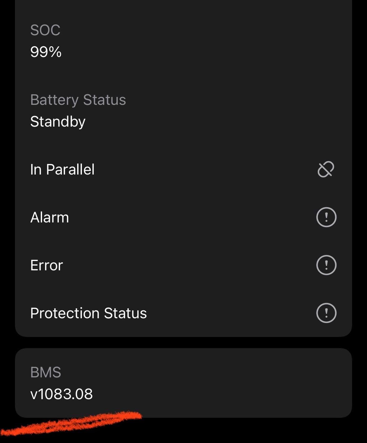

HI! After recalibration, the problem with displaying the load and remaining time was not resolved. After updating the firmware again, I have version 1083.08 installed. In several posts above, I see that users have solved this problem with version 1083.09. @BLUETTI_CARE Could this be my problem? If so, how can I update to version 1083.09?
Thanks!

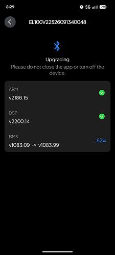

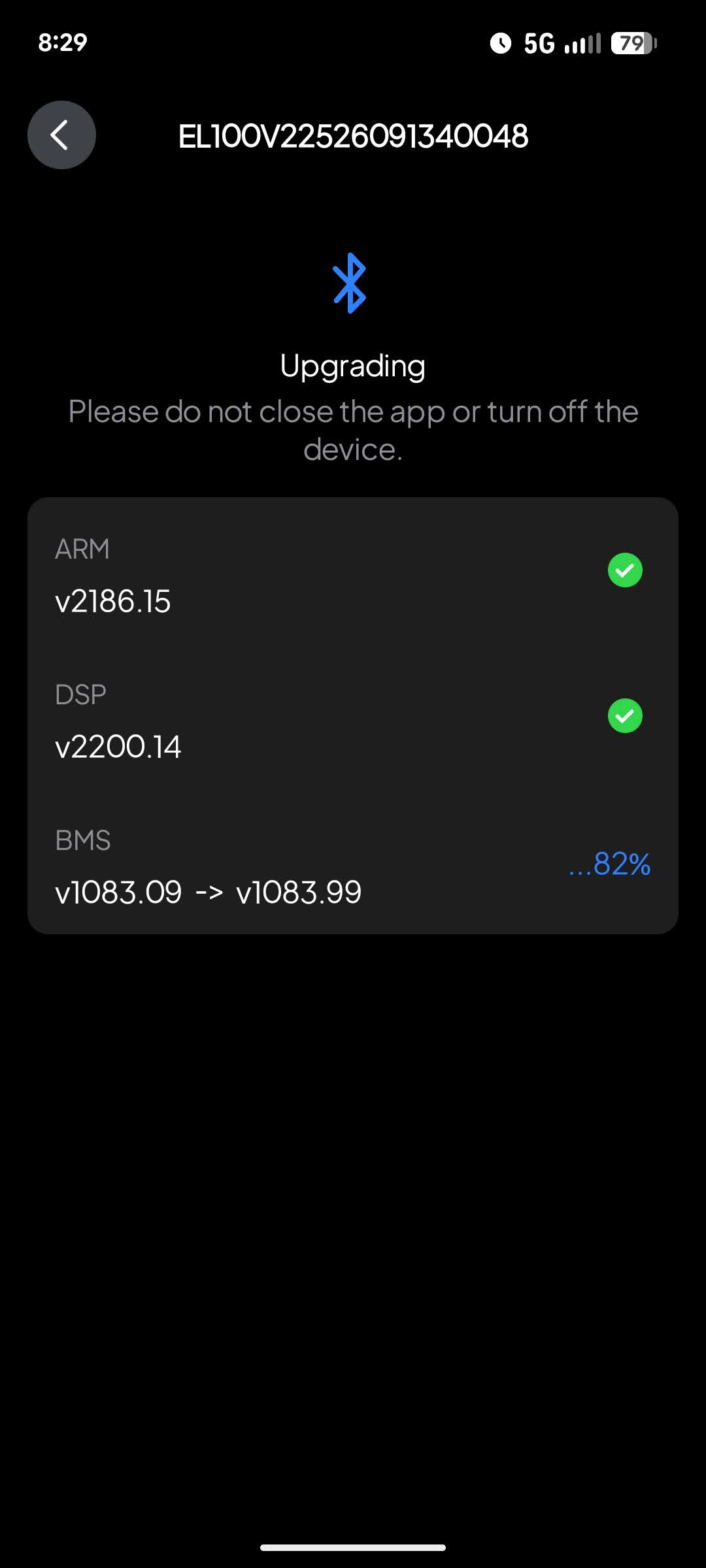

BMS 1083.10 Provides more accurate power readings.
However, there is a difference from the 1083.08, which is currently the standard. The difference is that the 1083.10 doesn’t block the ability to turn off the power with the central button while external AC power is present.
I already asked, but didn’t see an answer.
@BLUETTI_CARE Is this behavior of the BMS 1083.10 safe?
Hi @lavash_bluetti, the BMS v1083.99 is a newer version than BMS v1083.10. It mainly focuses on adjusting the SOC algorithm and optimizing the remaining runtime display under low-power loads.
To display active power correctly under low-power loads, an upgrade to DSP v220016 is required.
These 2 firmwares have not been pushed out in batches and must be requested separately.
