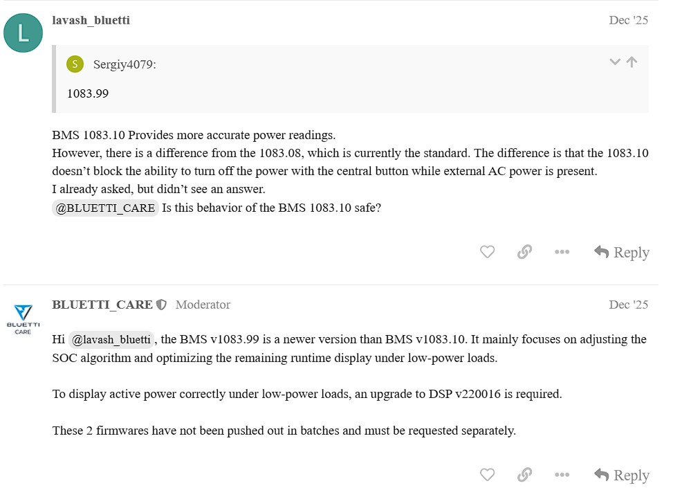

Also, consider this :arrow_down:

But I read here in this post that other firmware like BMS v1083.10 or even .99 (?) is available and seems to help.

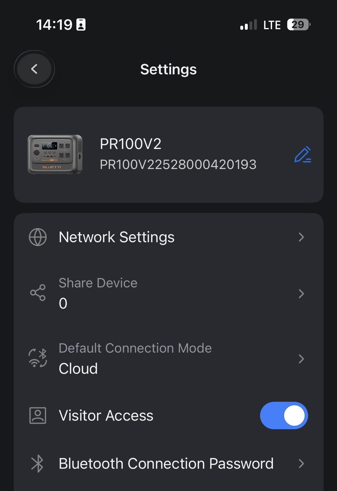

However, the SN code for the Premium 100 V2 you provided earlier appears to be incorrect, so we are unable to push the firmware.
Please note that the correct SN code consists of the model name followed by 13 digits.
PR100V2225280000420193
The SN code you provided has 2 extra digits. Could you please send a screenshot of the SN interface so we can confirm this? Once we receive the correct information, we will apply for the firmware push for you.

What’s the difference between 1083.09 and 1083.10 and can I get the DSP v2200.16 update please
Hi; @BLUETTI_CARE
Sorry for the wrong SN. Here is a screenshot;
Thank you.
