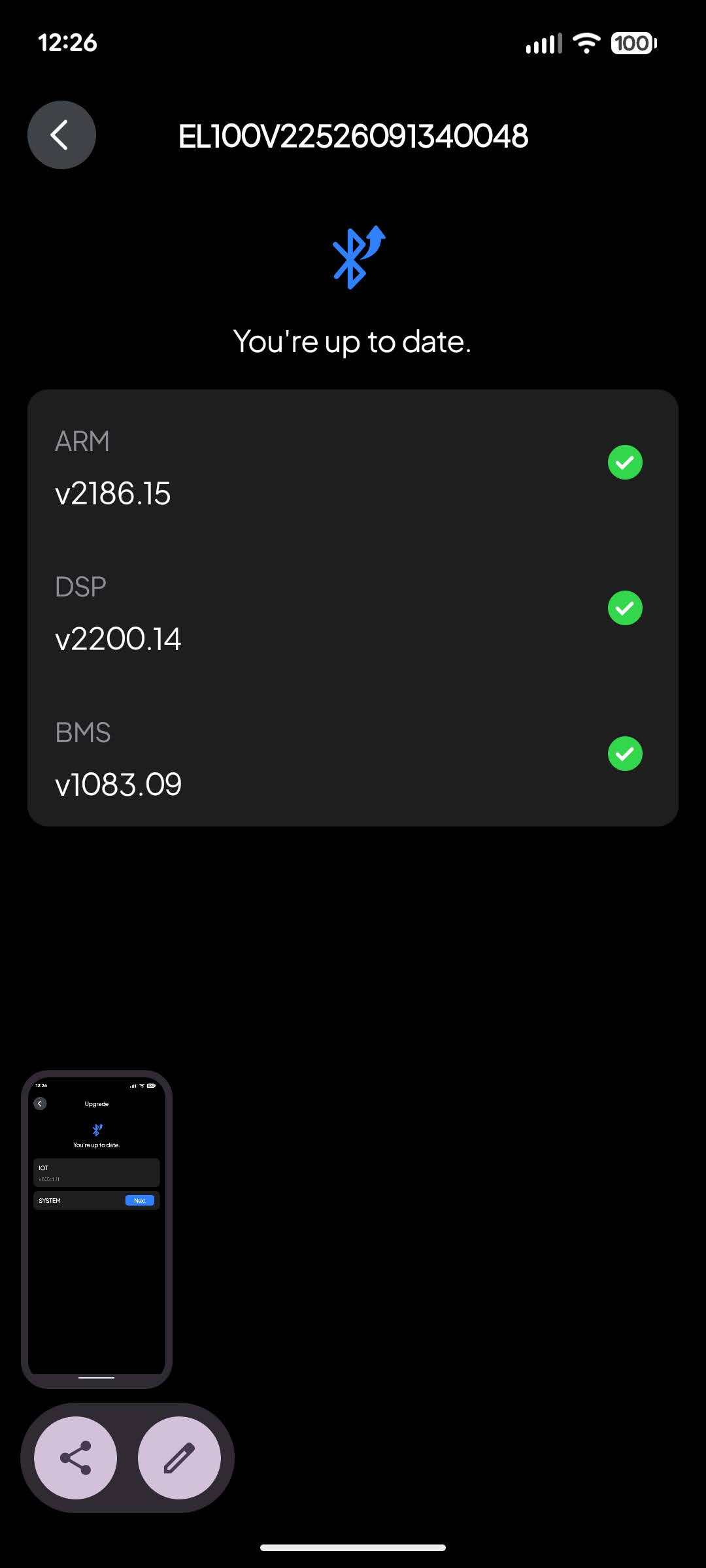

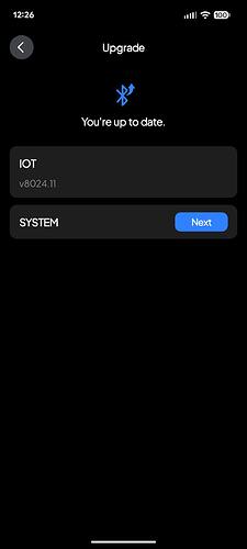

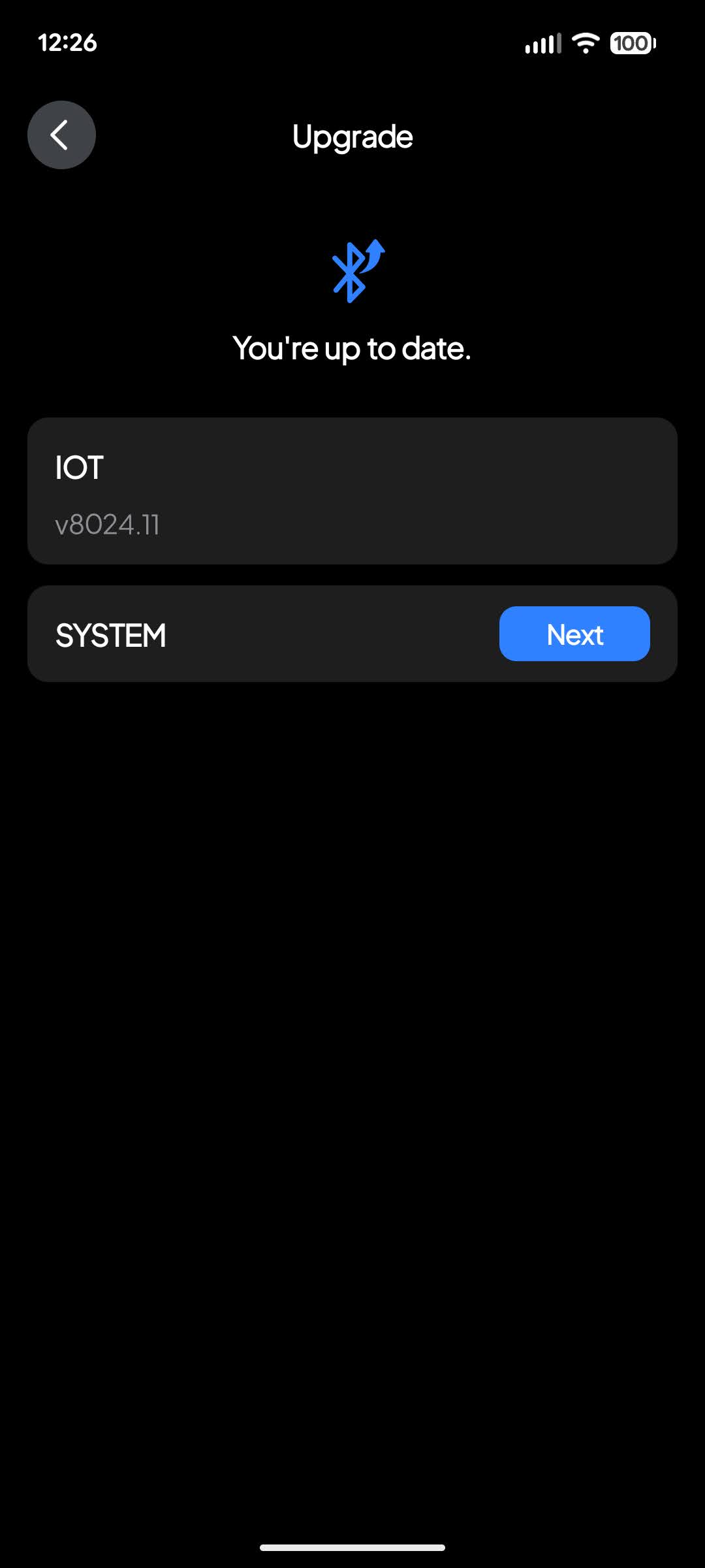

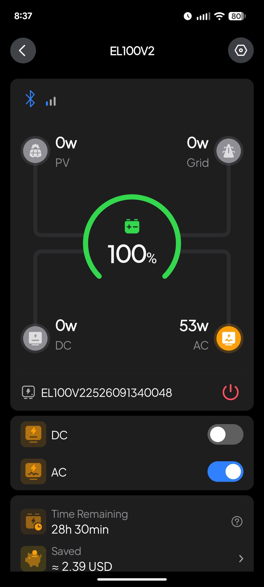

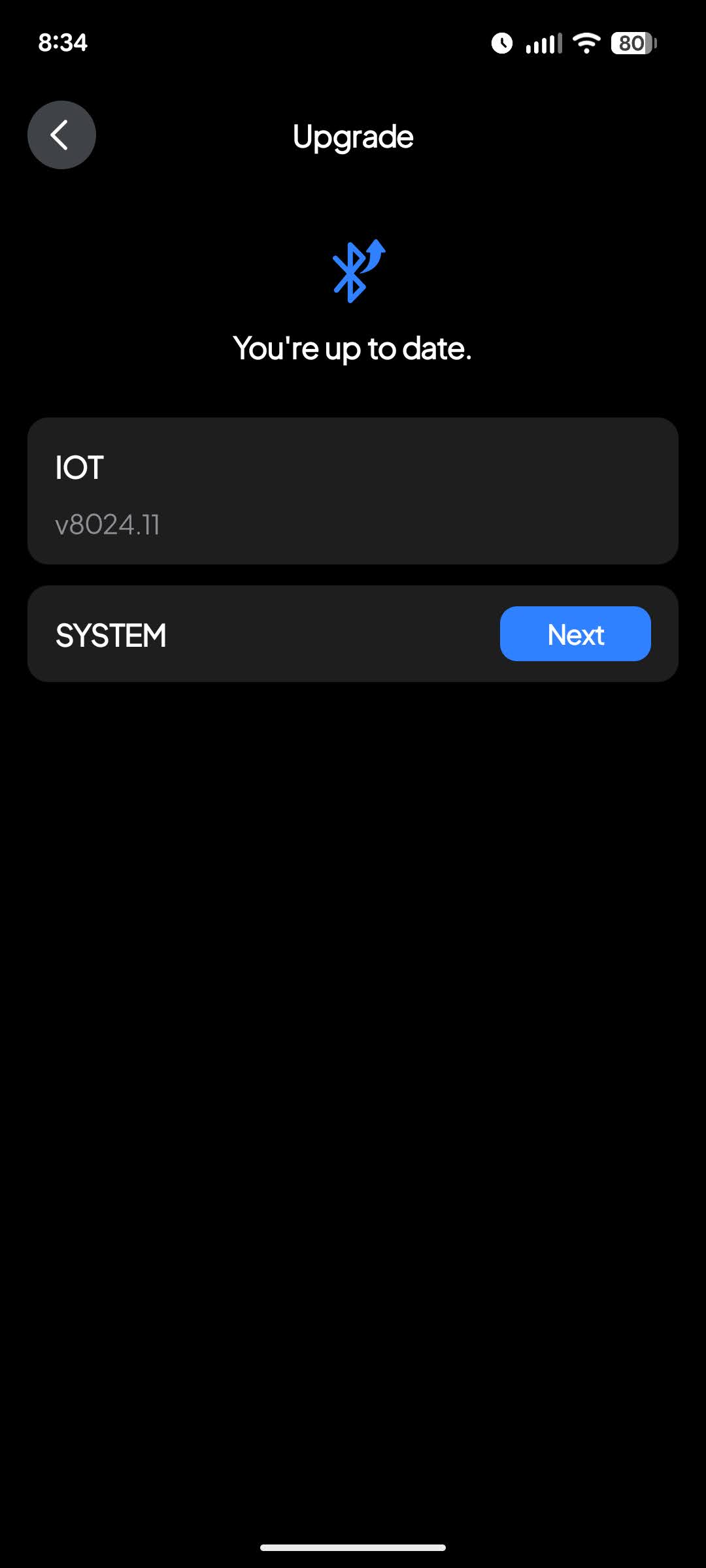

Thanks, it’s been 3 days but I’m not seeing the update yet. Here’s what I see:

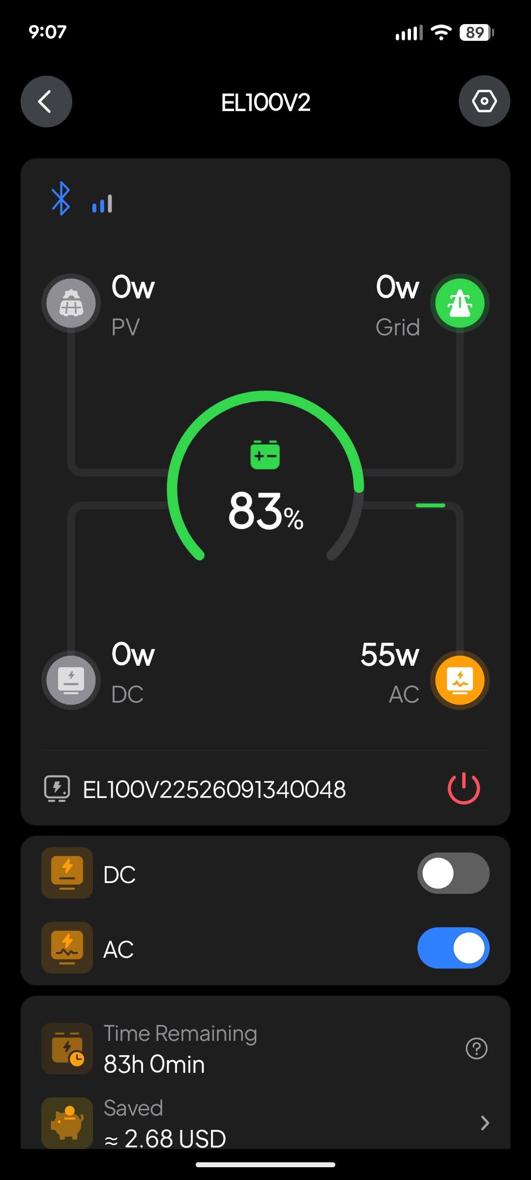

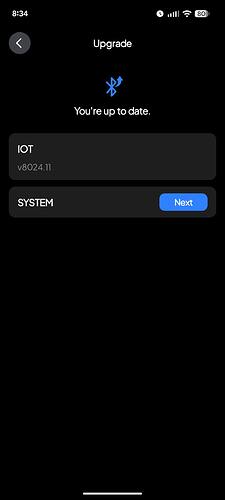

I have the same problem with the remaining time not being displayed correctly. EL100V22527008227258 Today I updated the station’s software, but it didn’t help. 98h remaining time with 50W consumption.
Hi @dparson55, We have consulted the technical department about this matter. They informed us that your firmware is already the latest version, so no further updates can be pushed.
Please recalibrate the unit and then test if this resolves the issue.

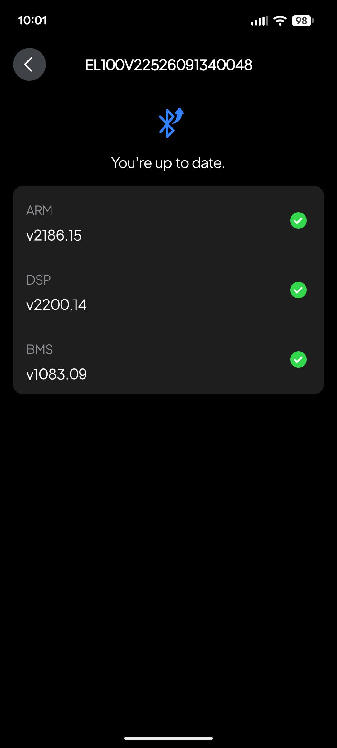

Hi @Sanchezz13, we would like to have the current firmware version of your Elite 100 V2. Then we will check if there is any new firmware available.
@BLUETTI_CARE I have PM’d you directly with my serial number, please can you push me the latest update, current firmware detailed below.
Elite 100v2
IOT v8024.11
ARM v2186.15
DSP v2200.14
BMS v1083.07
Thanks.

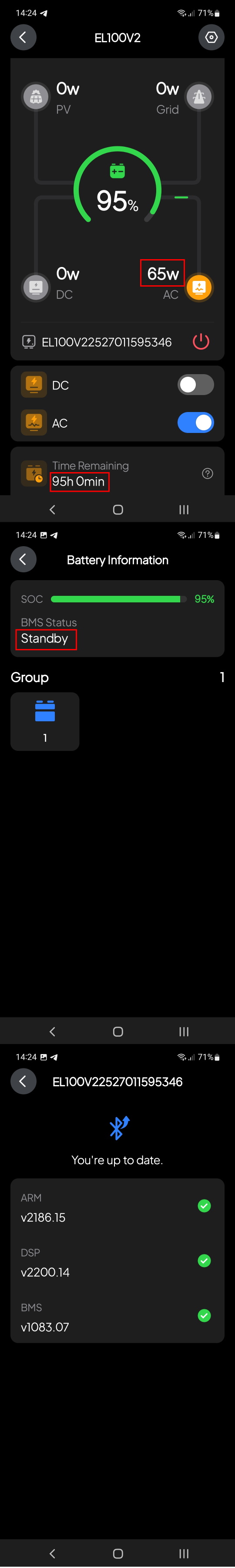

I also noticed that while the battery is discharging, the battery status shows as “Standby” not “Discharge”.

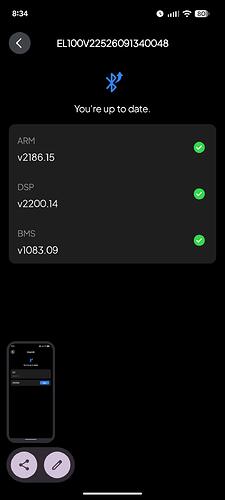

I have the some problem of time remaining not being displayed correctly. It displays the remaining percentage instead of hours and minutes. EL100V22527011595346 BMS v1083.07 (there is no newer version to update).

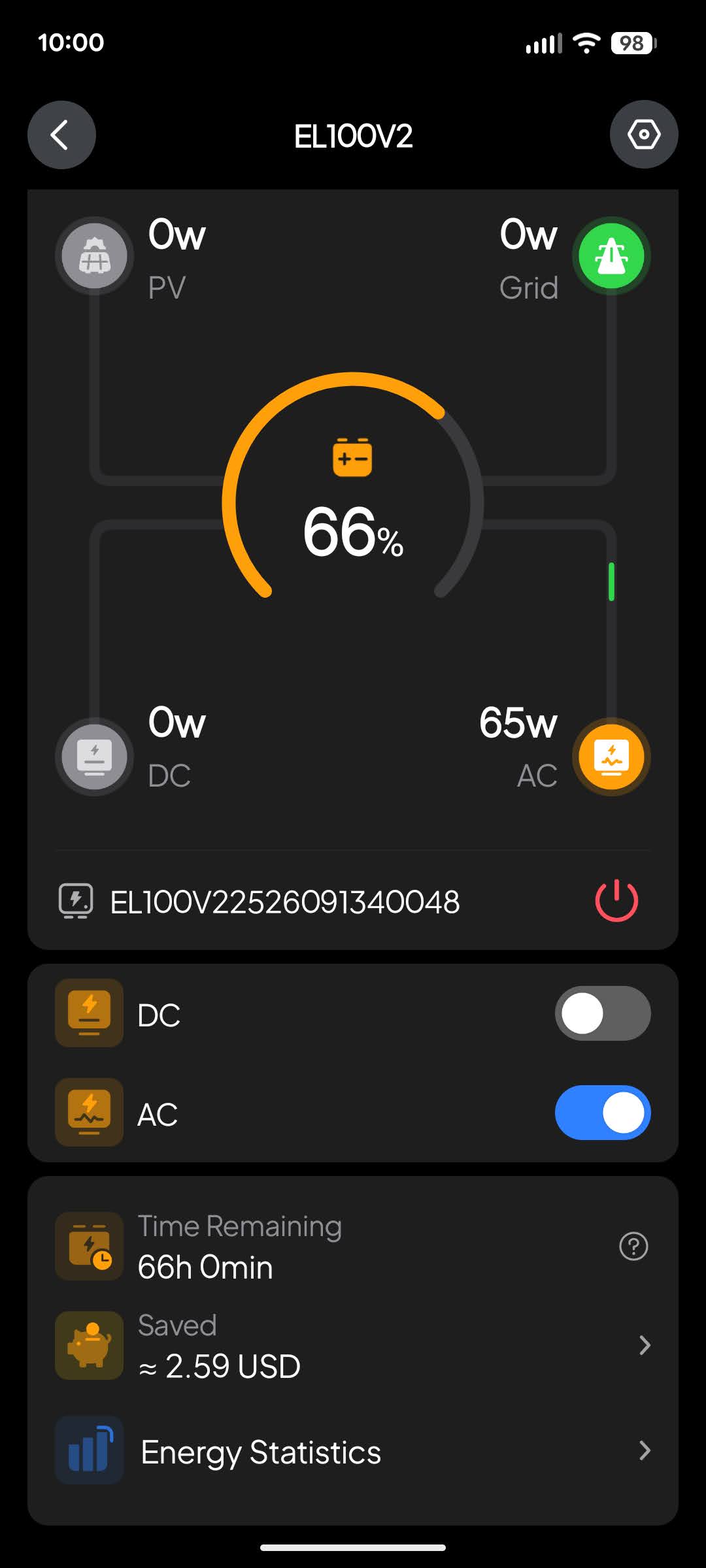

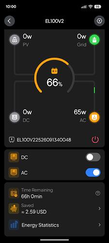

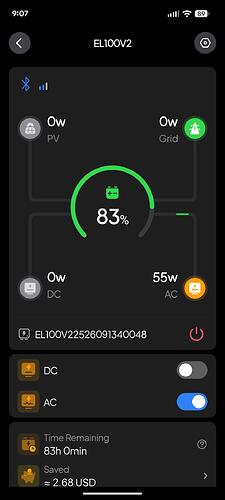

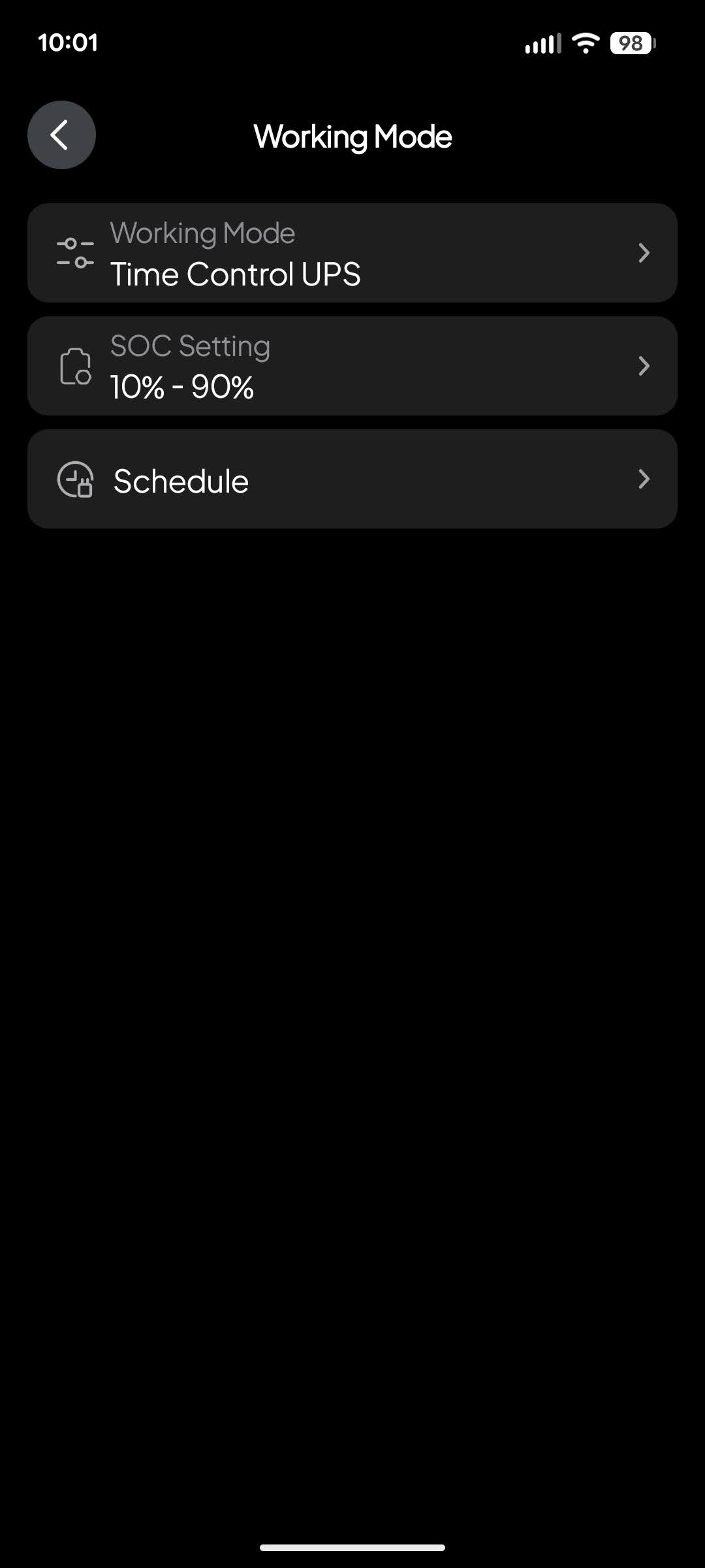

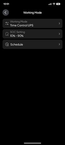

Well I spoke too soon, the day after I did the recalibration routine the invalid time remaining issue started happening again. In the screenshot the 1024Wh battery at a 66% state of charge, along with a 65w power draw, will actually last about 10 hours rather than the 66 hour estimate that is shown. So unfortunately doing a recalibration only seemed to result in an accurate estimate after one discharge and charge cycle. I’m using the time control ups feature so every day the battery is drained and recharged so maybe the technicians can test that if they try to fix this issue.
