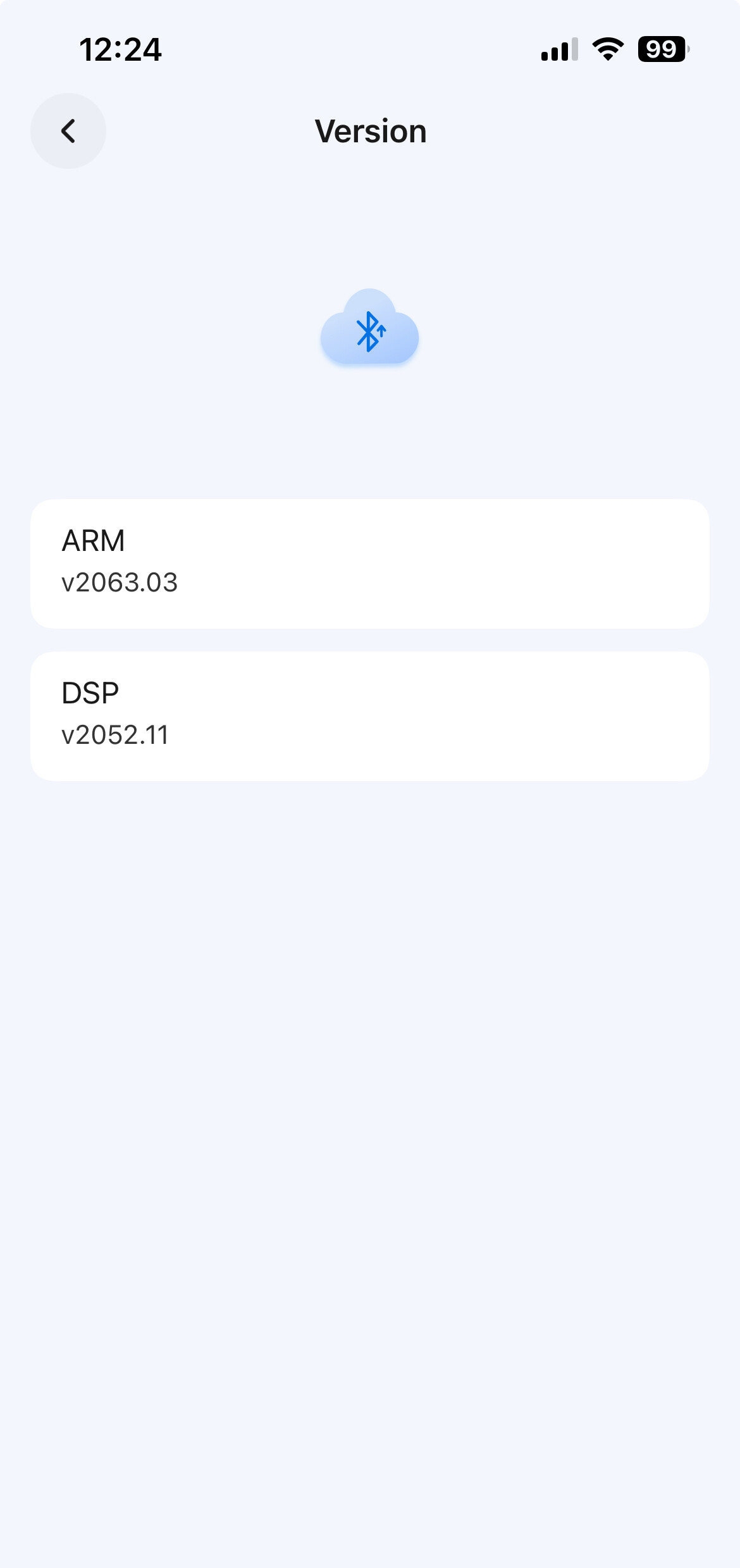

Hello. Unfortunately, I can’t see any firmware updates?
EB3A2246001962012
