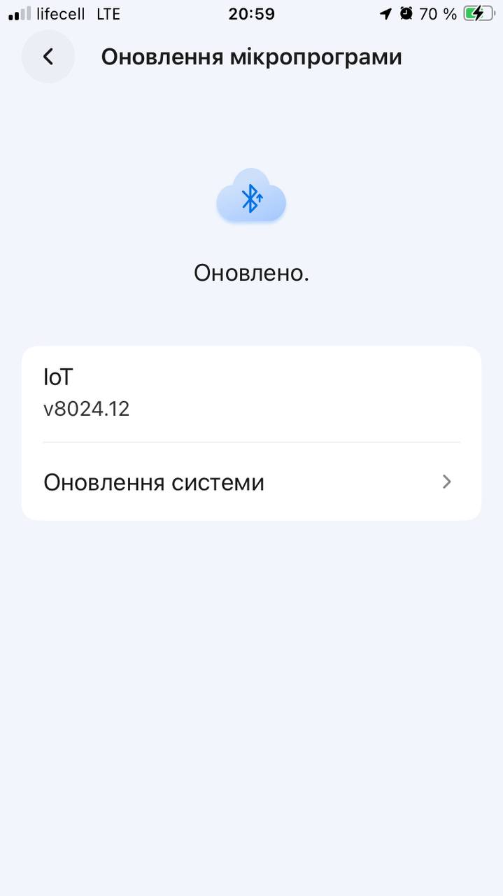

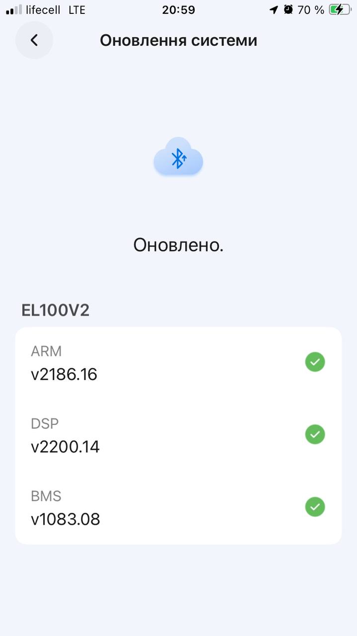

    4.1. I immediately updated the firmware to the latest version (updating all programs) to v2186.16. I did this on December 17, 2025.

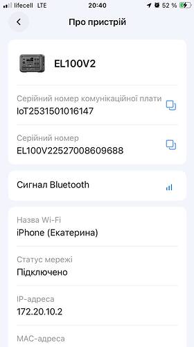

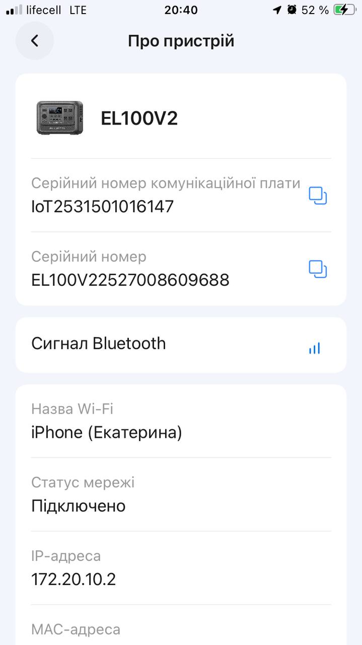

I’ve completed all the steps above. The serial number is in the photo!!!
EL100V22527008609688
IoT2531501016147

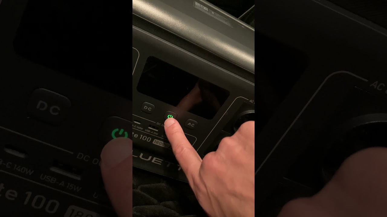

My video at YouTube:
