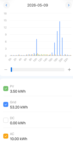

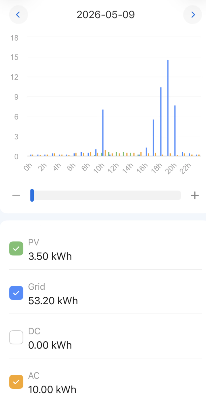

Here’s an example:
Notice how the grid shows 53kWh, with all of it happening across 6 hours (10:00, then 16:00-20:00).
These numbers are literally impossible, as my Apex300 is connected with a 120VAC power input. Grid input is set to 12A, so even if it were taking grid input at the maximum (12 x 120 = 1440W, roughly 1.5kW) this would only account for 1.5*6 = 9kWh. Even if it were running at maximum input for 24 hours, that would still only be under 36kWh. There’s simply no way you can get 53kWh out of a 1.5kW grid input in a day.

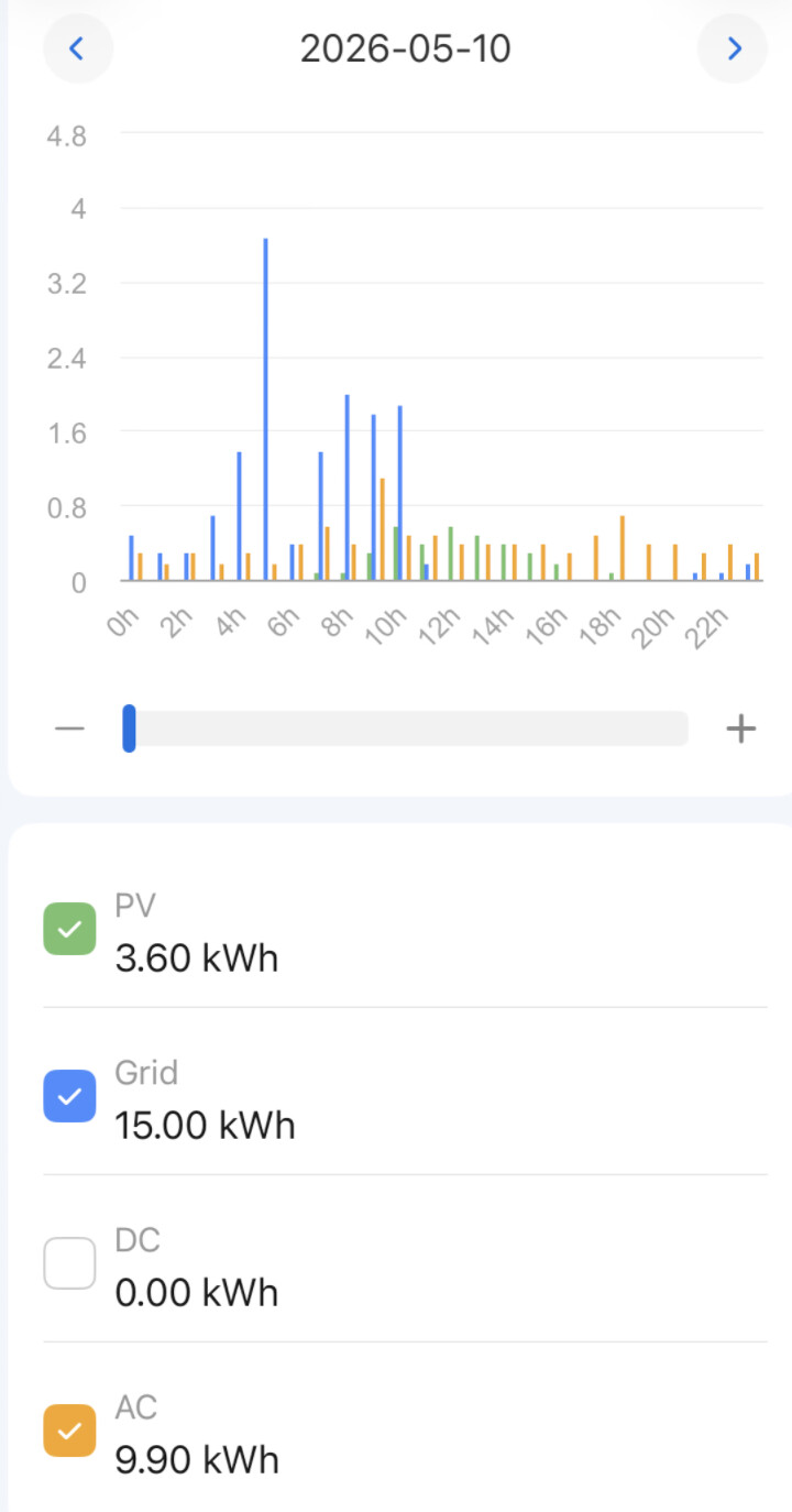

Most dates do not show this bug - here’s a more normal looking day with data that is believable:

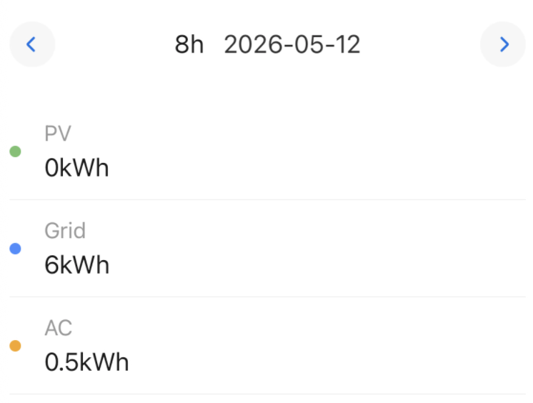

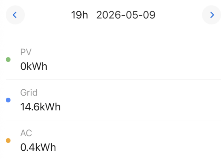

If I zoom in on one hour, I see this:
Somehow the Apex300 is reporting that in one hour (19:00 to 19:59) it pulled nearly 15kWh from a 1.5kW input. Nonsense.

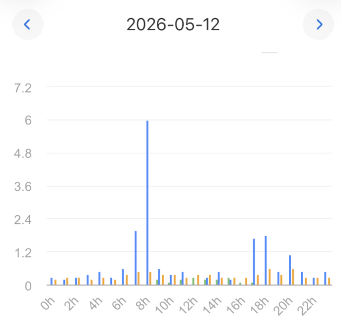

Here’s the 12th of may (yesterday):
Notice the spike at 0800 hours:
Again, there’s no way the Apex300 could physically pull 6kWh from a 1.5kW grid input in one hour.

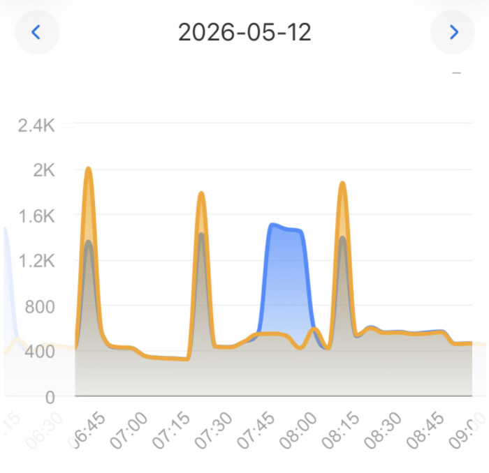

Here is the Power Input data for that time period (Grid: blue, AC : orange)
The power data looks correct to me: I’m in self-consumption mode. i ran a tea kettle which ran on battery power. Afterwards the Apex300 used grid input to recharge. There is a spike in Grid input, but it’s about 1.5kW, and it lasts about 15 minutes, which adds up to about 1.5 / 4 = 0.375 kWh.

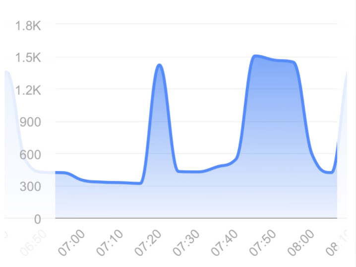

If I zoom in on the Grid portion only for that one hour period, I see this:
As a rough estimate, this is:
  • baseload of 400 watts x 1 hour = 0.4 kWh
  • two spikes, small one of 0.2kWh, big one of 0.4kWh.
  • total should be about 1.0kWh
yet the Apex is reporting 6.0kWh!
