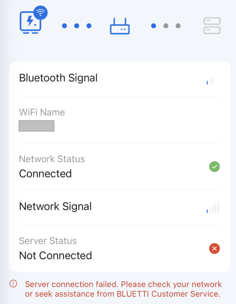

See prior outage thread here: Server Status: Not Connected - Bluetti Server Outage? - #37 by BLUETTI_CARE
Same symptoms as before, “Server connection failed”, and I’m showing my Apex 300 hasn’t updated it’s status for about 14 hours.

On further investigation, I discovered something unusual - although the Apex300 said it was connected to my WiFi network, my WiFi AP showed that it had dropped WiFi connection 2 days ago and was not actually connected.
I connected to the Apex300 via bluetooth, and reset the wifi network a couple of times and now it seems to be working.
So for me it seems to be a new issue - some sort of mode where the WiFi connection is lost, but the Bluetti doesn’t realize it? Strange.
More info - my problem seems to be that my Apex 300, which has been connecting solidly to WiFi for days on end, suddenly is having trouble maintaining a WiFi connection.
here’s my router’s log of it doing multiple connections & disconnections:

I have made zero changes in my WiFi network lately, and all other devices in the household are operating normally, so this seems like it’s something specific to my Apex 300.
Still not sure what’s going on - at times, the Apex 300 connects to WiFi, but shows Server Status ‘Not Connected’.
This makes it seem like it’s a Bluetti server problem.
But it’s also dropping the WiFi connection frequently - I don’t know if there are 2 problems here or just one?
Further testing reveals this is likely a WiFi problem, not a bluetti server issue. I tested this by connecting the Apex 300 to a personal hotspot on my iPhone. (Note: you have to click the ‘Maximize Compatibility’ button on the iPhone to turn on 2.4GHz mode).
Once I did this, the Apex 300 connected to the hotspot WiFi, and to the Bluetti servers right away, and appeared to stay connected.
What I’m not clear about is: what changed. It seems possible that there is some new 2.4GHz interference in my neighborhood?

@JohnD333 in my case, I think the instigating factor was some sort of WiFi interference. Last night I was able to see the bluetti on WiFi and ping it, and was getting 30% to 80% packet loss. This morning the interference seems to be gone, and I’m getting 0% packet loss.
I think there is a second bug which is a fault in the Apex 300 - it seems that when the WiFi is poor, the Apex300 will eventually disconnect from the WiFi access point (AP) - the AP shows the device isn’t on WiFi.
However, if you connect to the Apex300 by Bluetooth, it believes it’s still associated to the AP. This is a problem, because even if the WiFi interference is gone, the Bluetti doesn’t realize it, and fails to try to reconnect.
In this case, doing the “Reset WiFi” process does seem to work, and once the bluetti reconnects, all is normal.
However, that requires one to be in bluetooth range, not 1000 miles away.
