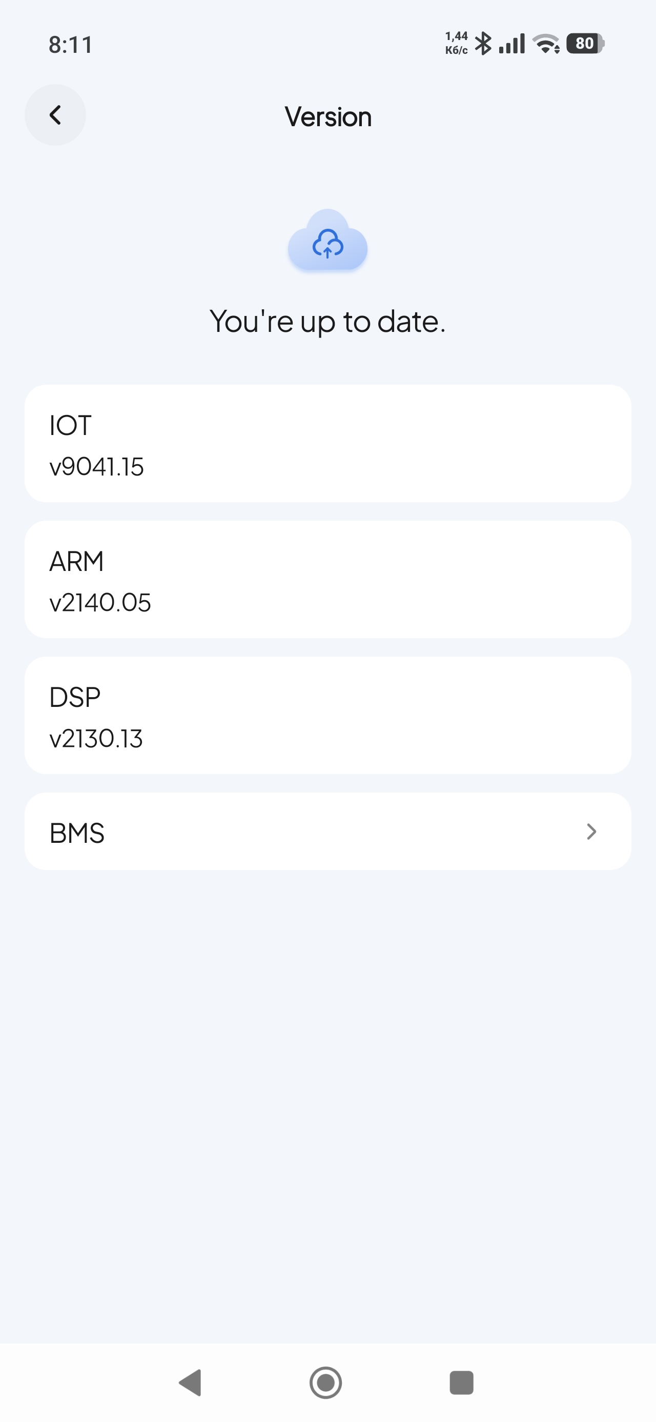

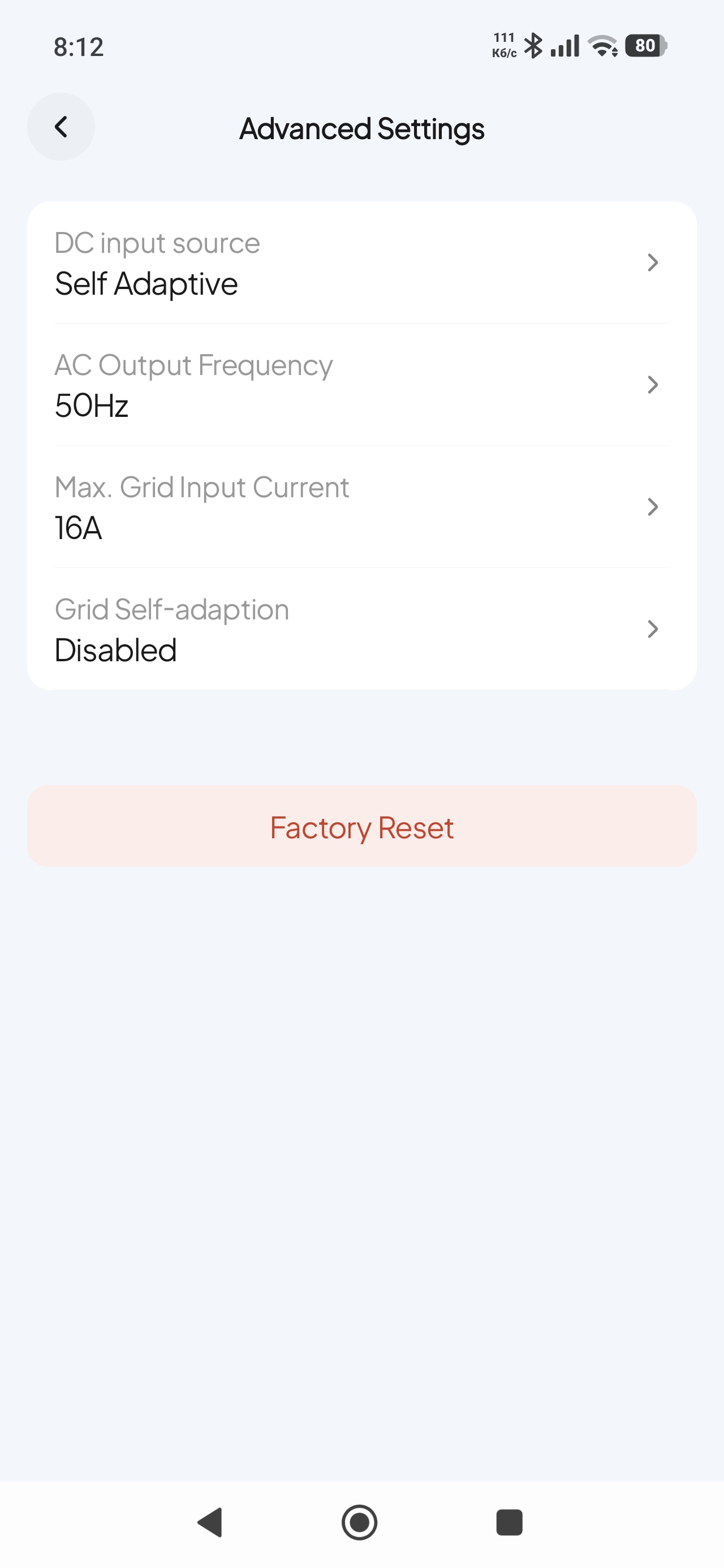

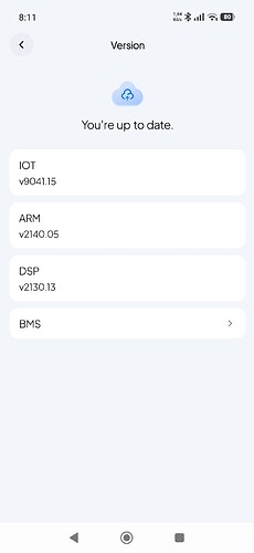

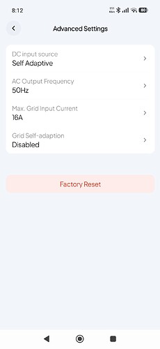

I received the new IOT firmware and successfully updated my AC200PL to version v9041.15. Unfortunately, nothing has changed, and the option to enable AC recovery mode is not found. Please check on your side to see if there might be a problem.
