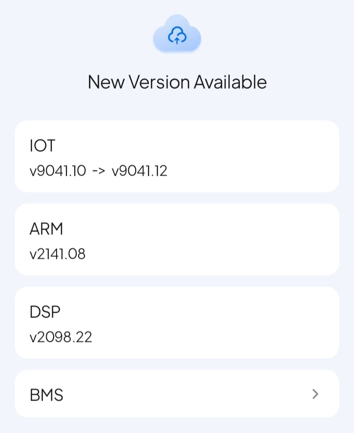

Hi,
unfortunately it didn’t work, the app now ask me to update from 2131.07 to 2131.08 and it procede correctly, i can see percentage on Unit and it tell me upgrade completed, after that anyway the app tell me the Unit needs to update , from same to same version (2131.07 to 2131.08).
The unit so didn’t update correctly and the system switch recovery remain disabled as before.

Hi @luigi_tomaselli, thank you for your update.
It looks like your ARM has been upgraded successfully. Please do not upgrade it repeatedly.
In addition, we have also pushed the latest IOT version to you. Please test again after upgrading.
We look forward to your feedback.

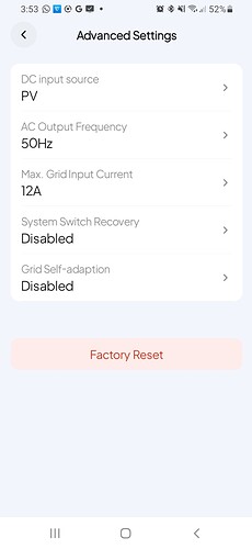

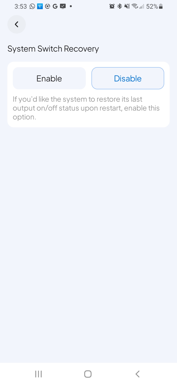

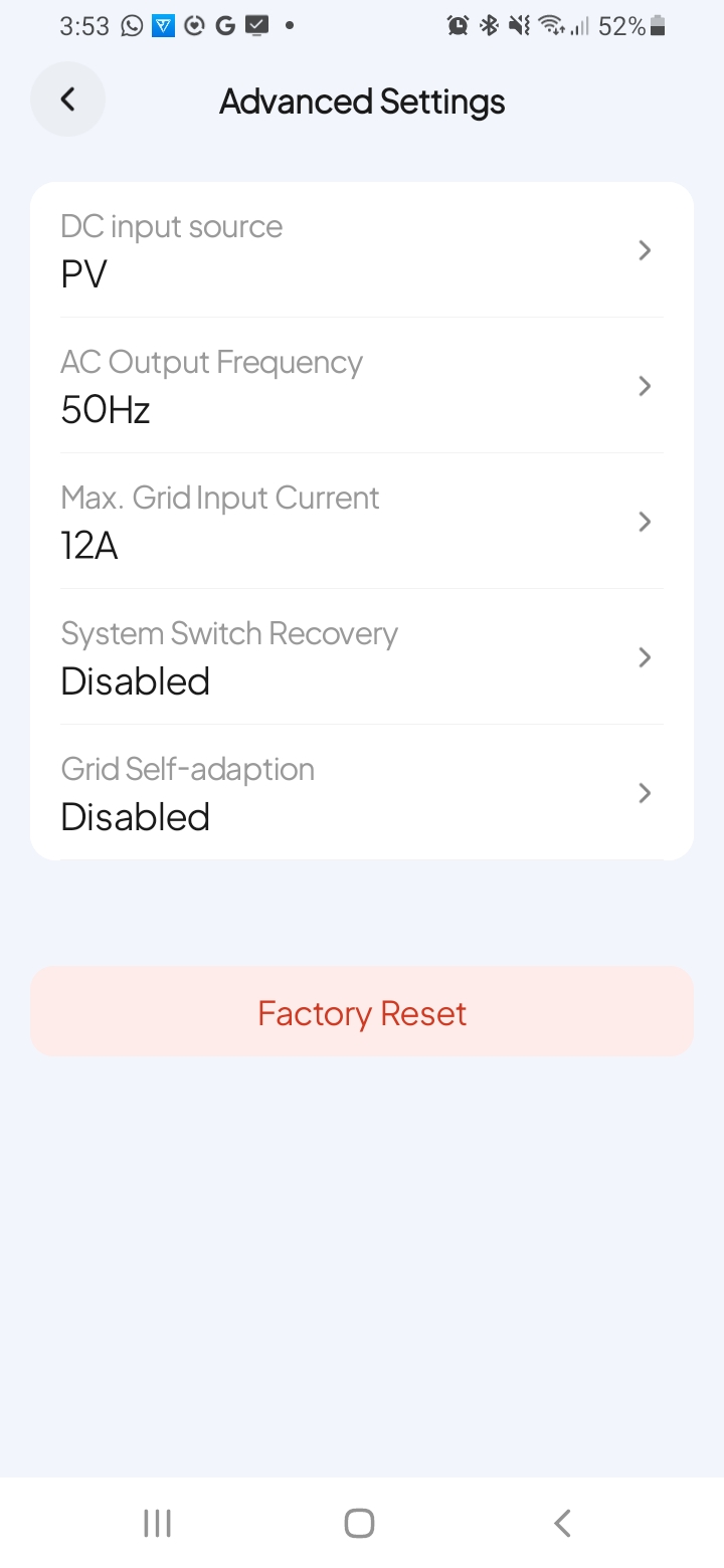

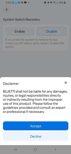

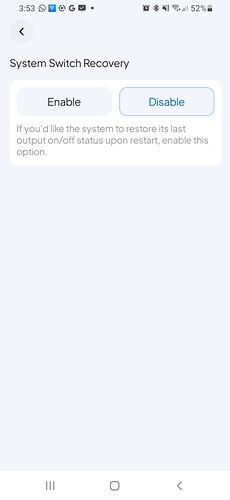

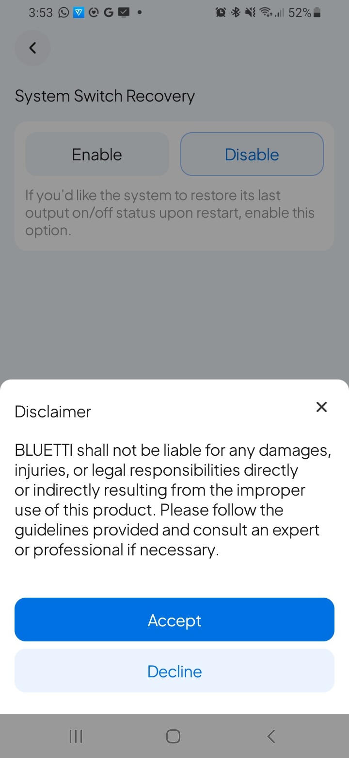

@BLUETTI @BLUETTI_CARE The app informed me of a firmware update today and I downloaded and installed it.
However, now the System Switch Recovery is disabled. Even when I go to advanced settings and enable System Switch Recovery it still stays disabled. The feature was working perfectly before the update that was installed today.
Please help me re-enable this feature.
