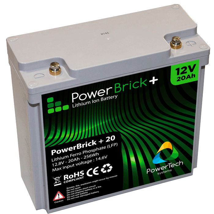

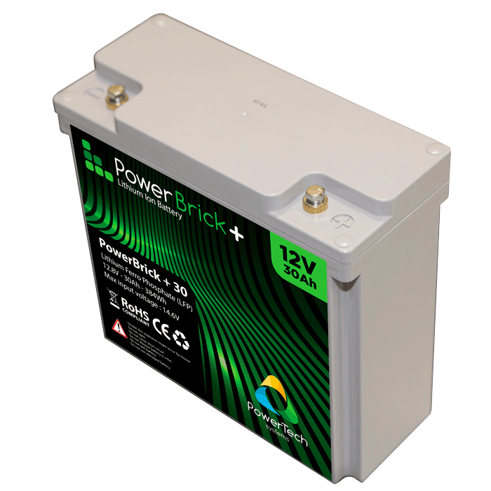

As stated in the video description: I use these batteries in my UPS:
2x 30Ah
You can also use 20Ah
As said, be aware that these batteries are not cheap. But quality comes at a price.
