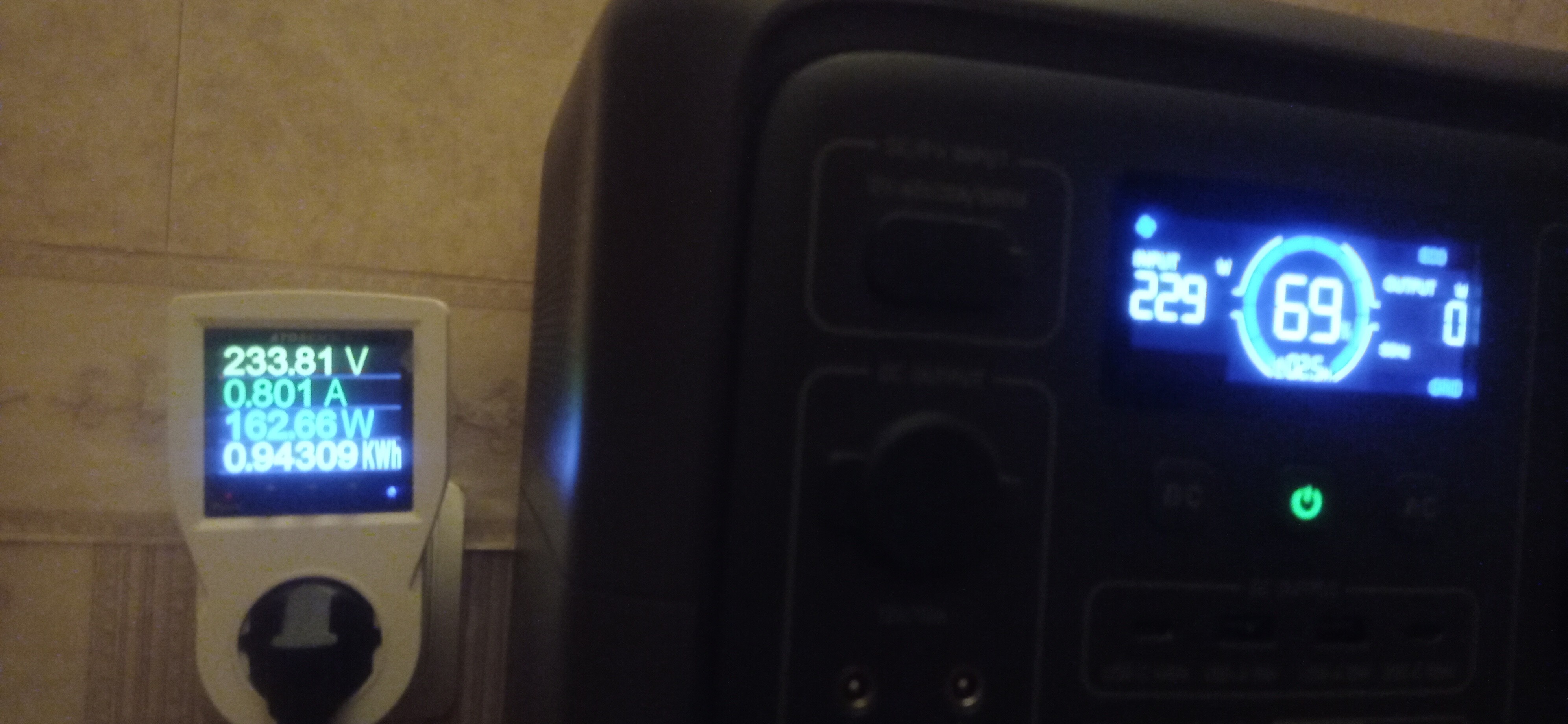

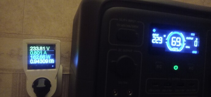

@BLUETTI_CARE However, there is still an inaccuracy in the input power during charging.
This isn’t as critical as it was with the output power, but it’s still there. When using the station, the customer is primarily interested in the remaining power in the station.
So.
The user has set the charging profile to 1A.
No consumers are connected to the station.
The station display shows a charge of 230 watts.
But in reality, the station is charging at 162 watts.
Apparently, 1A and 230 watts in the readings refer to the total power (reactive and active), while the wattmeter shows active power.
In other words, setting 1A and calculating for 230 watts of charging results in a charge of 162.
The most interesting thing is that when the station is 100% charged and has a consumer, the input and output power to the station are equal; their values ​​match the wattmeter readings connected to the consumer. In other words, in this case, only the active input power is shown on the display.
