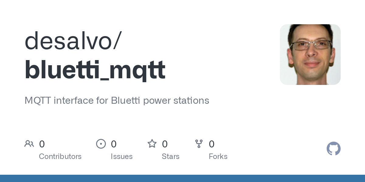

Hi all,
I’ve been fighting in the past 3 days with my brand new Elite 200 V2 unit to integrate with HomeAssistant. As reported here the data communication channel is now encrypted and the protocol is updated to V2, so all the modbus registers are different now. I’ve forked and extended in the past warhammerkid/bluetti_mqtt to add support for my other unit, AC240, to be able to add the max grid current adjustments. Of course this has been invalidated by the new changes with V2 machines :blush:
BTW, I also tried the bluetti crypt lib does not work on my raspiberry PIs, as it’s only available for x86_64.
HOWEVER… thanks for someone who pointed here to the nhurman/bluetti_mqtt repository, I’ve been able to include his changes and its preliminary implementation of the V2 protocol as well, and I spent the past 2 days reverse engineering the new Modbus registers and the protocol in general, and I think I finally have a working version for V2 units and encryption.
Now at least I’m able to switch on ac, dc, eco mode, grid charge and update the max grid charge current from HomeAssistant, and in general the modbus registers are now identified.
If someone is interested, the code it’s here, in the v2devices branch:
I’ve been testing this with my Elite 200 V2, so I cannot tell you if it works with other models too but should be fairly generic.
The updated server in github is also exposing prometheus metrics, for those who are interested.
Hi @desalvo
Thanks for letting us know! The Hassio plugin from Patrick als implement the code from nhurman recently. He is a real goat!
