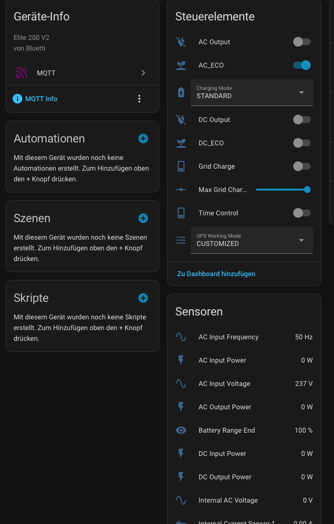

After some digging and trying I found a way to fully integrate a elite 200 v2 into home assistant. Nearly all controls are integrated (thx to desalvo for creating the fork and integrating the necessary code). It’s basically putting together the things from different users.
The approach is a bit hacky but doable (thx to toeachbyeach for the approach,

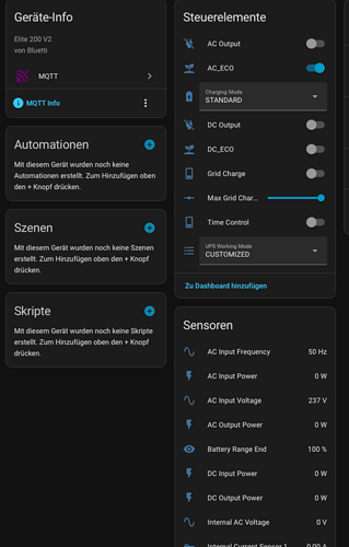

Restart Home Assistant. Next go to addons and click on add-on store. If everything worked as planned you should see “Local add-ons” directly at the top and there the bluetti2mqtt add-on. Install it. Now you should be able to discover your elite 200 v2 with the scan feature of the add-on (see protocol to get the details). Afterwards enter the Mac address which is listed in protocol in configuration of the add-on.
If everything worked as planned there should be a new MQTT device:

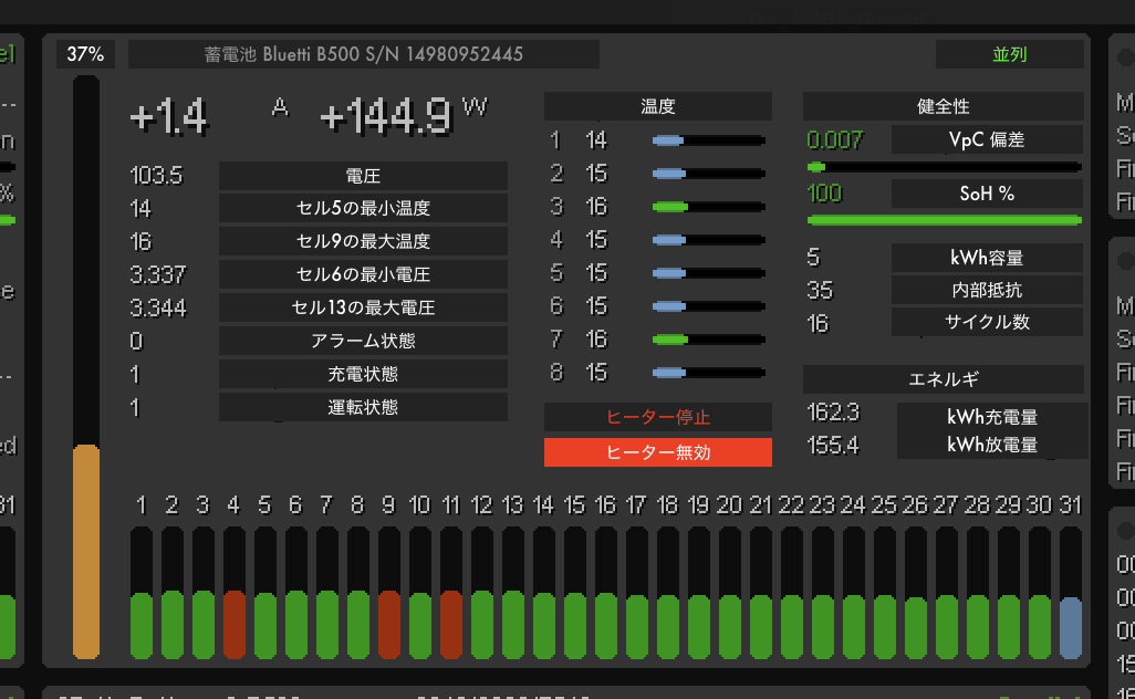

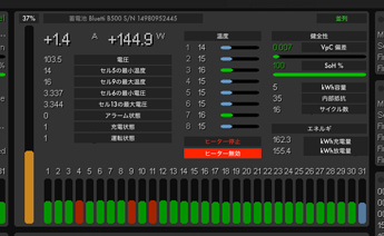

In the meantime, I have completely decoded the CAN protocol of the EP760.
This is quite different from the CAN protocol of the AC300 and introduces new very interesting features.
This model, in particular, not only exposes 31 cell indexes per pack which is singular, but also includes some interesting status bits in the CAN packets that are set and unset during charge and discharge for single cells like the BMS is actively balancing (in the screenshot of my engine I represented them as red and blue bars on the cell voltage levels).
Also worth of note is the SoH calculation (100%), average internal resistance calculation (35 mOhmAh) and 8 temperature sensors for each B500 battery.
VpC is not exposed in the protocol but I calculate it RT from cell V levels, this is always kept very low by the balancing system on voltage excursions from about 5 to 100% which is also great to improve pack lifetime.
As always, there is a lot to learn from these systems. :slight_smile:

What hardware are you using to read the CAN bus, and what software is converting the protocol for you? Your picture suggests you’re using “homemade” software, possibly written in C++?
The labeling in your picture seems to indicate a “home-field advantage” and is quite difficult for me to read…
My setup is overly-complicated because I always personally like to receive data to user-level before parsing to make reverse engineering easier.
CAN H/L → opto-isolation → MCP 2551 → MCP 2515 → SPI to an ATMega328 → UART → STM32 hardware to ethernet → C collector and parser → C opengl engine
The middle-man ATMega328 is RT single threaded receiving by SPI and relaying to UART without talking back so to avoid any unnecessary interference to the bus. For the moment I read-only.
C software is part of my company prop. resources but I’ll plan to simplify it by using a single transceiver+microcontroller; in fact everything can be done with a single MCU like the PBOX is actually doing by using an ESP32 wroom.
In my case CAN bus is very busy, with x4 B500 I detect 9 IDs talking almost simultaneously and payloads are split between packets so received data must be re-ordered and filled in a timeframe before parsing. Bluetti hardware exclusively talks CAN by MCUs so that is very fast and efficient, the PBOX is almost only buffering CAN data so it doesn’t actively participate as a software bottleneck which is good.
