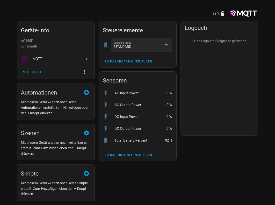

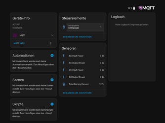

Well, i did it.
Using this repo. Had to hack around as root a bit on my Pi, but now it seems to work just fine.
here’s the diff of what i have changed
bluetti_mqtt/bluetooth/__init__.py
13c13
< DEVICE_NAME_RE = re.compile(r'^(AC180|AC200M|AC300|AC500|AC60|EP500P|EP500|EP600|EB3A)(\d+)$')
> DEVICE_NAME_RE = re.compile(r'^(AC180P|AC180|AC200M|AC300|AC500|AC60|EP500P|EP500|EP600|EB3A)(\d+)$')
30a31,32
>     if match[1] == 'AC180P':
>         return V2Device(address, match[2], 'AC180P')
Hope this info is of use to someone.
be carefull with root, everything you do is at your own risk :grin:

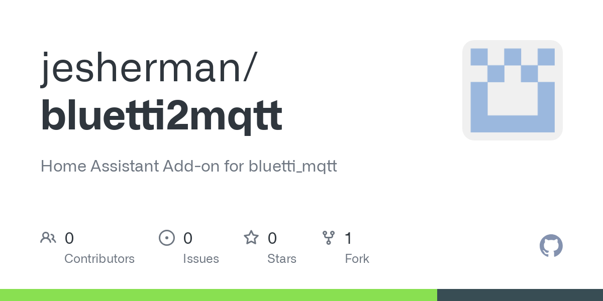

The way you install the package looks kinda odd to me.
maybe you could try installing it from github directly?
pip install git+https://github.com/jesherman/bluetti_mqtt
if that doesnt work, you could try to download the zip archive from the above mentioned repo and install it with
pip install /path/to/bluetti_mqtt-main.zip

Well, this is the version i am running on my home assistant, so i can definitely say it works. it also should run on windows.
