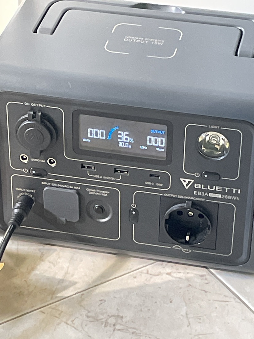

Still getting the blinking input showing 000 Watts, even under sunlight exposition.
I’ve changed already this unit twice but still having the same issue.
Although it says I have 30h left to run battery.
Can you push firmware to solve this?

@pW0lf1 I’m sorry that the firmware is the latest one. If the AC charging works, did you try to use another solar charging cable to test if it works?
Unbelievable. I have a powerstation that doesn’t work properly. Paid almost 1000€ by that time to have a powerstation that can only be charged on grid. My solar panel is absolutely useless.
Now I have, 100% sunlight condition and still doesn’t charge my EB3A.
I’ve returned already twice, the unit and you haven’t fixed or replaced by a new one!
How can we solve this in a proper way?
The first image shows when it’s connected with the solar panel cable, the second one, without…
