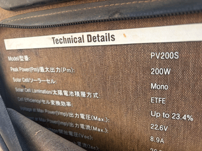

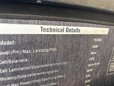

The panels say they are 200D and 200S but both the panels were supposed to be 200Ws

Bluetti-newer-panel
Bluetti_older_panel
