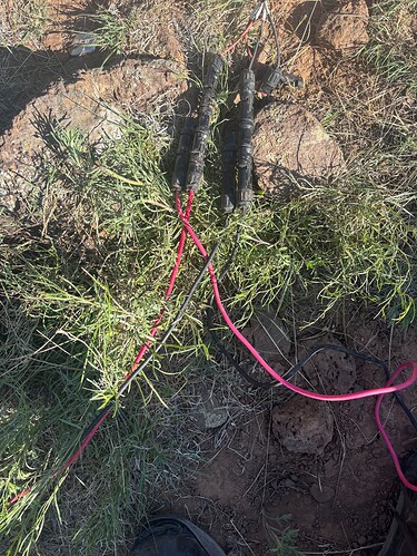

Hi @Cort, Could you please tell us the specific model and specifications of your solar panel, especially the open-circuit voltage?
Additionally, we would like to know how you connected the two solar panels – in parallel or in series?
Has adjusting the angle of the solar panels helped? If possible, please film a video of the solar charging process, upload it to a cloud drive, and share the link with us. This will help us identify the cause of the issue.

There are many factors that can influence the power output. It would be interesting to know what one 200W can output to the AC200 and how you connect both of them.
A series connection without any shadows should deliever the “full power”. Depending on what AC200 you have, the current in a parallel setup could be a limiting factor.

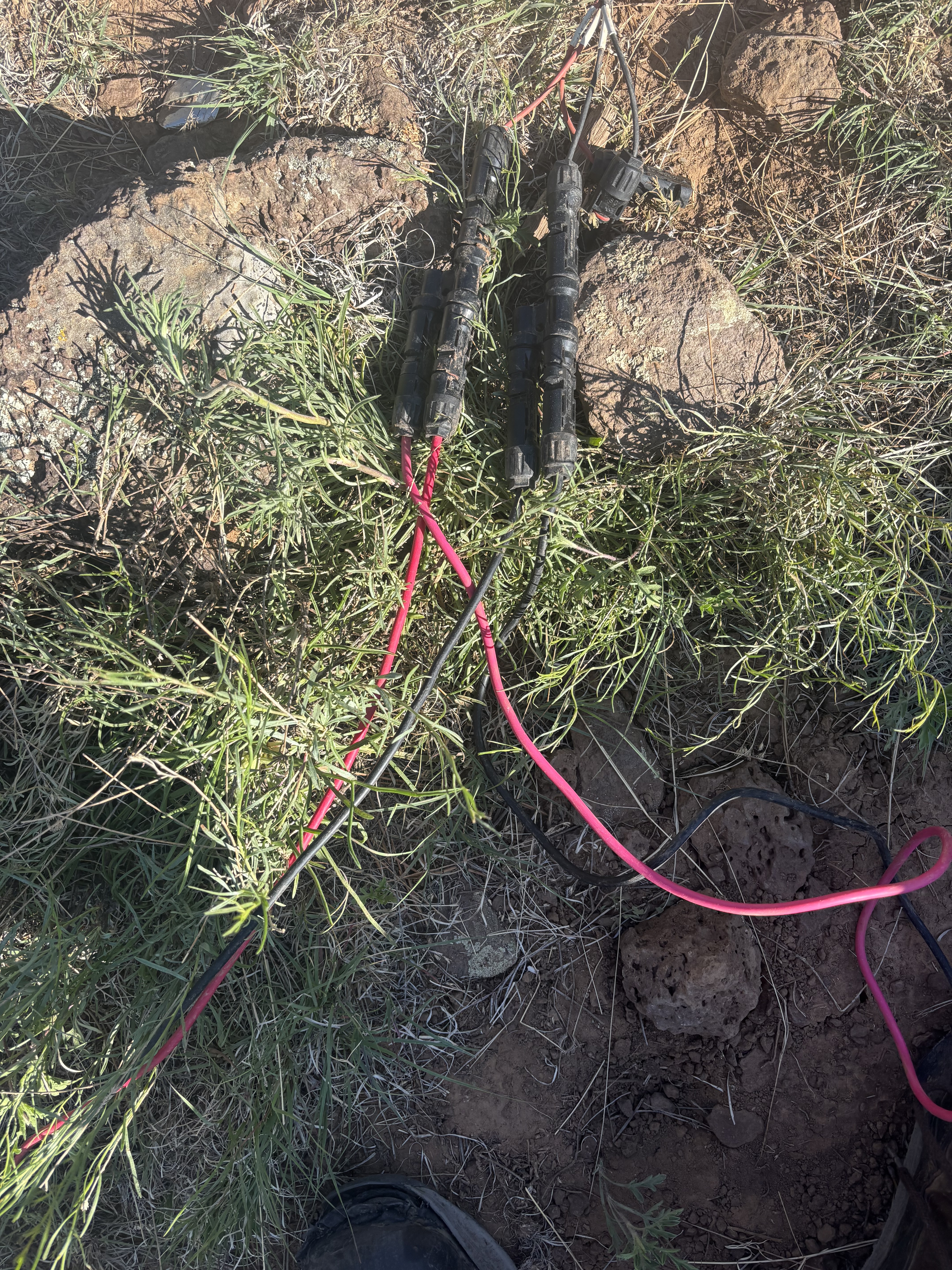

I believe they are in parallel (???) Here’s a picture showing the leads going to both panels
and a video

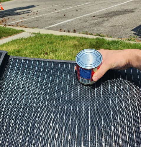

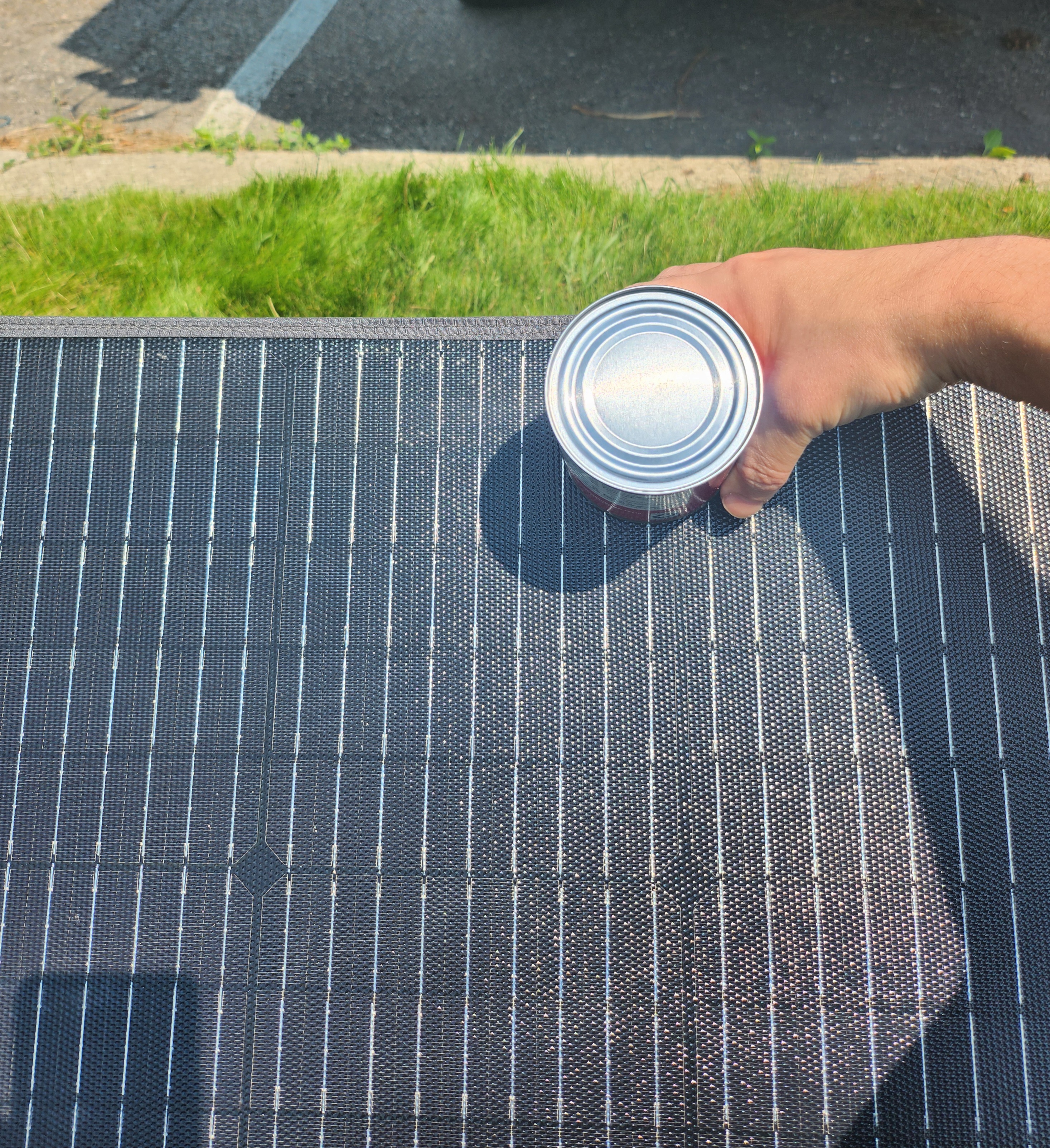

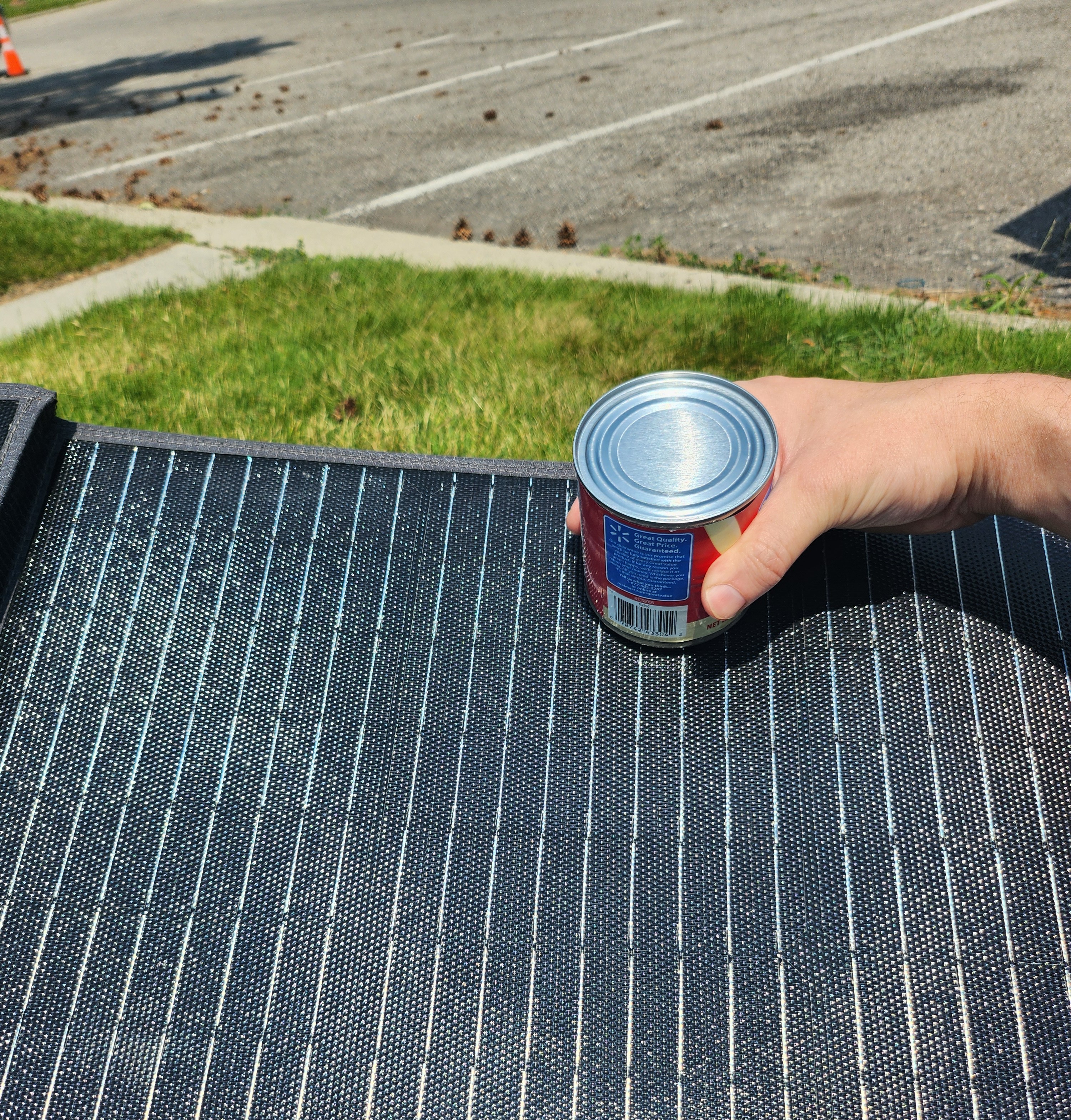

You can take a soup/food can and place it on the solar panel. The shadow underneath the can should be very minimal. if you see a shadow to the left or right, you are horizontally unaligned, you need to reposition either left or right to align toward the Sun. If you see a shadow below or above the can you need to adjust the tilt of your panel up and down.
PURPOSELY MISALIGNED PANEL
ALIGNED PANEL
Solar alignment trackers are dirt cheap on Amazon. I like them because I can adjust the perfect angle on the fly due to the fact I can leave the tracker attached to the panel. With the free can method you sort of have to adjust in micro increments, constantly testing and readjusting until the shadow is gone so for me its worth the $10 expense.

I do see that connecting the solar panels in series will boost the voltage up.
Did you disconnect and reconnect the PV/solar (From the powerstation end) after doing so or leave it plugged in the entire time after making the changes?
No I didn’t. I just unplugged it and it’s the same.
I connected them in series - Apparently, I need to hit 35 V. AI says that connecting 2 200-volt panels together in series should get them to 35-40 volts, and it;s getting 33-34 volts!
