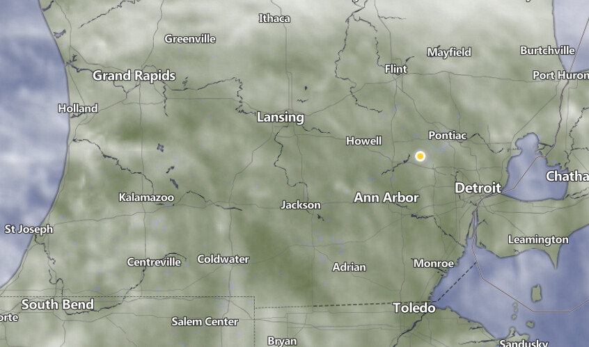

Yeah that is clearly not right. I have the original PV200 plugged into my Bluetti power station that only outputs 8A max and its still getting over 100 watts right now where I’m at with some cloud cover AND I’m 10 degrees higher in latitude than you are. There have been several complaints about the newer series panels not performing to expectations. Myself included. I have the newer PV350 and its performance is not up to par. Had it replaced. Same exact performance. @BLUETTI_CARE Please forward our concern to your internal quality control team to look at the performance of your new folding solar panels. They do not appear to be up to par with previous generations.
