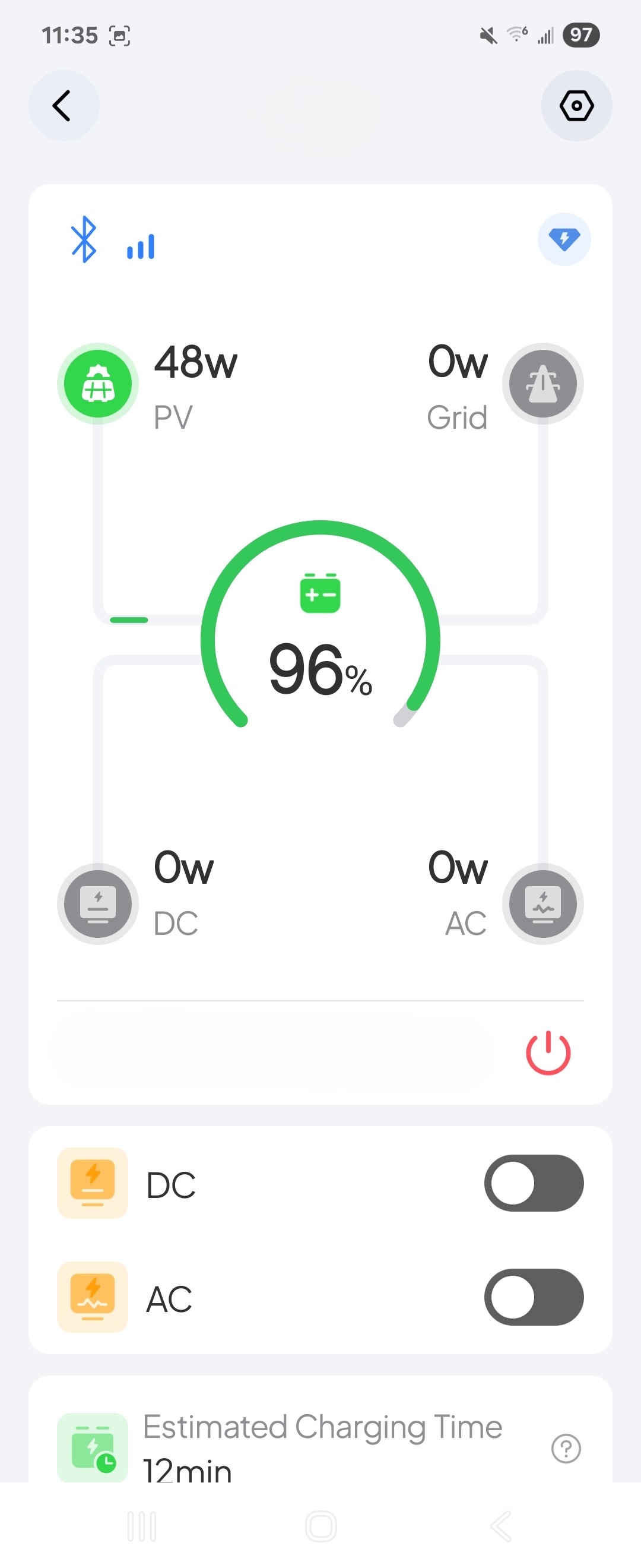

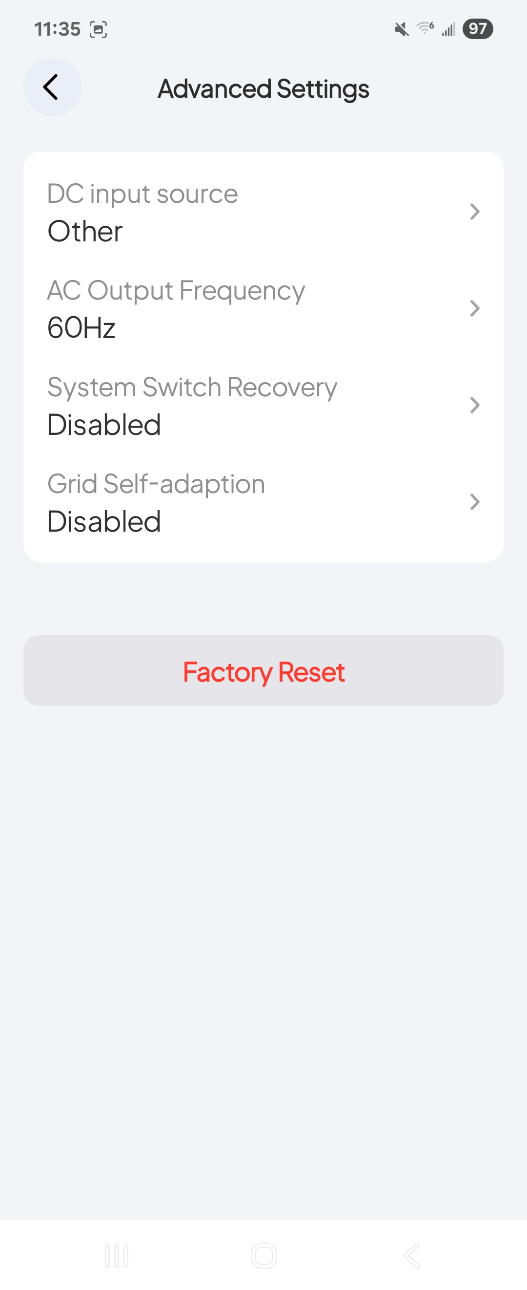

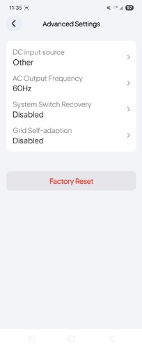

I recently acquired a newer Bluetti power station that has “PV Pro” setting available in advanced setting. I noticed that if you set the DC input source set to “Other” it capped the power station around 50W using my PV200 (Gen 1). If I switched the DC input source back to “PV” I got around 135 watts with PV Pro enabled. Likely not your problem just sharing for others. The 50W limitation can be user induced though as I’ve demonstrated. Hopefully Bluetti reviews our concerns and addresses the concern. As one of your panels is still under warranty, you have a valid case for a replacement. I completely agree with the design flaw of the new panels. They are WAY too awkward to prop up. I feel like it is going to collapse on itself and the panel will get damaged easily.
