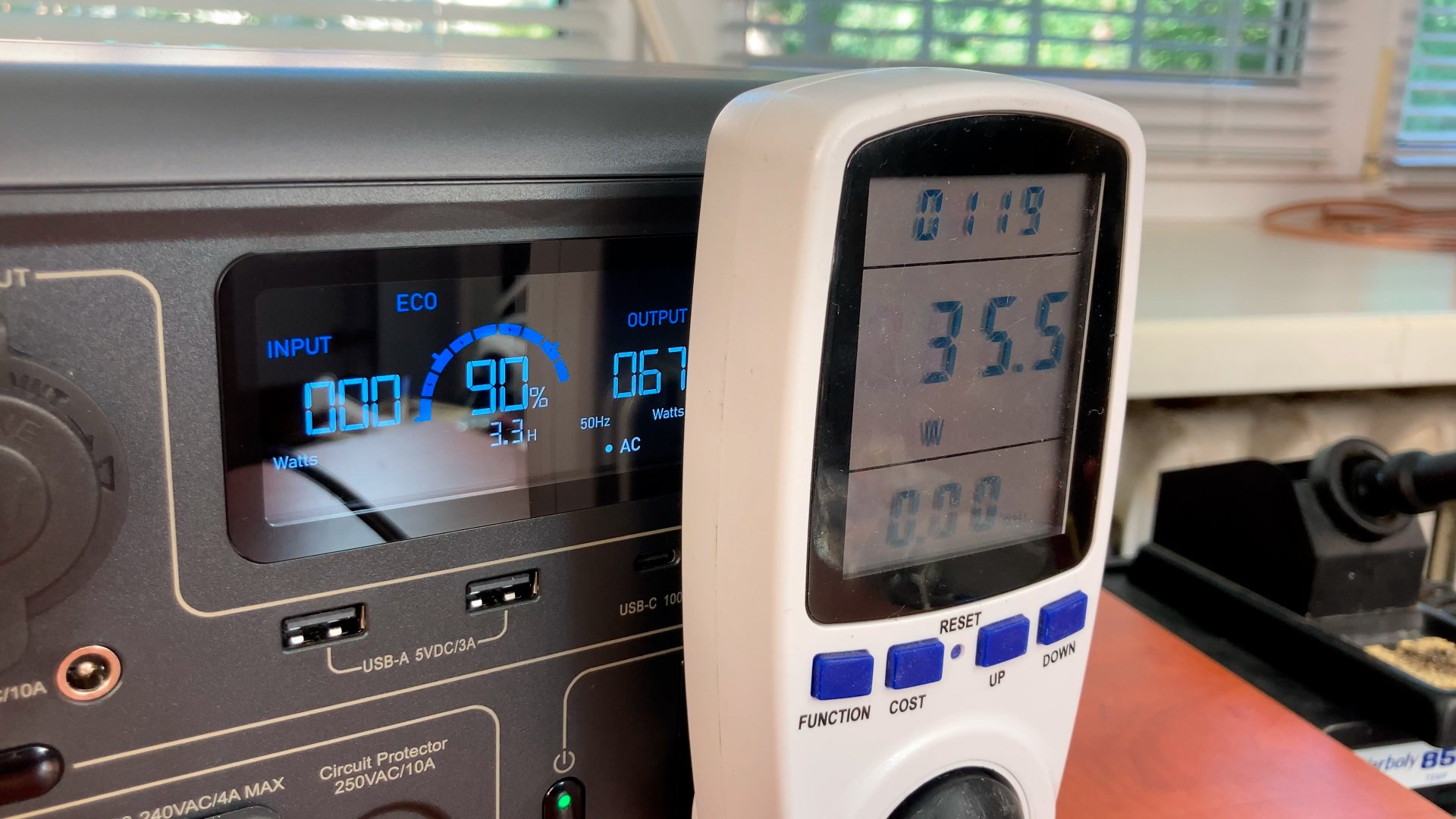

Connected a laptop to BLUETTI EB3A shows consumption of 67W, and the wattmeter is 35.5W, why is there such a difference in readings? https://zvukaudio.com/download/file.php?id=7168&mode=view
@Alexxx EB3A displays the apparent power, so there will be difference between measure of the wattmeter.
Does it show inverter consumption plus load?
@Alexxx No exactly. Apparent power is often expressed in volt-amperes (VA) since it is the product of RMS voltage and RMS current.
When I connect a 220 volt incandescent bulb, the station shows consumption as well as a watt meter.
When connecting devices with switching power supplies, the difference in consumption is almost two times.
