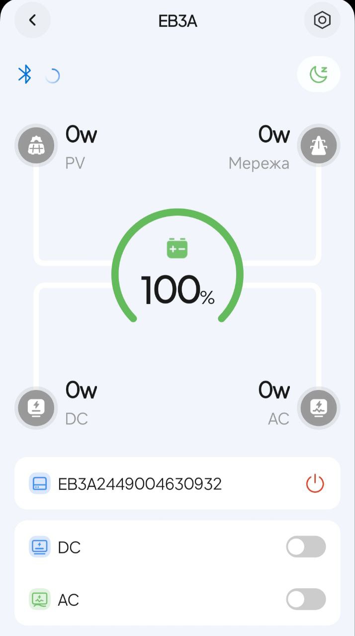

Hello @BLUETTI_CARE, I am from Ukraine.
Station no charge, 180V-190V in the grid.
Can you help me with the problem pls?
EB3A22449004630932

Hi @yurikvv, thank you for contacting us.
Hello @BLUETTI_CARE, unfortunately, the new firmware did not arrive.
Hi @yurikvv, we have applied to push the update again.
If you still haven’t received it tomorrow, could you provide a screenshot of the SN code for your EB3A? We would like to confirm that the SN code is correct.
Hello @BLUETTI_CARE, The firmware did not arrive, here are the screenshots.
