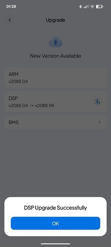

Greetings @BLUETTI

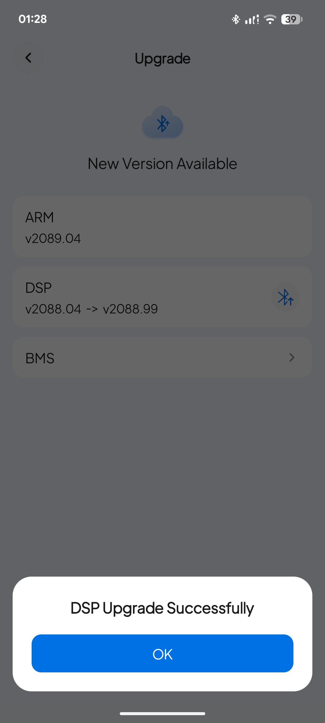

Thank you! Today I’ve received notification about new DSP update available. First 2088.03 → 2088.99 I uploaded the firmware successfully. Then I checked the app again and noticed the 2088.04 → 2088.99 update available, I also completed this update without errors (check screenshot below)
After the 2088.04->2088.99 update was done the notification about the available update does not disappear in the app even after I perdormed this update 2-3 times. The app still says the update is available.
I forced Bluetti app to stop and reopened it, it still says that DSP update is available, as before.
Is there a way to validate if DSP 2088.99 was in fact successfully flashed to my station?

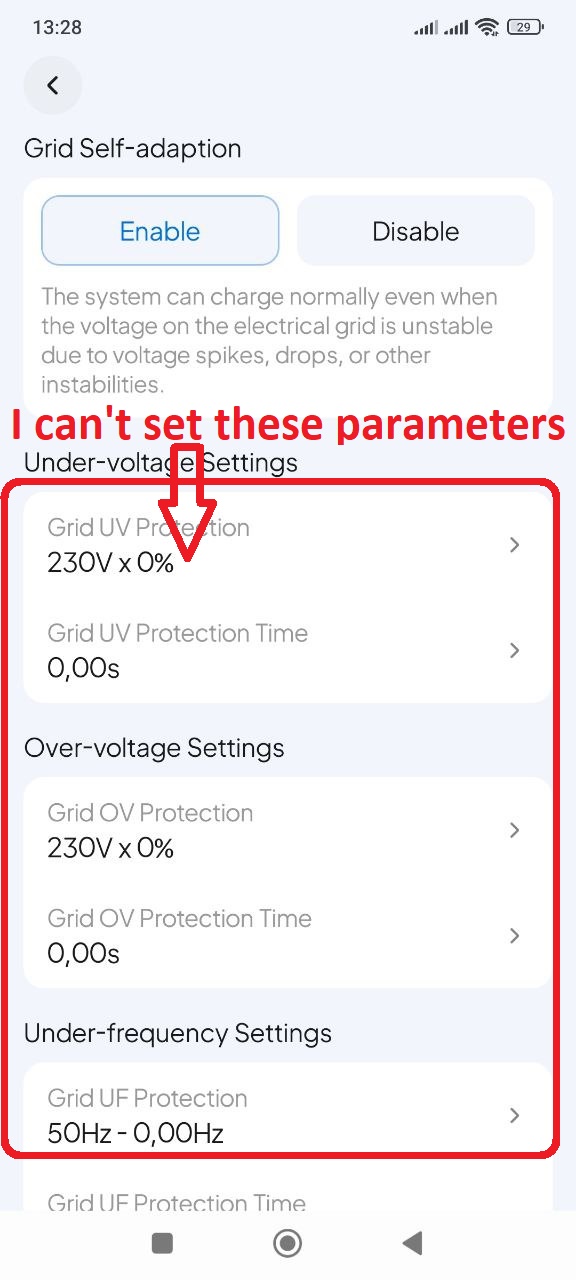

Hi @BLUETTI,
I have the same problem: E114 Grid Voltage Low
All updates installed. The app is also updated.
I filled out my information in the form on this forum.
AC200L
DSP v2130.13
AC200L2539110096729

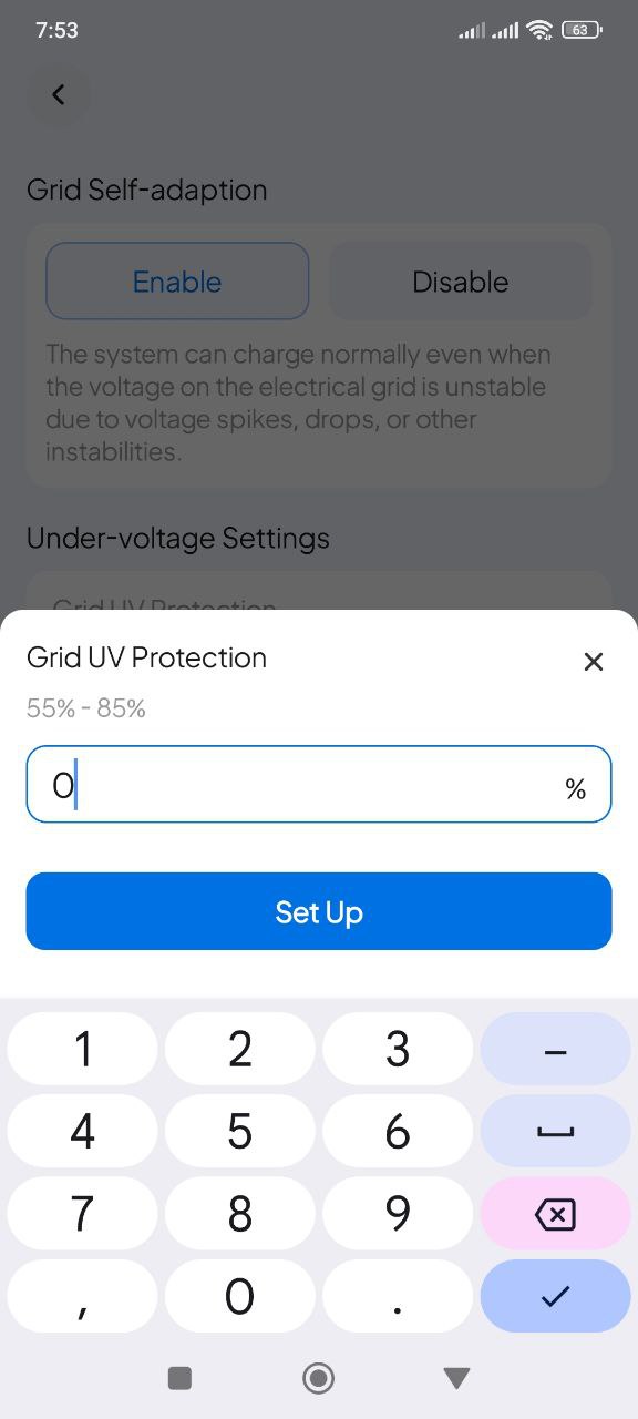

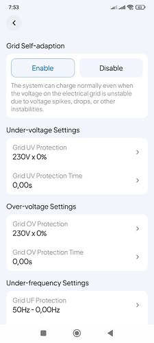

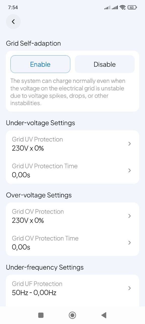

But why I can’t set the “Under-voltage Settings” parameters on “Advanced Settings”"Grid Self-adaption" page myself? These settings are not saved.
I have another AC200L and these settings work there.
Thank you!

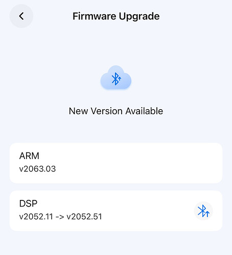

Hello, @BLUETTI @BLUETTI_CARE teams,

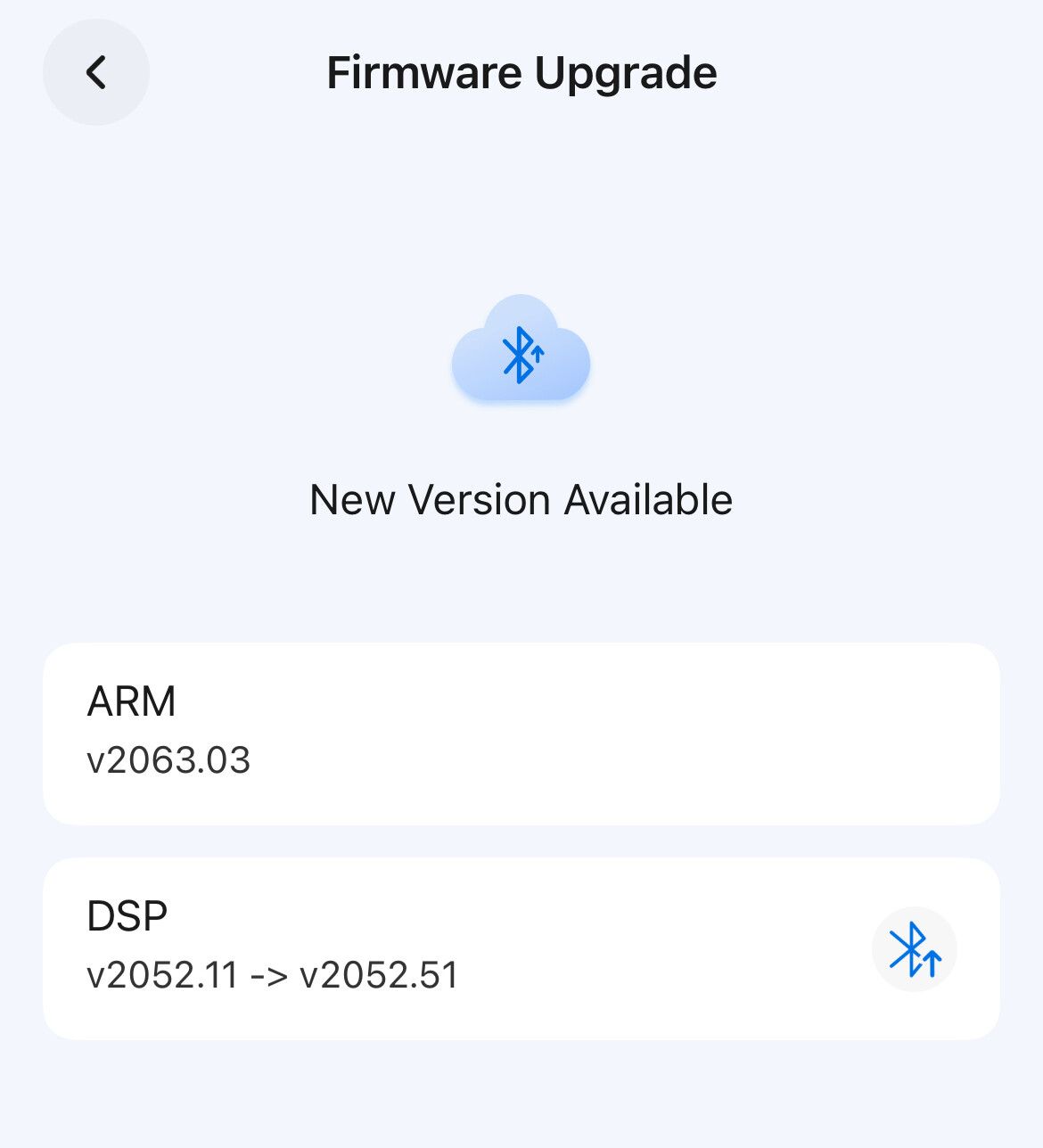

I see a new firmware version v2052.51 in the application.
However, I am not sure if this is the version that will solve the low voltage issue in my EB3A2246001962012 device. Or should I wait for another version?
I look forward to your reply.
Thank you.

Hello, this is a firmware upgrade for low-voltage power grids. You can upgrade.
Hello, did this issue only appear after you upgraded to DSP v2130.13? Was it possible to configure before?
Hello, is the low voltage error still being reported?
When I bought it, this version was already installed. No updates were installed by me, everything was up to date.

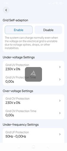

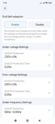

My actions:

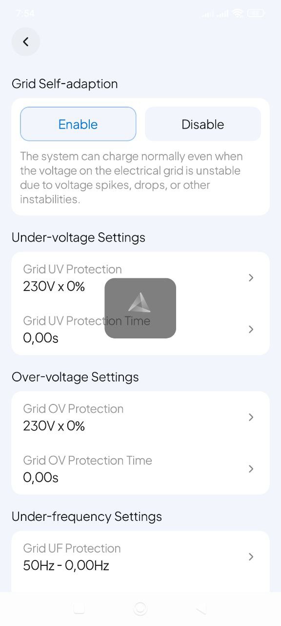

  1. Open “Settings”"Advanced Settings""Grid Self-adaptation"
  2. Tap on “Grid UV Protection”, open such page:
  3. Enter value, for example 80%
  4. Tap on button “Set Up”
    App thinking…
  5. But doesn’t save new value
Thank you!
