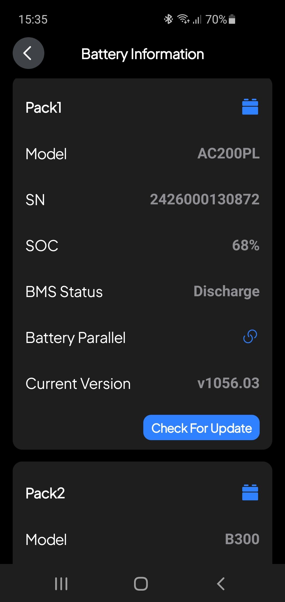

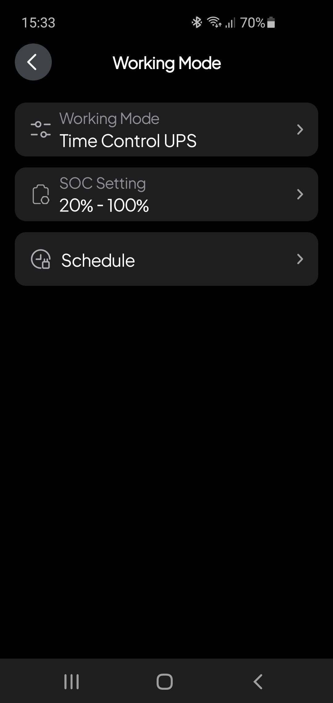

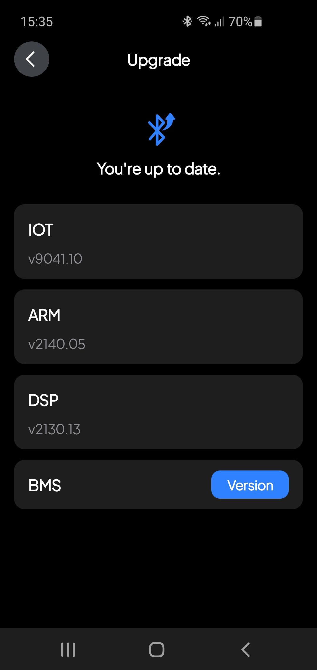

Hi @snmya, Regarding this issue, please provide a screenshot of your UPS settings interface, along with the SN code and current firmware version of the AC200PL. We will then investigate the matter.

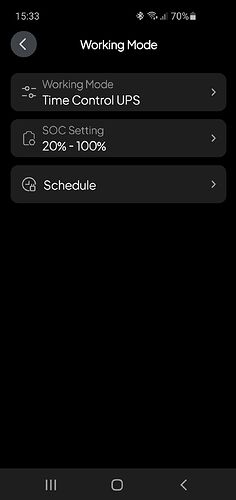

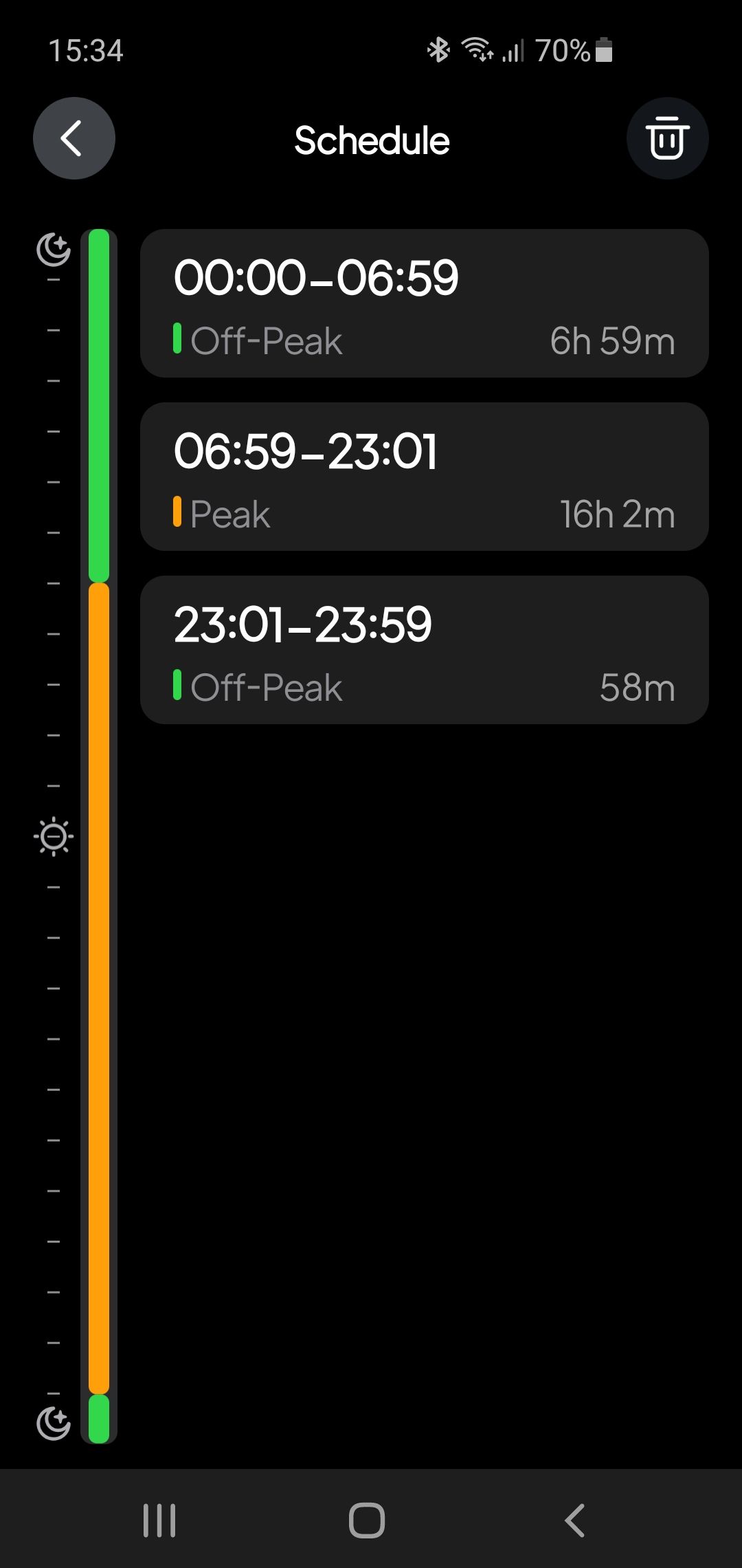

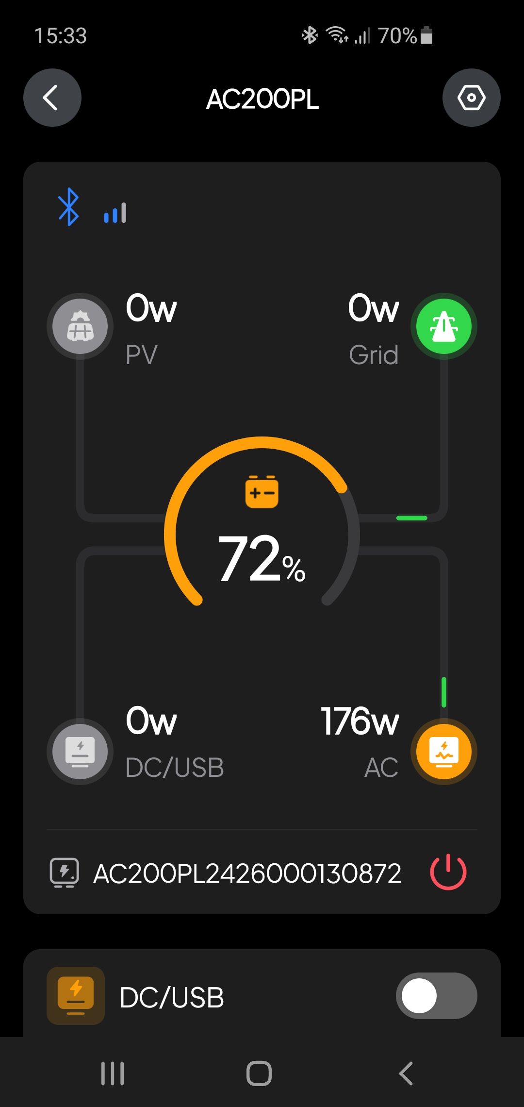

Here’s my screenshots. Right now, station is draining from the grid about 25-45W (depending on the AC load), measured by both wattmeter and the measurement device from the electric company. And this drain is constant, just fluctuates in 20-90W range.
Hi @snmya, Thank you for providing the screenshot. Based on the information shown, the UPS is functioning normally.
The 20W or so output you detected is due to the cable being connected to the AC200L — a small voltage causes this standby power loss, which is expected. Although no active charging is occurring, the grid remains in standby mode, ready to supply current and voltage at any time, which leads to a slight power draw.
If you’d like to avoid this minor power loss, you can simply unplug the cable.
@BLUETTI_CARE Well, it’s not 20W, it’s often upto 50W, which is 36kWh per month, not so negligible. Unplugin the cable is, of course, not a real solution
