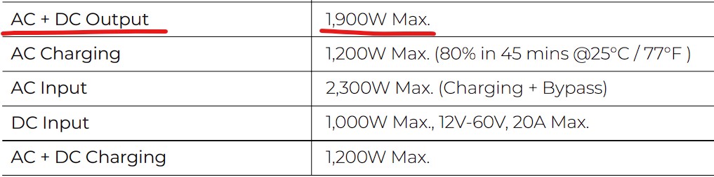

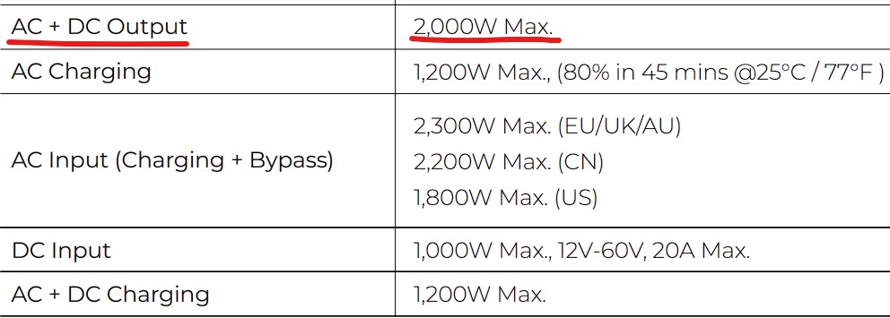

@rostifaner @BLUETTI_CARE This is the only change according to official manuals (besides appearance).

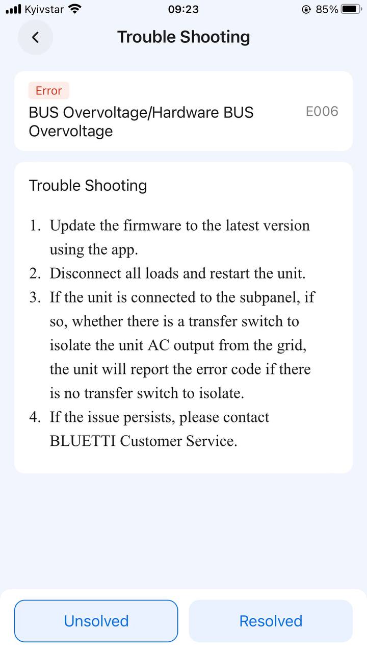

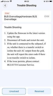

Second voltage fluctuation — E006 error
After I recovered the station and updated the firmware I continued to use it as UPS. Another voltage fluctuation occurred on the following days. This time I managed to screenshot the error in the Bluetti iPhone app (screenshot attached below):
E006 — BUS Overvoltage / Hardware BUS Overvoltage
I turned off the station and used rapid clicking trick to power it on and it continued to operate normally. However, I don’t remember how I turned off the station then - through the app or via button. After this case I stopped using the station in UPS mode.

Hi @VSM, thank you for the update and additional information.
Indeed, the performance of these two models is basically the same. The only difference is that the Premium 100 V2 has a 100W higher maximum DC output.
