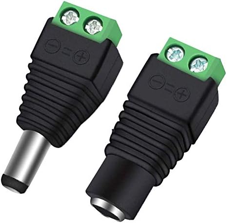

Hi Scott, I would like to power some 12 volt dc appliances from the output ports on the ac200, but need to source plugins at the ac200. Might you know what the size is 5.5 , 2.5 mm. I see I can source various plugins online, but not sure of the plug-in sizes. I see a 25 amp plugin and also 3amp. Thanks for the reply.
I believe the smaller 3 amp dc output sockets are 5.5mm x 5.21mm which are fairly common on amazon.
Regarding the 25 amp output plug, it is a WEIPU SA20 2-pin aviation plug. Below is a post where a user made his own plug / cable.
Also, the 5.5mm x 5.21mm I used can be found here -
