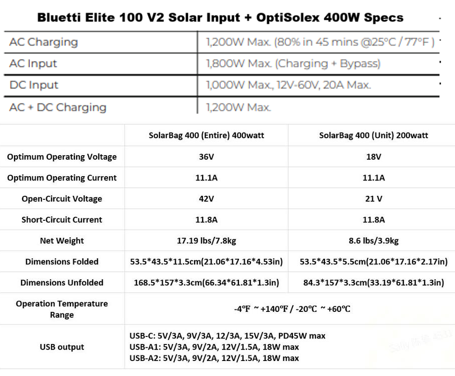

I am anxiously awaiting my units so I can try them out with my new 400W OptiSolex solar blankets. They are N-type 16BB, and with the E1V2 solar input parameters, I can wire two in parallel.
